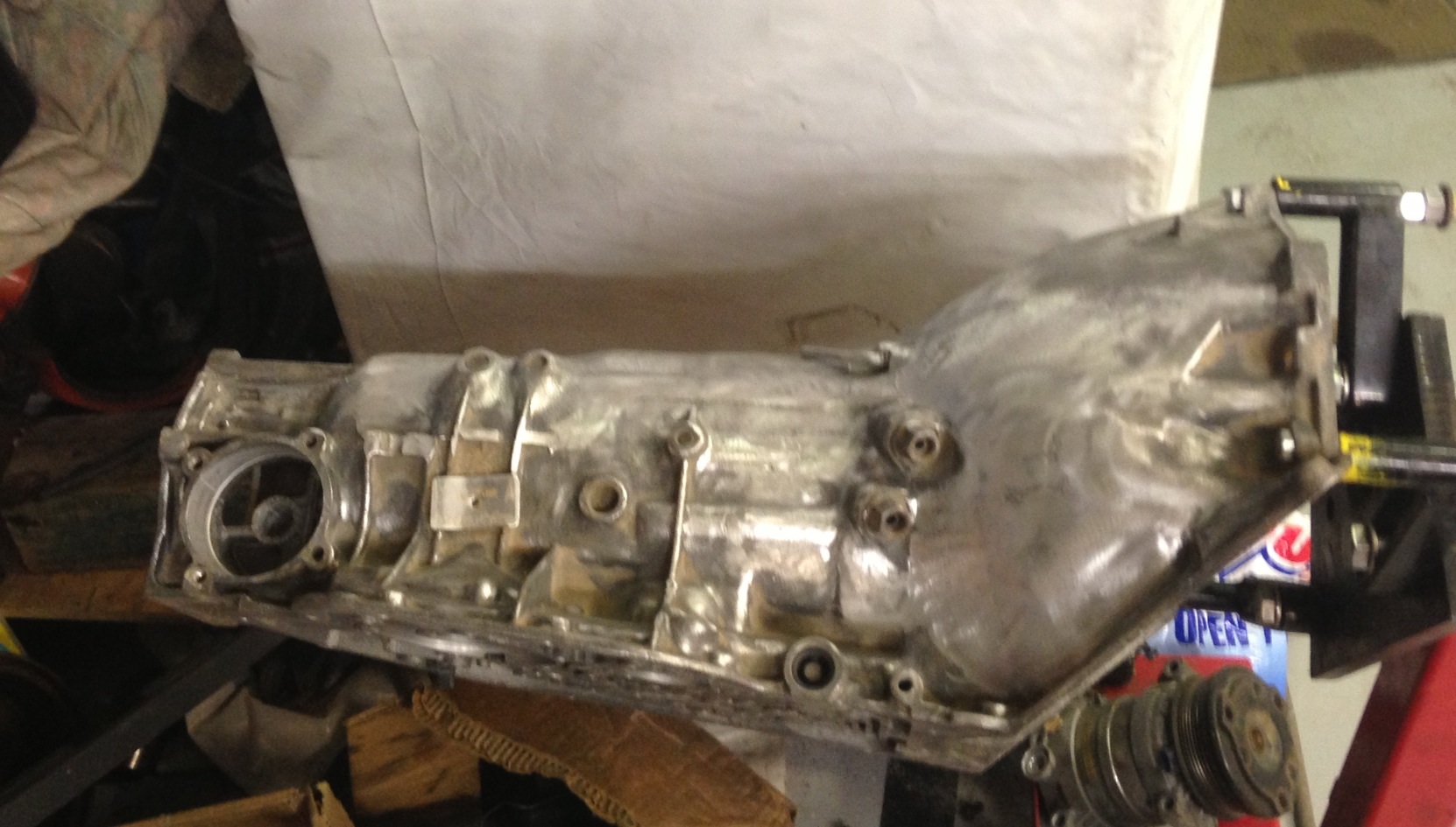

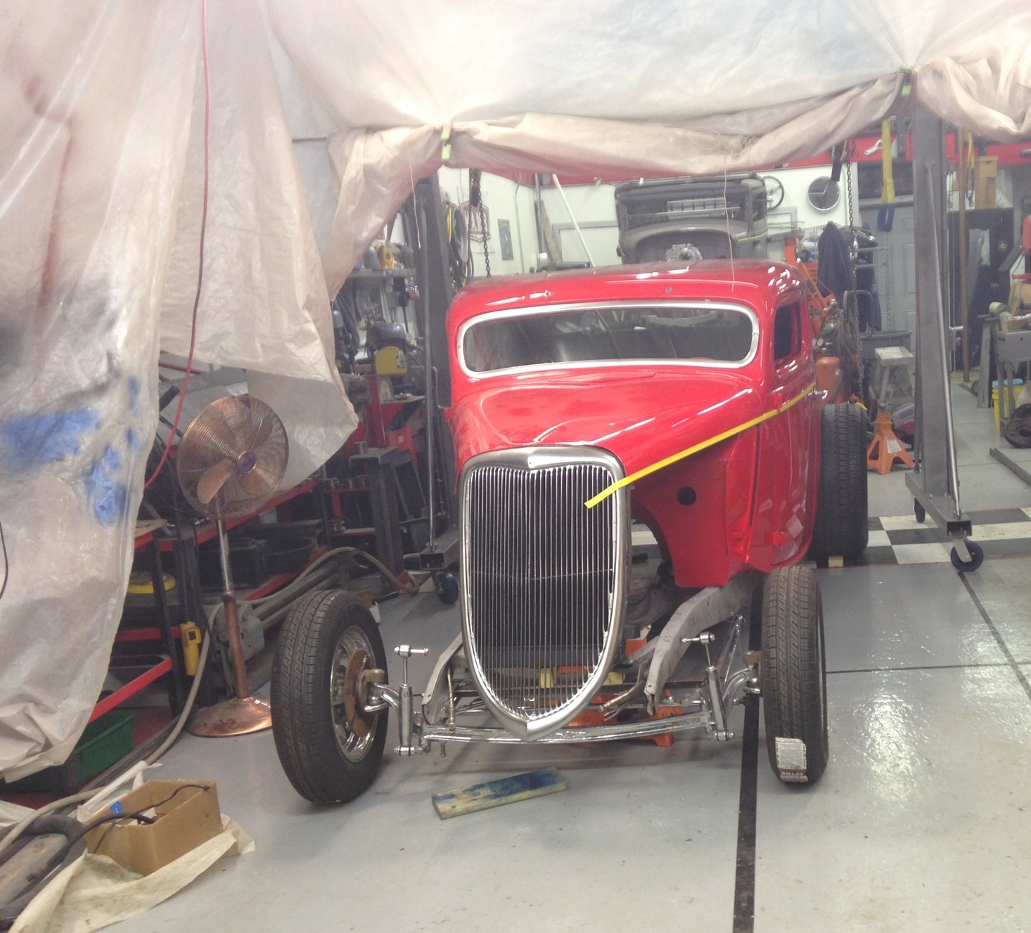

  1. image.jpg Hold my beer and watch this...

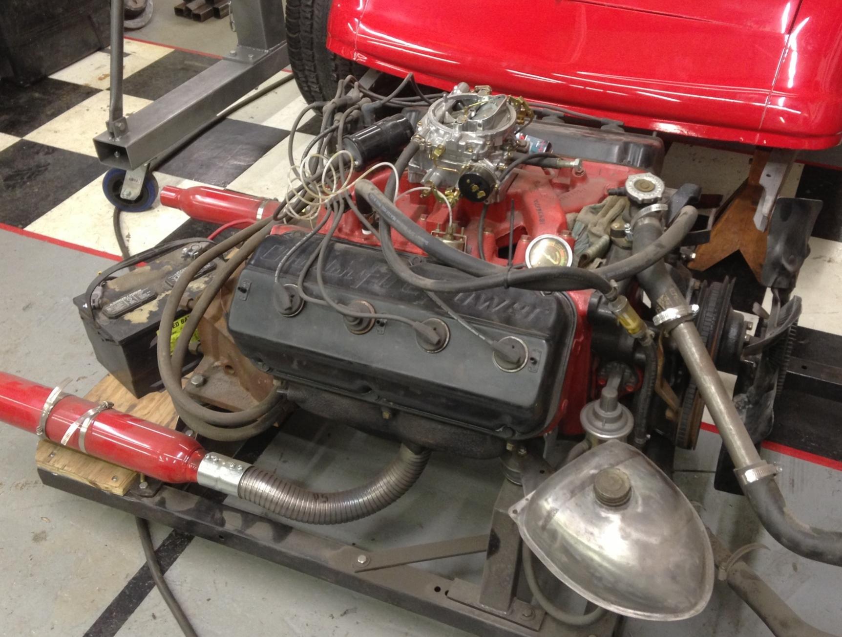

    Engine is under the bench behind the fan
    Pistons are for the project after this one so pay them no mind.

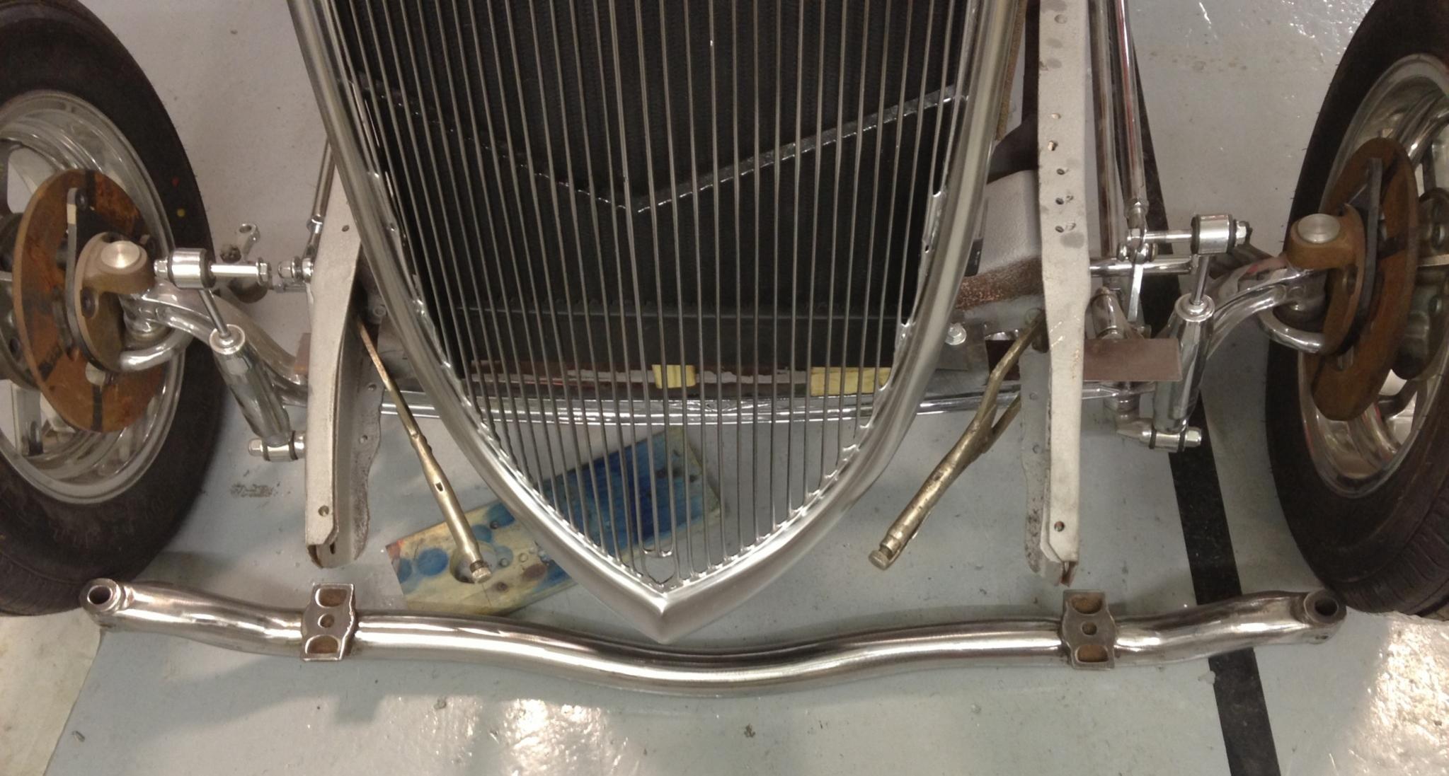

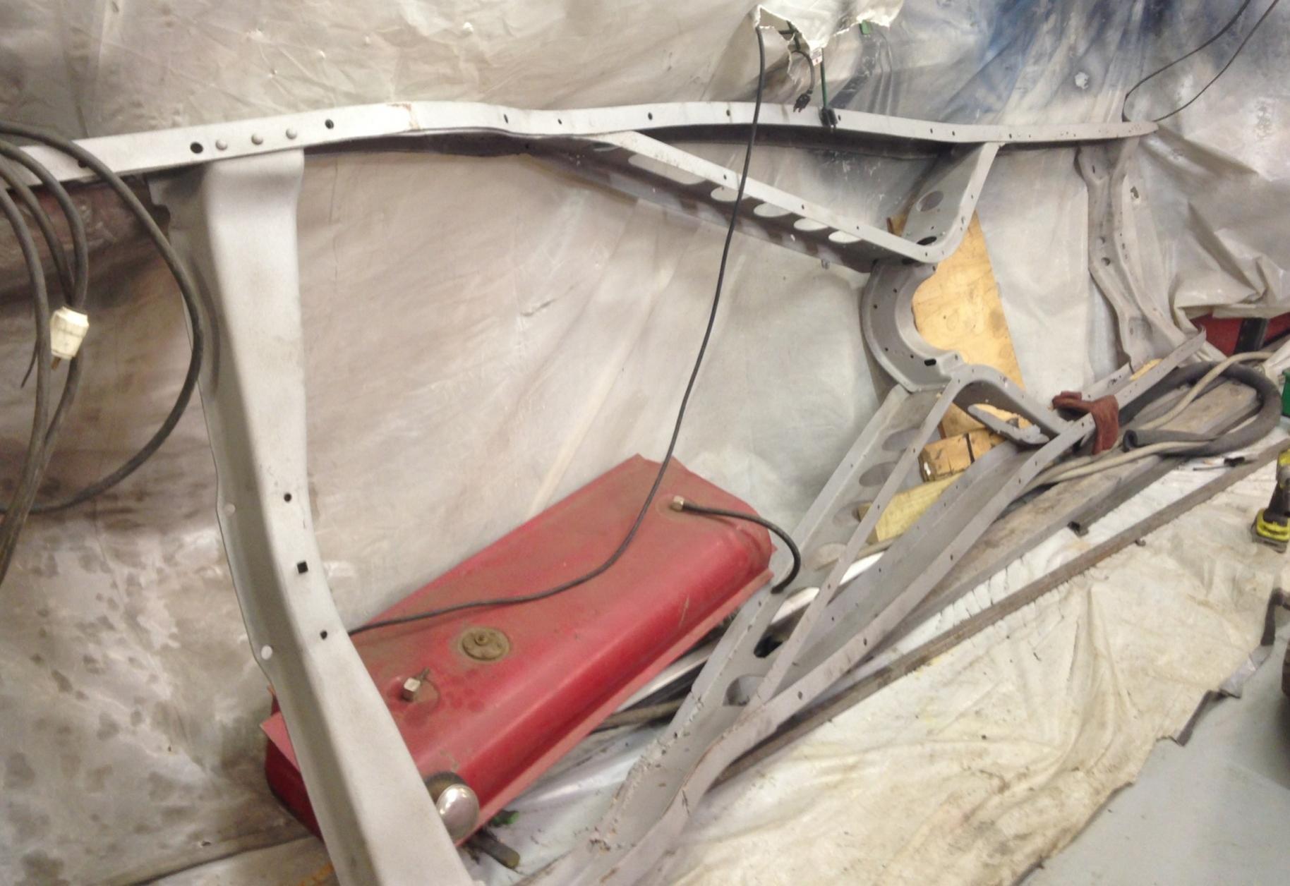

  7. Different chassis-
    Start with an original frame fresh from the blaster.

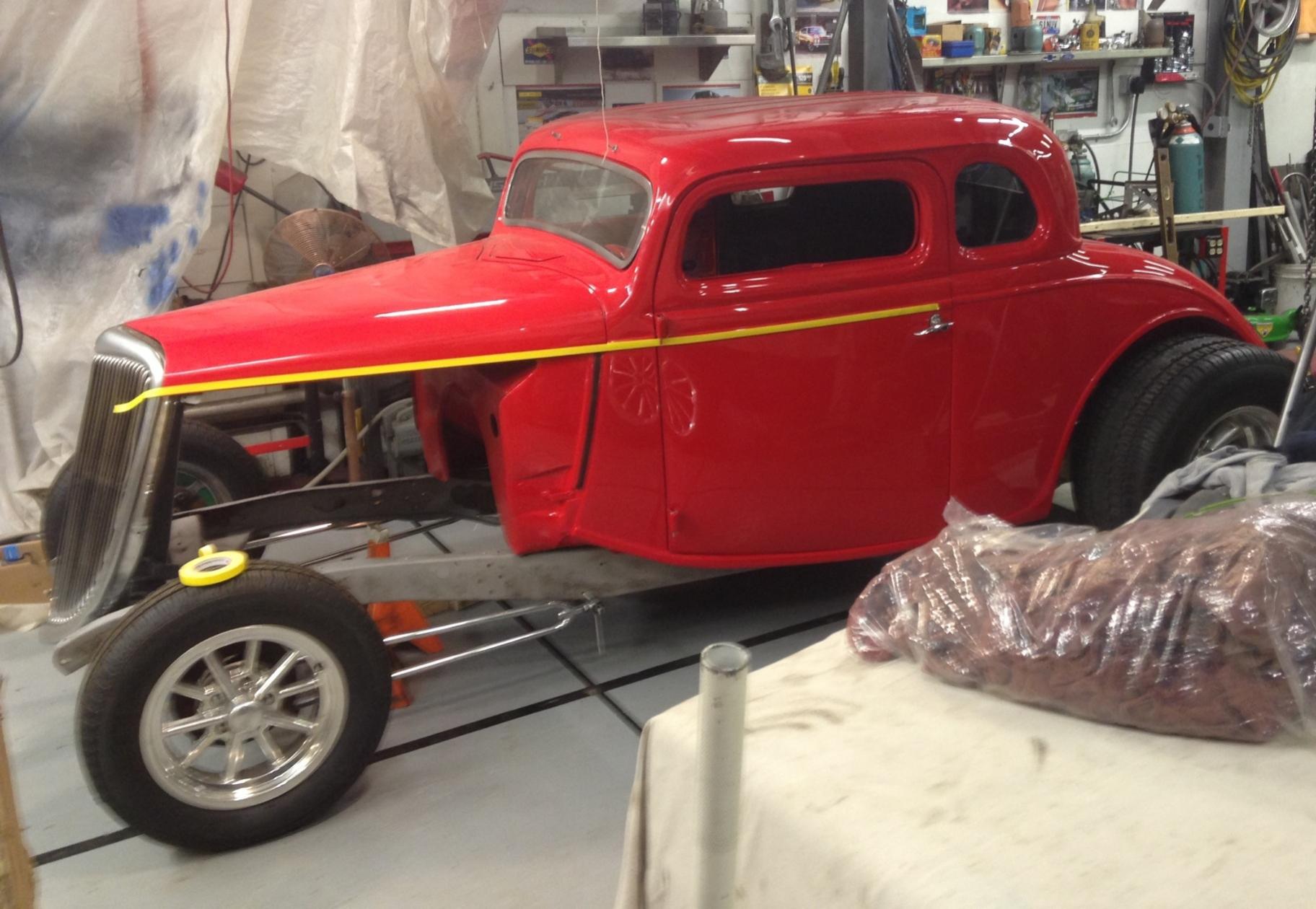

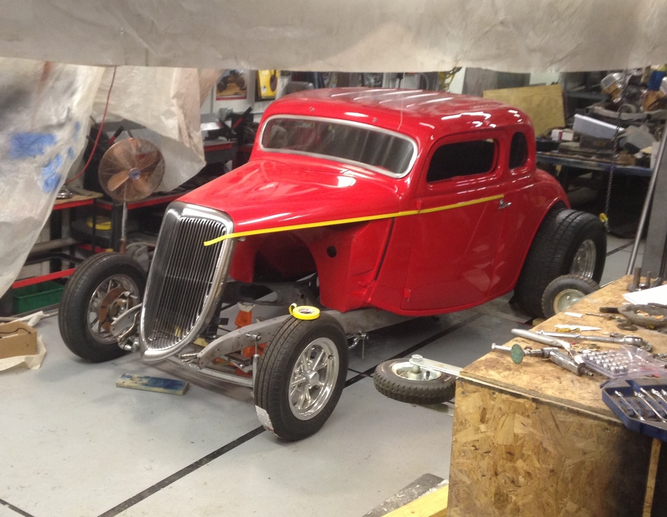

  8. Measuring to see how that hemi will fit in here.
    Surgery required

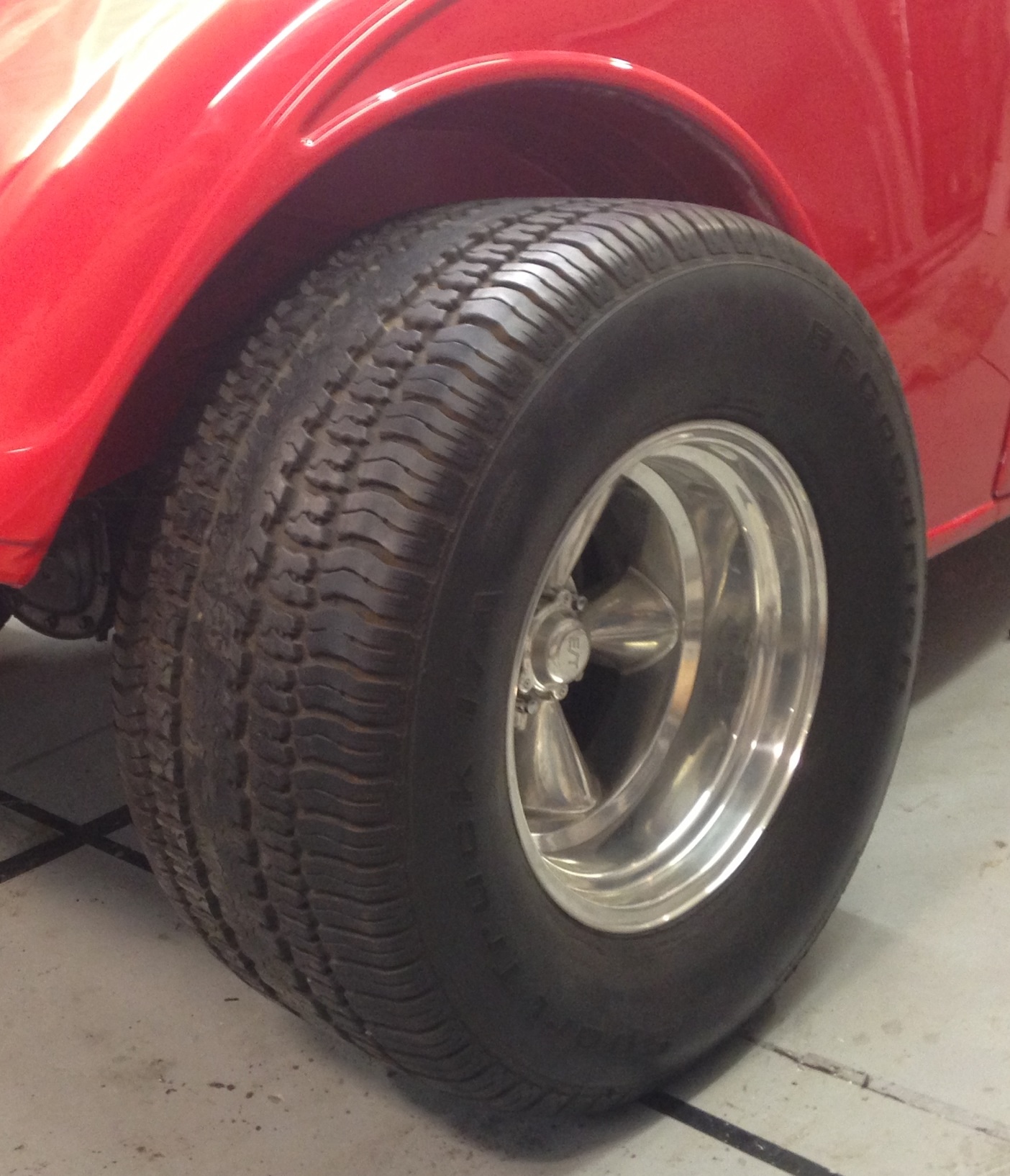

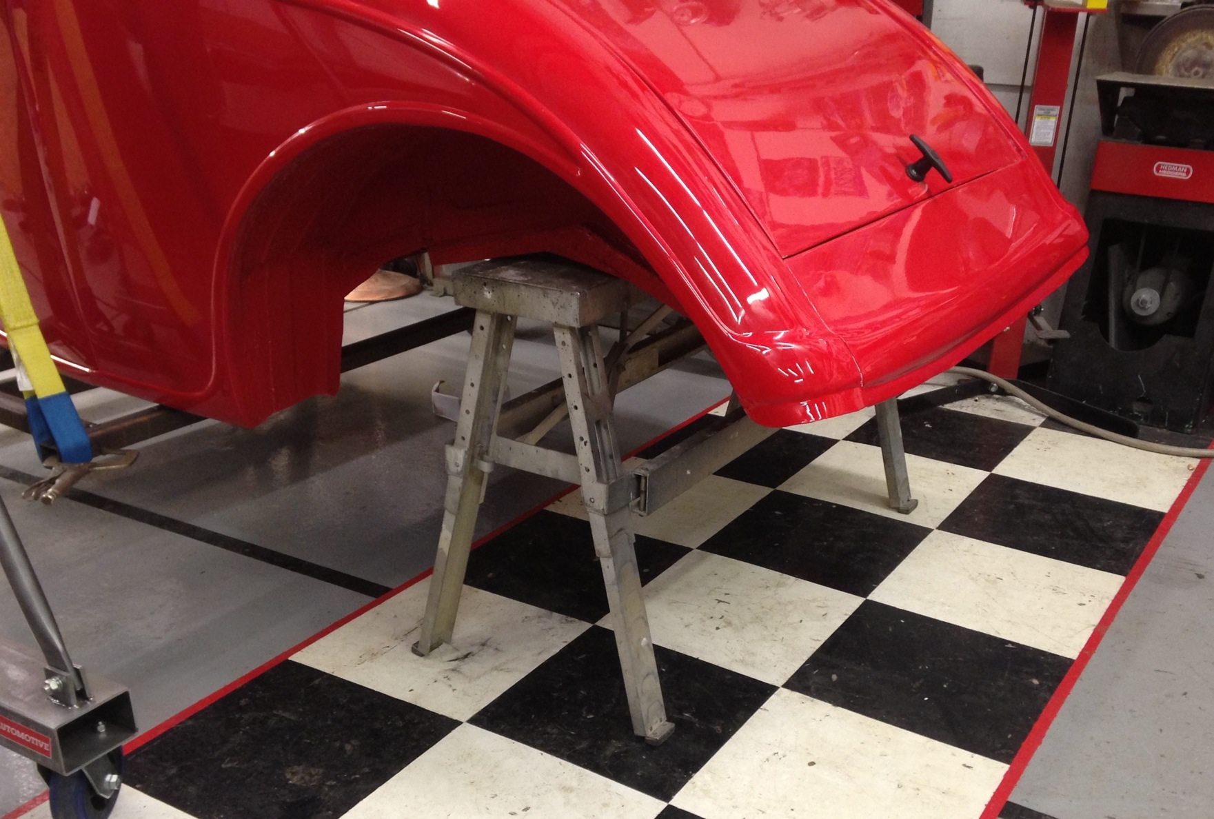

  10. image.jpg Ill be keeping this rear end , so I had to re drill the axles ( thanks rottenlenard) to mount these 16x11 ETs with 345 tires ( thanks weasel).
    I just had to stare at it for a while.

  14. Them ETs looked a lot better than the sawhorse!

  20. I'm thinking maybe a dodge double dip axle i have here with a 32 crossmember.
    Maybe spring behind or move the crossmember forward.
    Oh and all this jockeying around gave me more room for the hemi, maybe just a dizzy tunnel will be needed.

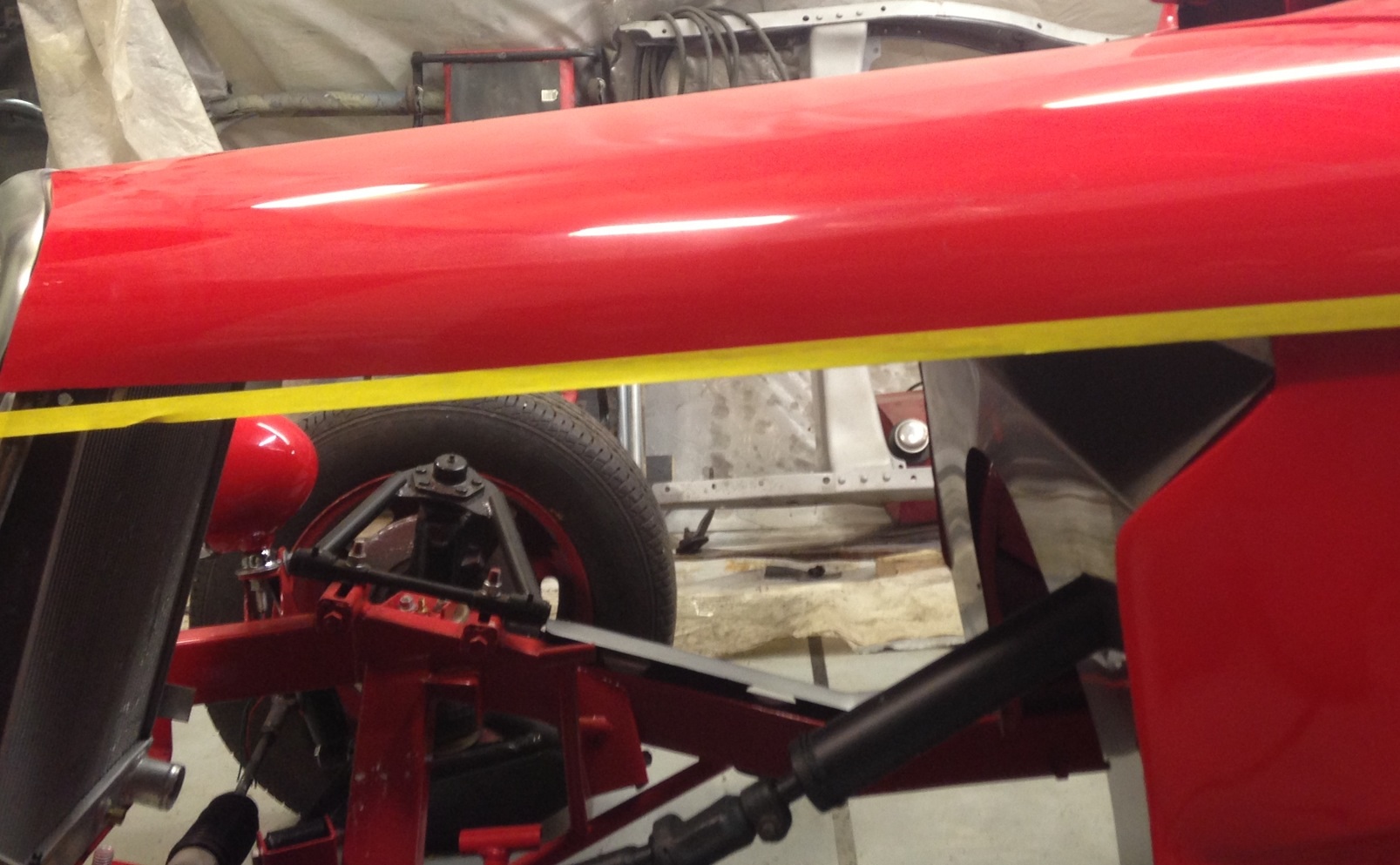

  21. image.jpg I had to swap the chassis, realign the grill body lines, channel the ass end 2", stand the grill back to the correct angle, but now I need a new hood because that one was custom made to accommodate the goofy stuff.

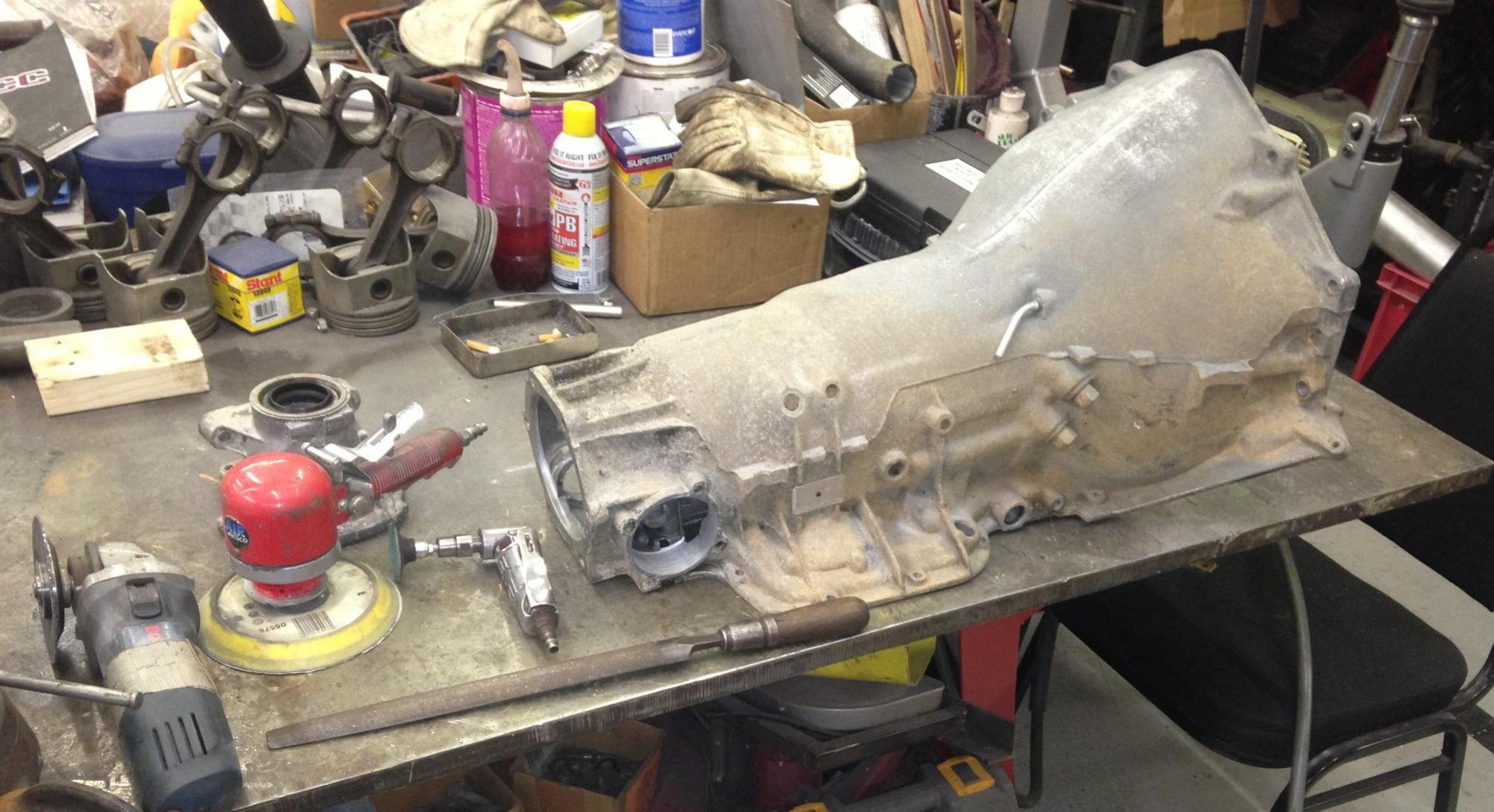

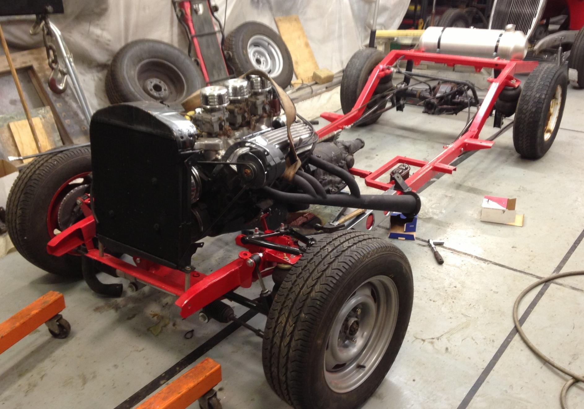

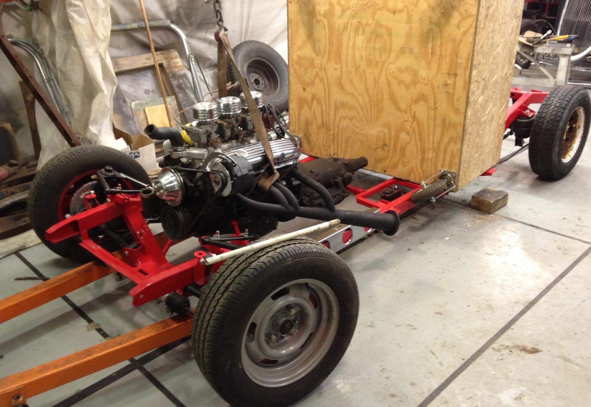

  28. Got the engine and Trans out of Priscilla and onto Elvis's former chassis.
    Sweet little 350/350 combo. Tomorrow we will get the radiator, fuel, tank, battery on this chassis get her started and put it up for sale as a nearly complete ready for a body running platform.
    Maybe ill hunt a body for it too while I'm waiting for a buyer.
