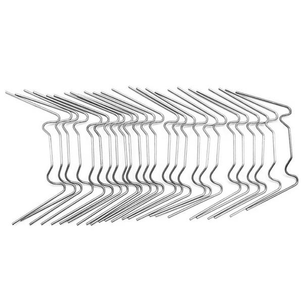

  7. May seem strange but google greenhouse glazing clips. They fit lots of old headlights:eek:. I,ve used them for donkeys ages but never figured out how they work for a greenhouse :confused::p

    Fortunately I have one light that is assembled. I have a large glass shop in a nearby town, I might try them? So-Cal no longer manufactures the lights.

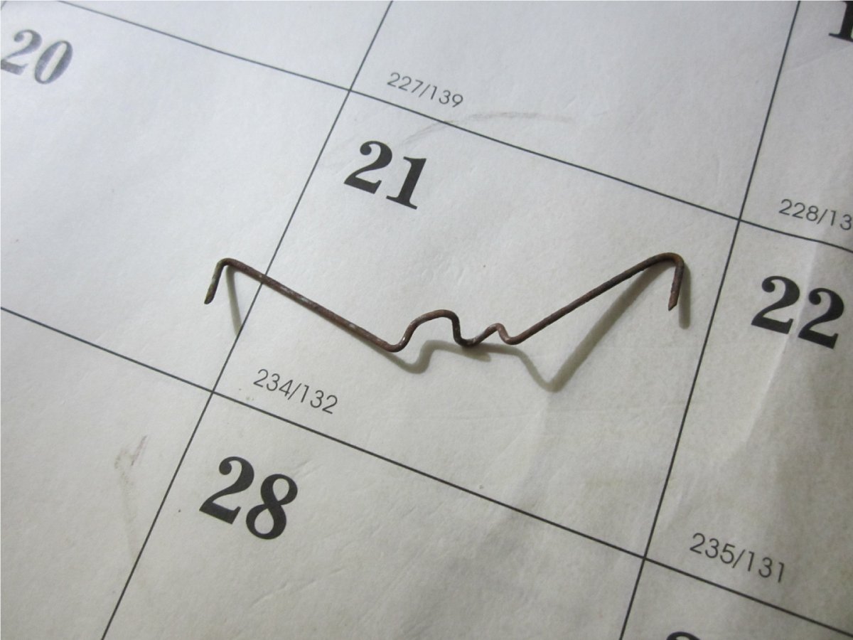

  11. I have some clips from a guide spot light, can you post some pics of the clips with measurements.
    continentaljohn and Stogy like this.
  12. This photo is from the link above.

    A search shows that Seadog did a thread asking about the clips that shows the clips. They look like what Pprather showed.
    https://www.jalopyjournal.com/forum/threads/arrow-775h-headlight-help.1020903/
    THIS LINK IS TO SHOW WHAT THE CLIPS LOOK LIKE not for guys to answer a 4 year old dead thread.

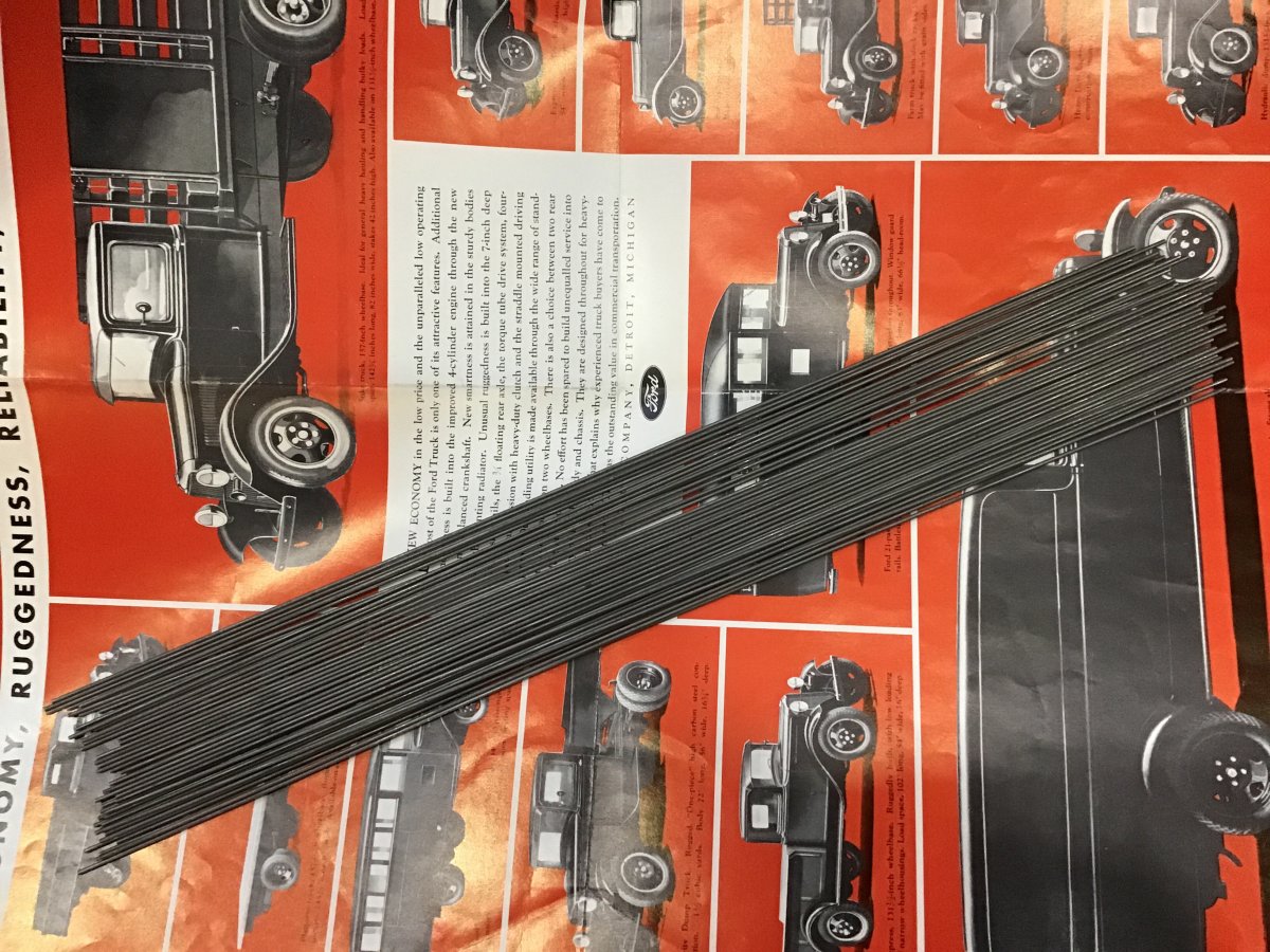

    I have a few sets of the arrows and will take one apart. Yes music wire is the materials to use but we made them out of 17-7 stainless. It’s a spring steel but higher corrosion resistance we also would straighten the wire to get positioned as coiled wire had a mind of its own. These are .062 SS rods for wire forms and in this case antennas for Police and fire vehicles . Gary I can send you a rod if we dont find the clips. image.jpg

  24. .........Let us know as mine are a little rusty.

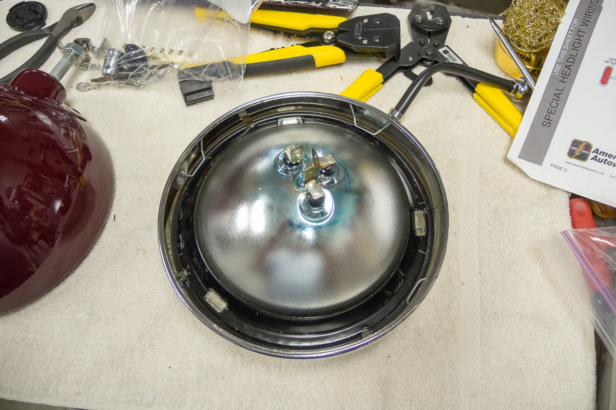

  30. I can take my lights apart & get exact measurements of the clips and post here if you want to try to bend up some.
