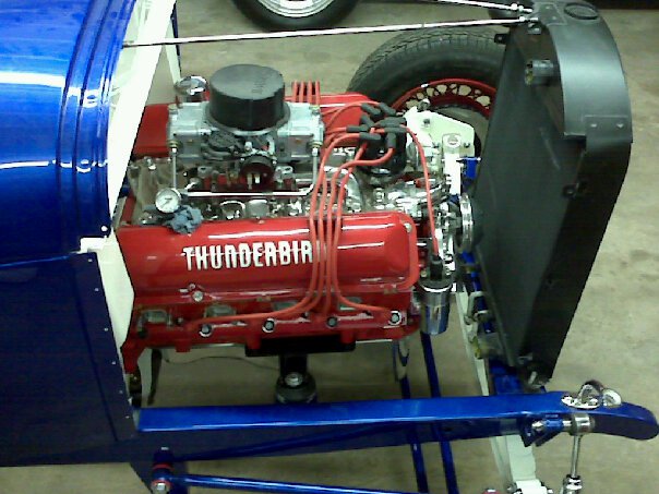

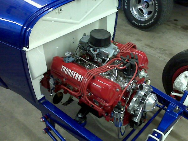

    old thread , didn't even realize bob the guy who started this and i are friends since this was posted , heres a few pics of mine

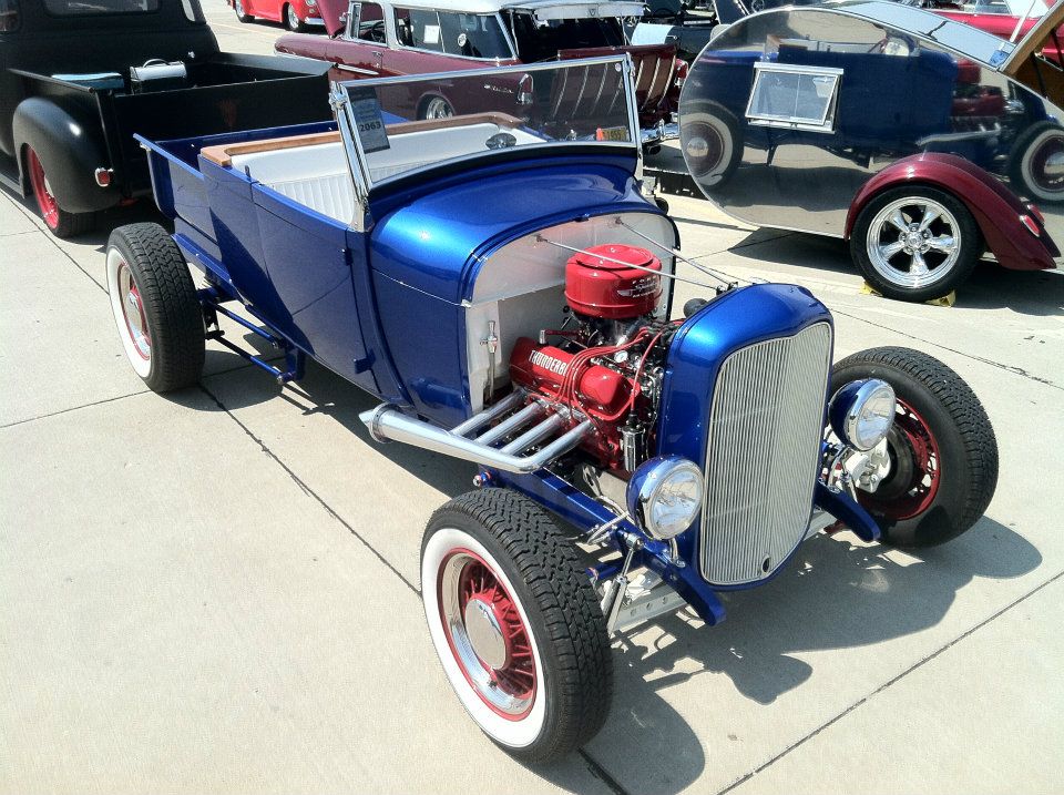

    Just sold this '29 RPU, here's where it was going. Lincoln 302/C4, 4" recessed firewall, P&J's engine mounts and removable tubular tranny mount. Easy Peasy.
  30. Hey D-bag, can't tell what you are doing for a fan?
    Water pump?
    Thanks. What ever happened with the FE valve cover adapters?
