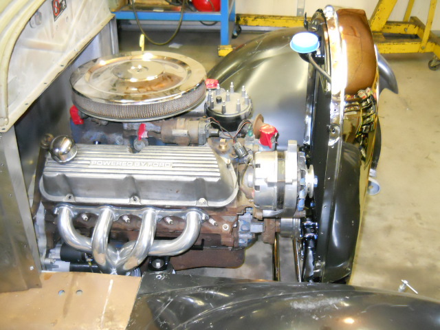

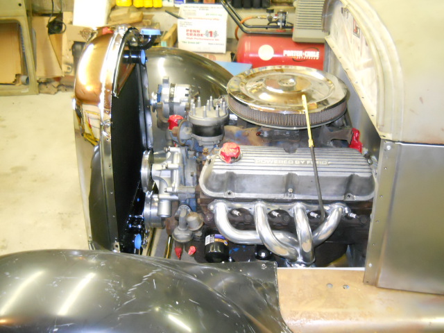

    mine..302 -C4....

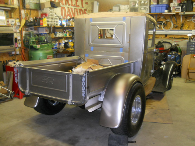

  27. 27 Tall T
    Joined: Dec 16, 2005
    Posts: 327
    27 Tall T
    from Butler Pa.
    302 in 29 closed cab pickup
