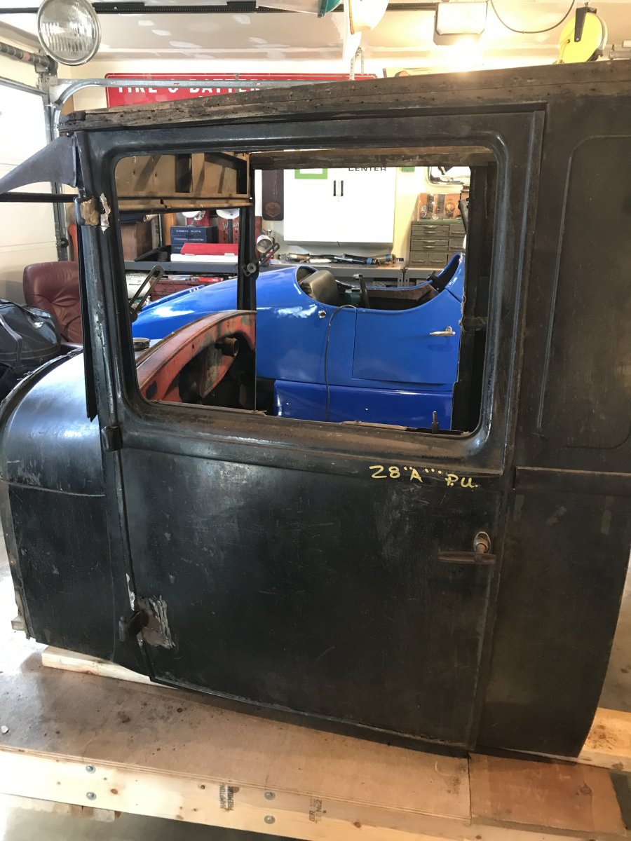

    Here’s a look at the hinge issues I was talking about. Wish I’d taken better pictures as I went, but you know how it is when you’re focused on something.
    For this close up, I’ll start with my “good side”—i.e. the driver’s door. Note the rot lower-right; that's the only rust-through anywhere.
    This is my driver’s door middle hinge. I’m only showing this because it is something to savor: The one and only good hinge on the cab.
    Here’s the top hinge. Not too bad. Somebody brazed a mirror bracket to it with no regard for damage to the adjacent door skin (you can see the stub of it in that first pick). I’m sure the bracket served, which is all that mattered back in the day. This is how it looks after I cut and ground the crap off. Adjacent door skin needs work, obviously.
    Now the lower hinge. Somebody “fixed” this by welding 1/8” plate to the inner frame and outer skin. One plate was brazed and the other welded—done at different times?
    I’m guessing the inner plate bound the door up, because looks like someone bent the lower hinge trying to fix it. But all this did was stress the upper hinges, causing cracks in the A-pillar mount areas. Anyway, I cut the plates off, revealing underlying damage to the door skin (earlier fix attempt?).
    The lower inner door mounts was really loose due to extensive cracking, as you can see. I’m assuming this was the problem that the plates were intended to solve. I cleaned the metal, welded the cracks, and the mount points are solid now. Ugly, but you can’t see them.
    Re-mounted the door to have a look.
    Good so far. It opens, closes, latches. I’ll repair the skin next, which could be tough; dolly access is problematic. Also need to improve my metal shrinking skills, as they pumped a lot of heat into the door skin with all that gas welding. Shrinking metal is not a talent for me. I have a couple shrinking discs but have never gotten the hang of them. And when I use a gas torch to heat and quench, the results are spotty. Literally.
    But anyway, it’s progress.

    On to the right door, where there’s a whole lot of weirdness going on. This door's open-and-close operation was a floppy mess, with only 2 attachment points. The pictures tell the story.
    Top hinge, door and A-pillar:
    Yes, that is the wrong side of the hinge, welded to the door. And on the A-pillar side, somebody cut the hinge out entirely. Sigh.
    Middle hinge:
    Well, at least they welded the correct side of the hinge to the door. I guess that’s something. :confused: Again, they torched the A-pillar for access to the hinge nuts. But this time they kindly left some metal in place so they could remount the hinge… three or four different times, judging by the holes.
    Bottom hinge:
    This is… creative. o_O First, they welded the daylights out of it. Then, when that didn’t work, they cut the outer part of the hinge off, twisted it like a pretzel and bolted it to the door skin.
    All in all, I really can't complain. These flaws are what put the truck in my budget. But I couldn’t keep looking at this mess. I drilled/cut/ground it all off so I could contemplate a fresh slate.
    In the process of removal I destroyed 2 of the threaded mount holes in the middle section. Figured I’d weld, drill and tap. But closer inspection showed those mount holes are actually plugs that are pressed into the door. My neighbor had a better solution; we drilled out the plugs and he tig-welded fresh nuts into the hole.
    That’s as far as I could get with the door for now. Had to shift my attention to an unexpected little setback. More to come…

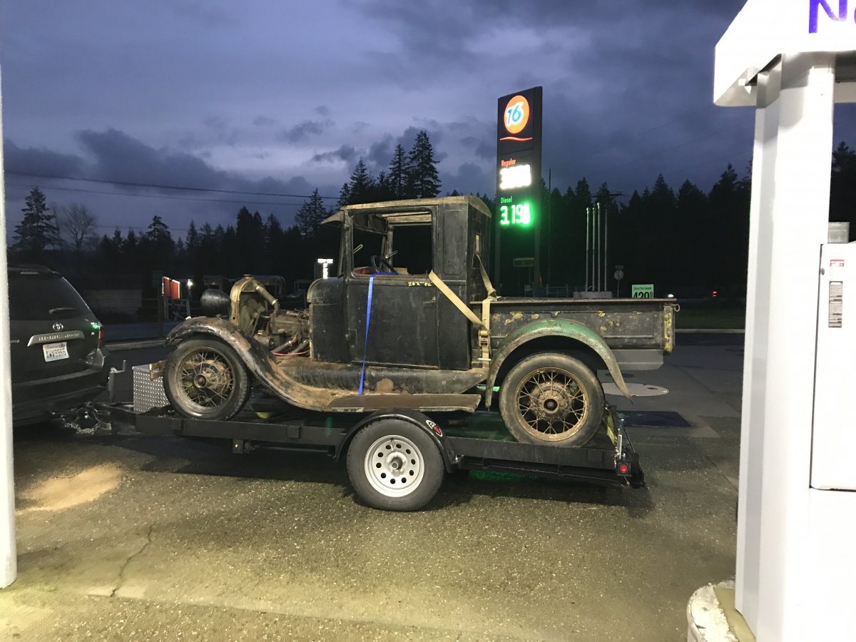

    At last, I have some time to catch everyone up. While working inside my garage on the cab and doors, I continued dismantling the rest of the truck outside, as weather permitted. Goal was to get the frame to a sandblaster asap . But when I removed the box, I hit this little snag:
    Looks like the back section of this frame was replaced, maybe due to an accident? It’s been gas welded and is only more-or-less square. And I don’t know what’s going on with the cutouts on top—they seem to serve no purpose other than weakening the thing. It’s a shame, because the frame is fairly clean otherwise and has good numbers, which will be key for re-titling. I’ve been through the that process a couple times—it’s time-consuming and involves multiple inspections, but is relatively straightforward (at least in this state).
    This frame would still be a good candidate for a kickup, but that’s not my plan. And A-frames are common enough that it’s not worth messing with this—especially because the pandemic closed down my local commercial welding outfit. Bummer for me, but really sucks for the Alaska fishing fleet, which winters here.
    I put the word out for a replacement frame—by which I mean I phoned @Hitchhiker. After some discussion of the challenge, he did me one better. On a nice frosty Friday he grabbed my trailer and came back with this:
    It’s a ’29 special coupe that’s had the back cut off in a classic wartime pickup conversion. The seller was the grandson of the original purchaser, and it was his grandfather who cut it up and gave it a home-made wooden box (now rotten) with cool hand-forged brackets and hinges. Everything from the back of the doors forward is pretty sound and complete—garnish moldings, glass all around, most everything seems to work. But from the rear of the doors back…well, it suffered a bit.
    But here’s the best part:
    It has a numbers-matching title and is registered as a pickup truck.
    So this kills two birds with one stone—frame and title. No messing around with paperwork and State Patrol inspections! And as a bonus I’m getting a bunch of incidental parts I can use, including numbers-matching engine (core for the future—currently seized) and incredibly straight fenders, excellent gauges, etc. When swap meets come back, I’ll sell off the coupe body to recoup some of my cost; it’s very savable.
    Shortly after the new “truck” arrived, Mother Nature blessed the occasion with another snowstorm. It’s becoming a theme.
