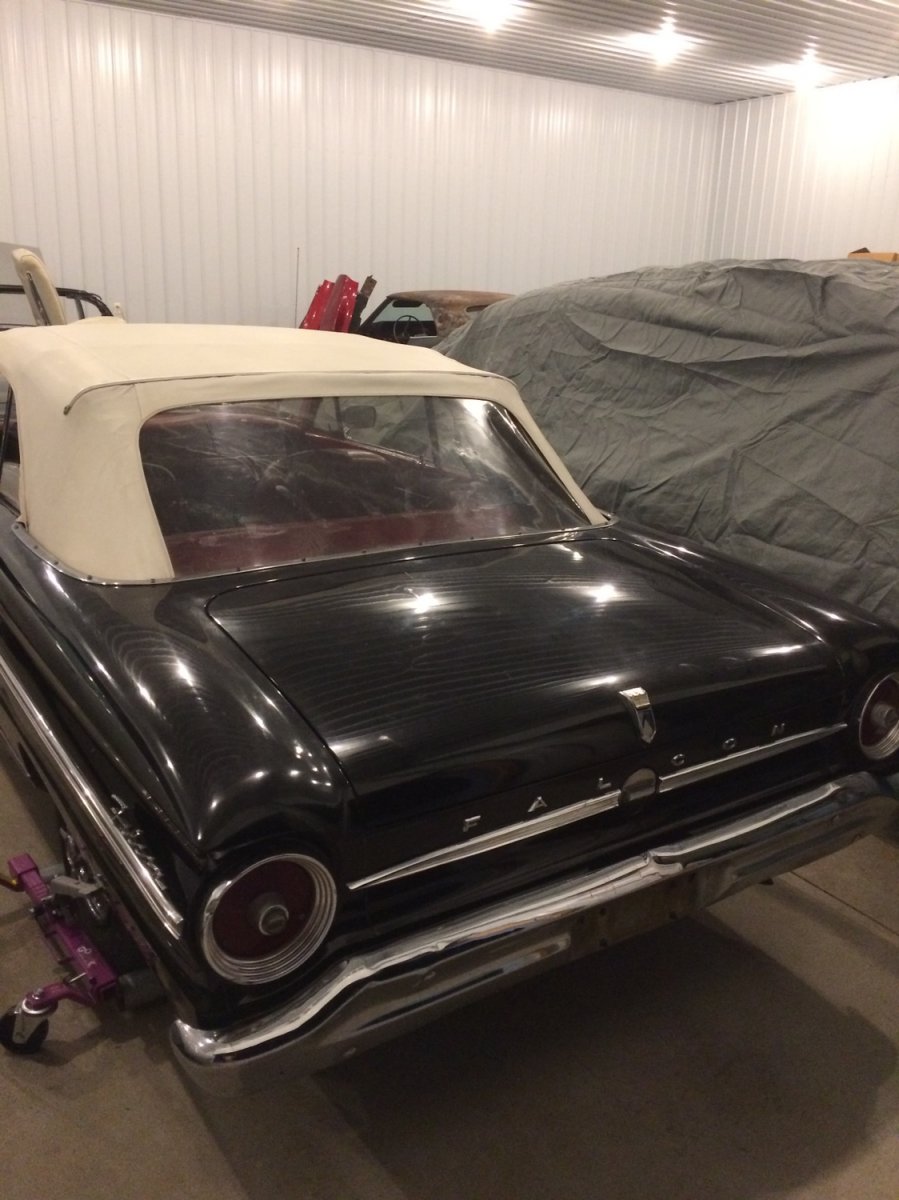

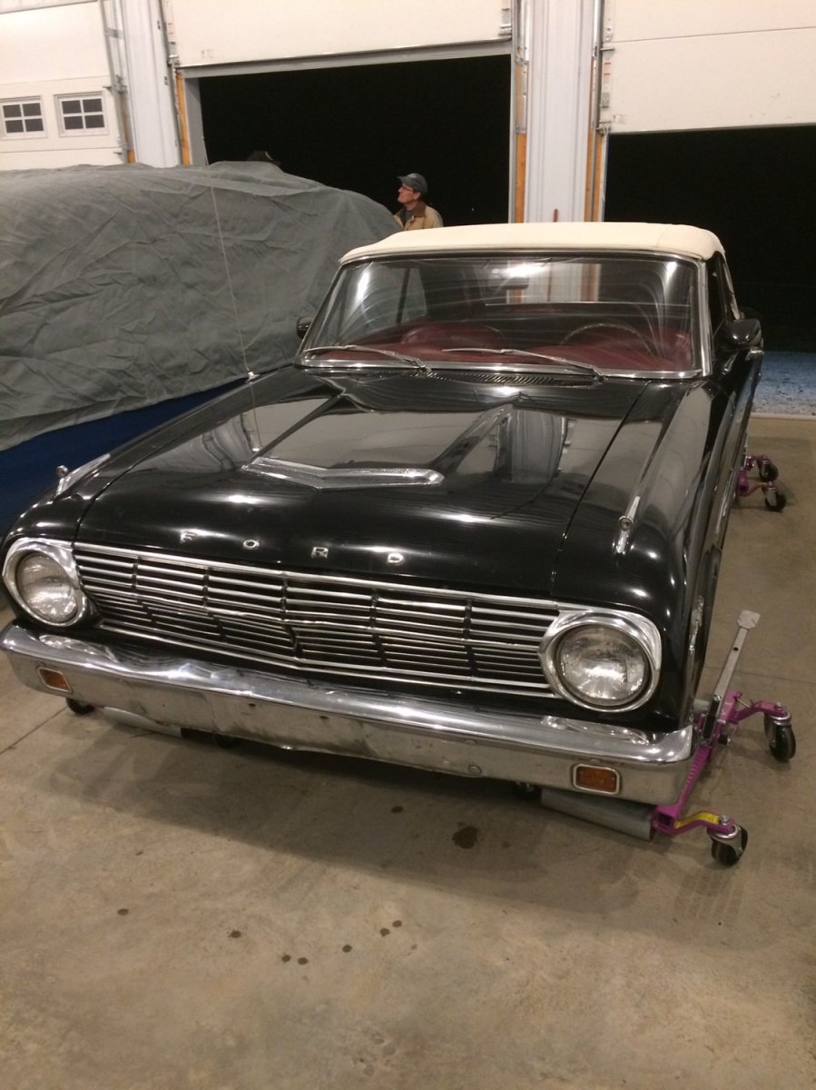

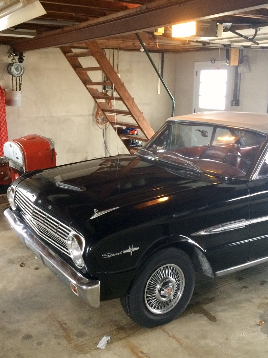

    Recently picked up a clean and original (minus the trans) 1963.5 Falcon Sprint convertible. The car is has all original running gear 260 v8, rear etc but the 2 speed auto was swapped for a 3 speed manual in the 70s. My plan is to keep it all original but I would like to ditch the 3 speed for a t5. I would like to keep the shifter as close as possible to stock 4 speed location/ look. I know I need to use a t5 from an s-10, but has anyone else done a thoughtful t5 conversation? Any recommendations and guidance on the parts needed to do this conversation? Thanks for your insight! Adjustments.JPG IMG_0462.JPG IMG_0463.JPG
