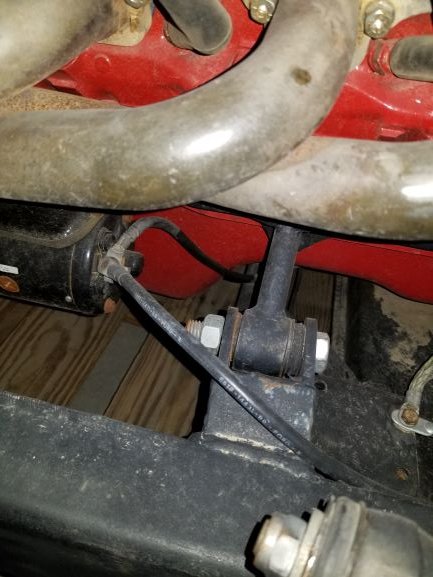

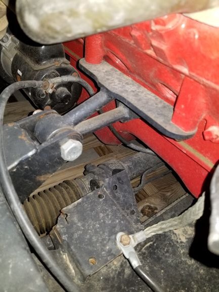

    I've known from the get-go that I had to address this because the motor mounts are shot anyway. But whomever "fabricated" these pads for the motor mounts called it in that day.
    These things flex like Gumby's dick. They're gonna end up cracking the frame or worse.
    So... I if you guys could throw some suggestions my way, that'd be awesome.
    Do I just box 'em in and add a couple of gussets, or start from scratch? Either way, I have to yank the engine to get at them anyway, so...

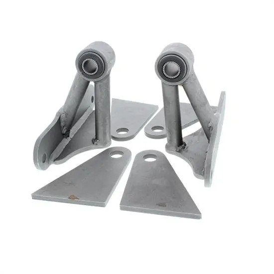

  13. I used the Speedway Universal SBF engine mounts in mine. I'll see if I have any pics of them installed. Of course the frame side tabs were far too short, so I had to fab my own. ezgif.com-webp-to-jpg.jpg
    chryslerfan55, loudbang and ccain like this.
  14. They look very much like what I had in mind. Man, I would love to see pics of them installed.

    I would box those motor mounts and then add a crossmember to connect them.

  17. Over achieved... walked out to the garage and took some pics... Took longer to resize them than it did to take them.
    Engine is offset to the Passenger side about 1.75" if I remember correctly and the drivers side mount had to be notched for a small drain plug that was in the block.
    Hope these help.
