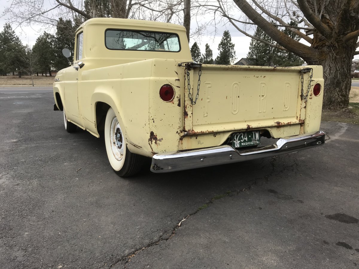

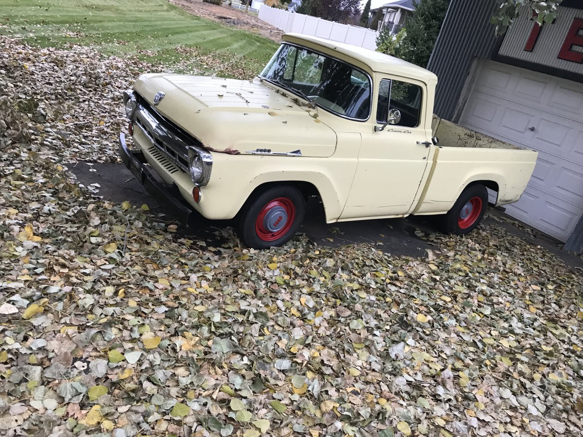

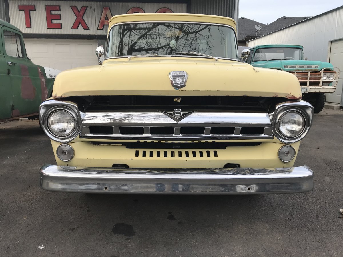

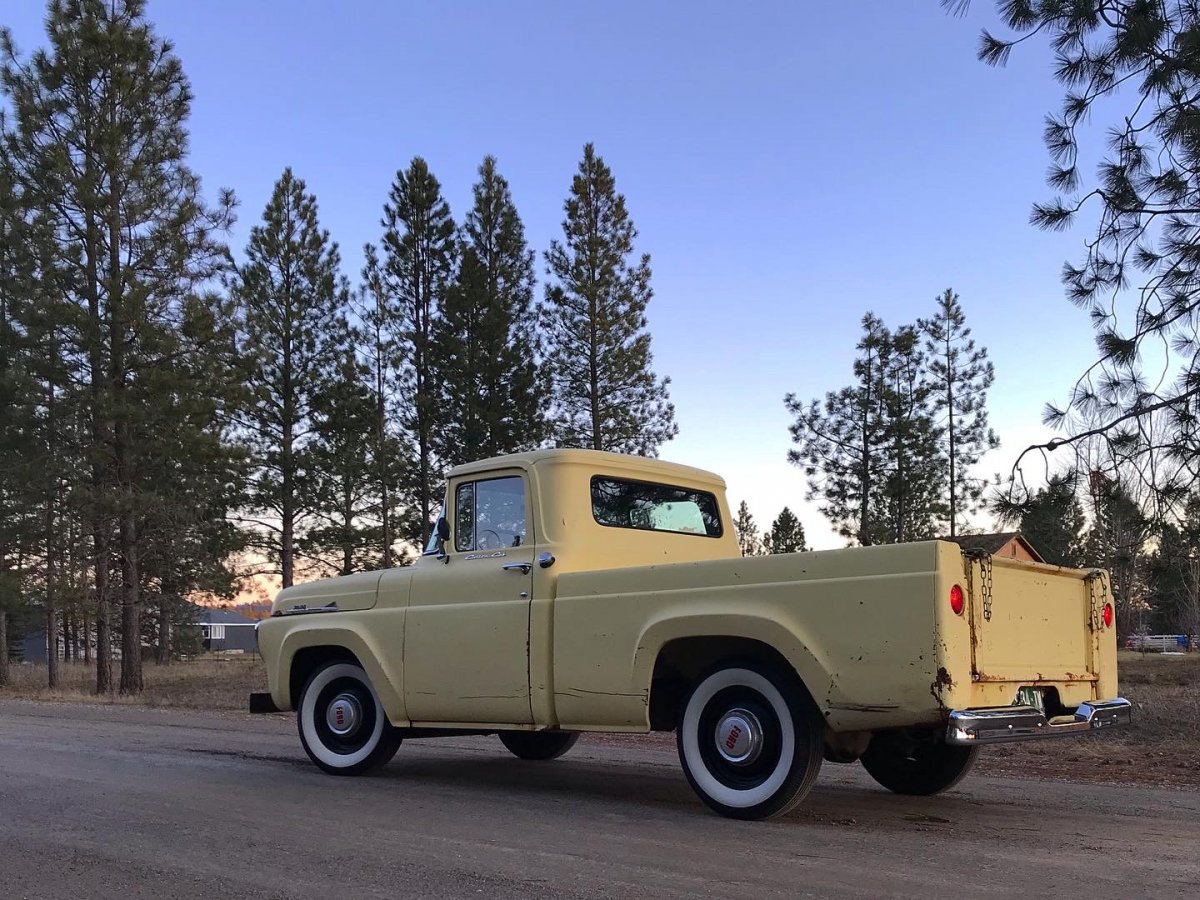

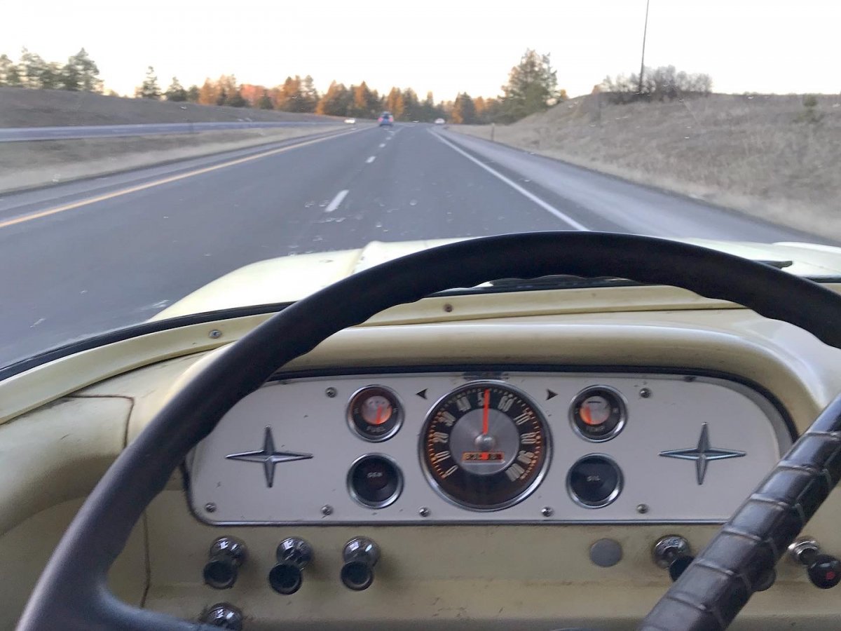

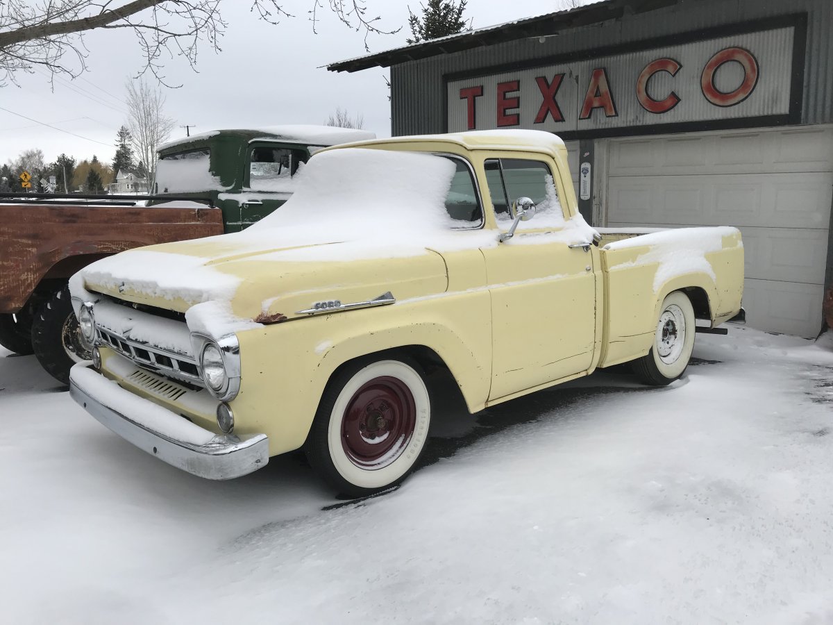

  1. Last fall I purchased this 57 F100 down near Sacramento. A guy down there knew I was into these and asked me if I knew anyone looking for one. The price was right and it looked very dry, so I jumped in with both feet. I had a friend coming up here and he offered to bring it up, so late October it showed up.
    the seller was pretty dang honest and once I got it, I verified that it is truly a rust free truck. Being a 57, short bed and a Custom Cab make it kind of the more sought after of the 57-60 trucks.

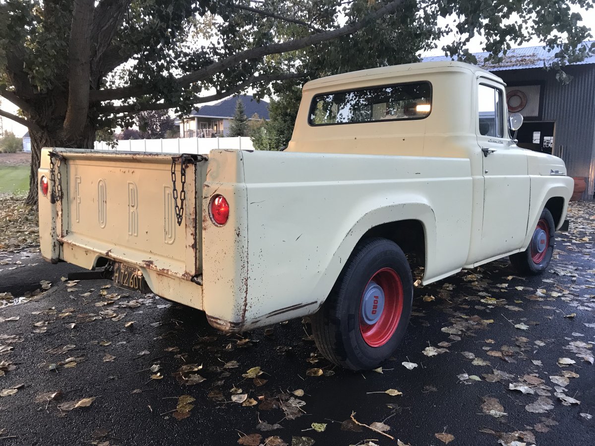

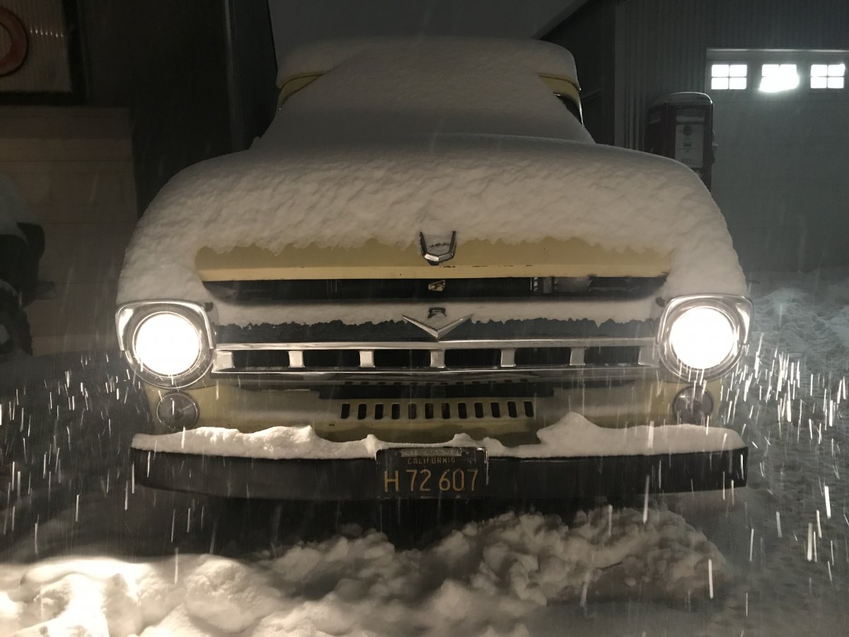

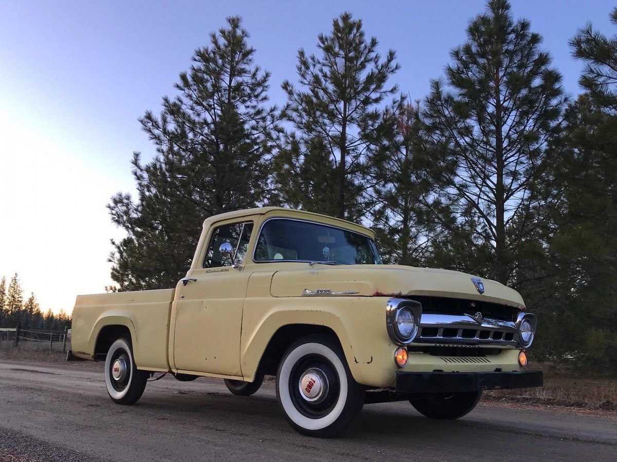

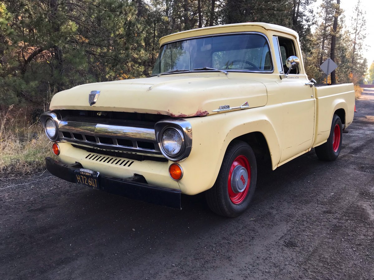

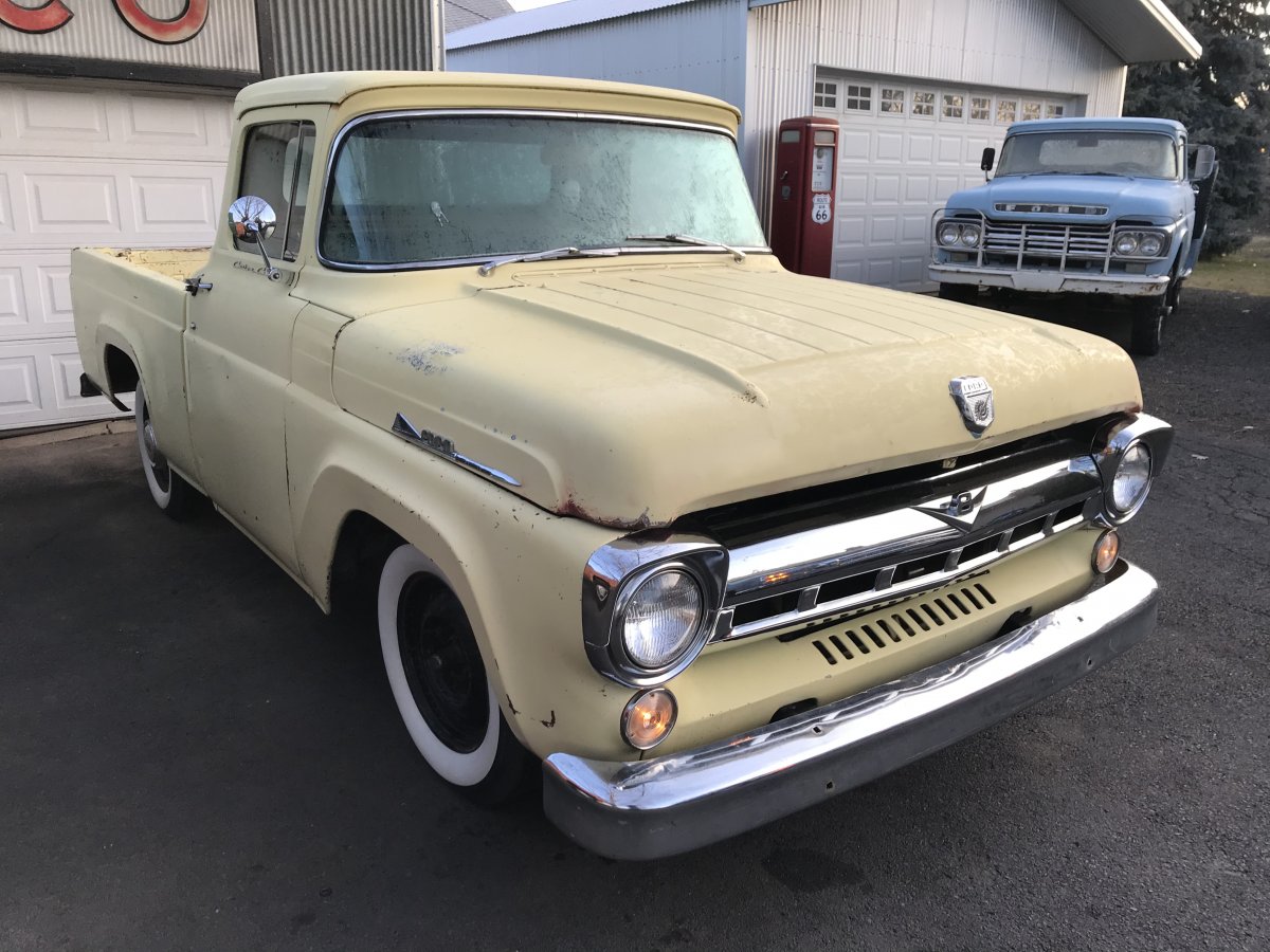

  4. Fall soon turned to winter, and the truck sat. It did give me time to look it over. In the truck came a lot of paperwork, showing a lot of work had been done prior to me buying it. All new window and door seals, window fuzzies, tune up parts, brakes, gas tank ext. Even the gauges had all been rebuilt. The truck runs and drives well, but the water pump was leaking pretty bad and the transmission clunks really bad in 1st and reverse. I did pick up a set of whitewalls I put on it just to get it looking a little better, Along with a near mint 57 V8 grill I picked up.

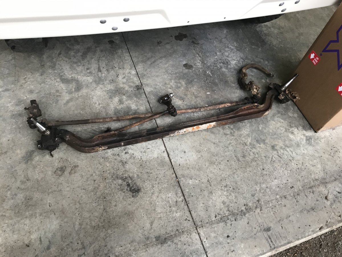

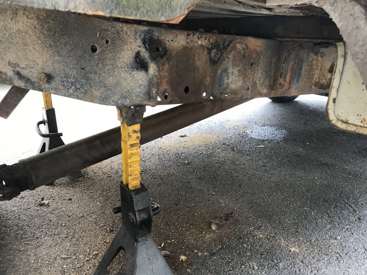

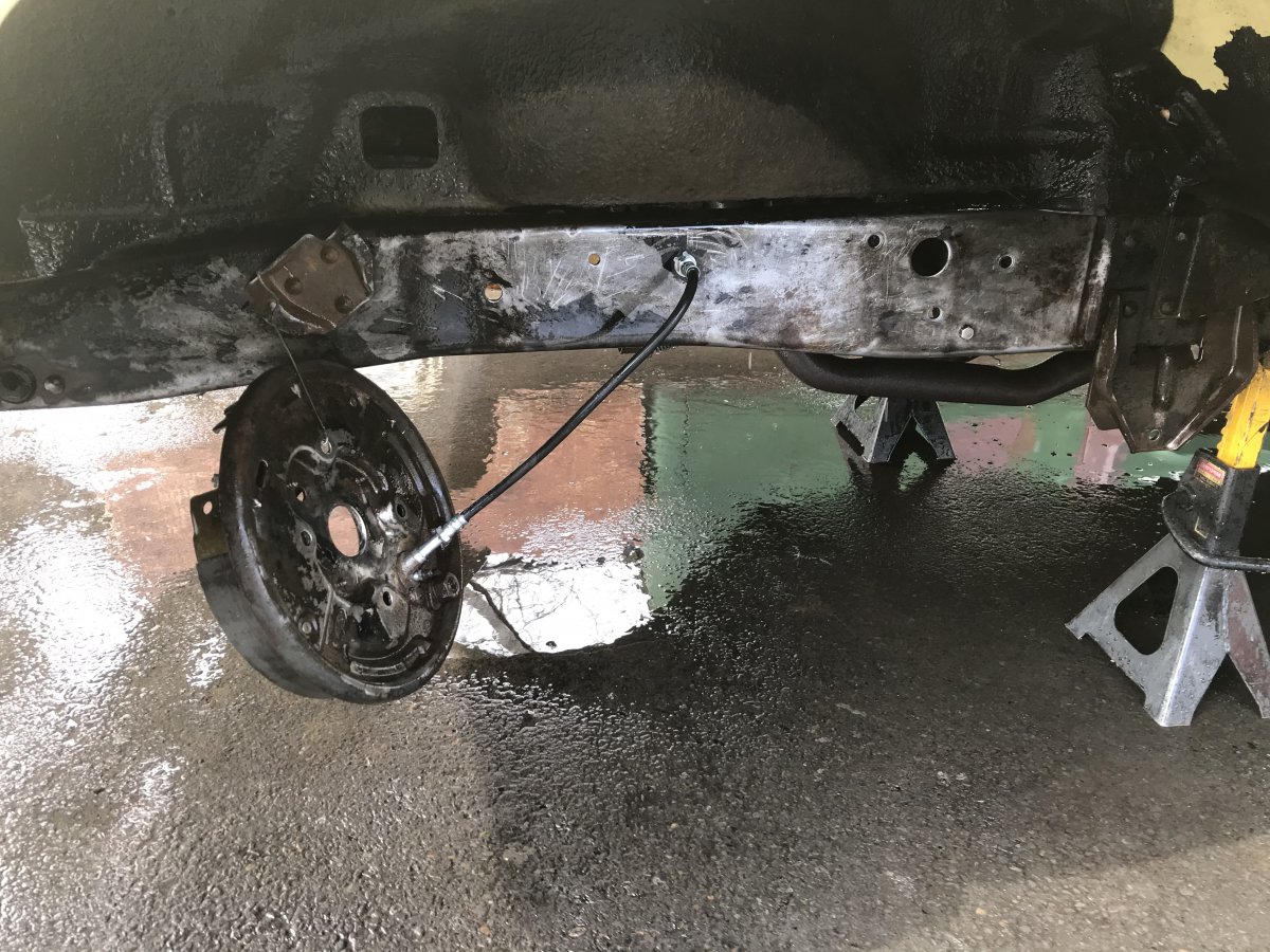

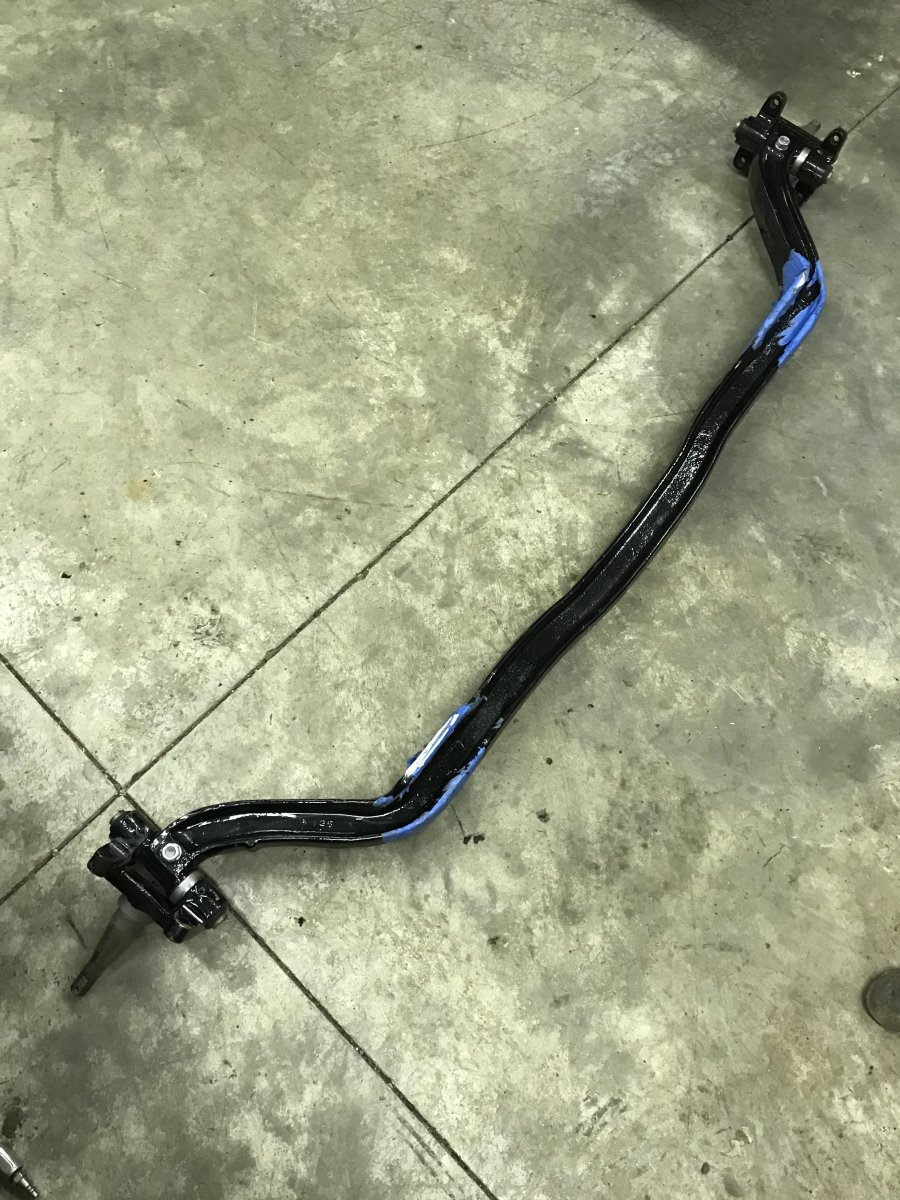

  7. A few weeks ago it was like 60 degrees here, and I decided to really dive into the truck so I have a sprig cruiser. I already had a Sids dropped axle, reverse eye springs and Sids parts to lower the back. I started at the front and pulled the front end out from under it, all with the steering box as I was sure it needed attention

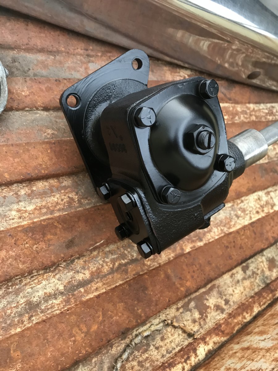

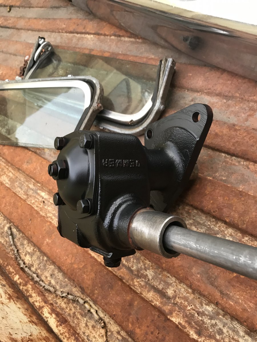

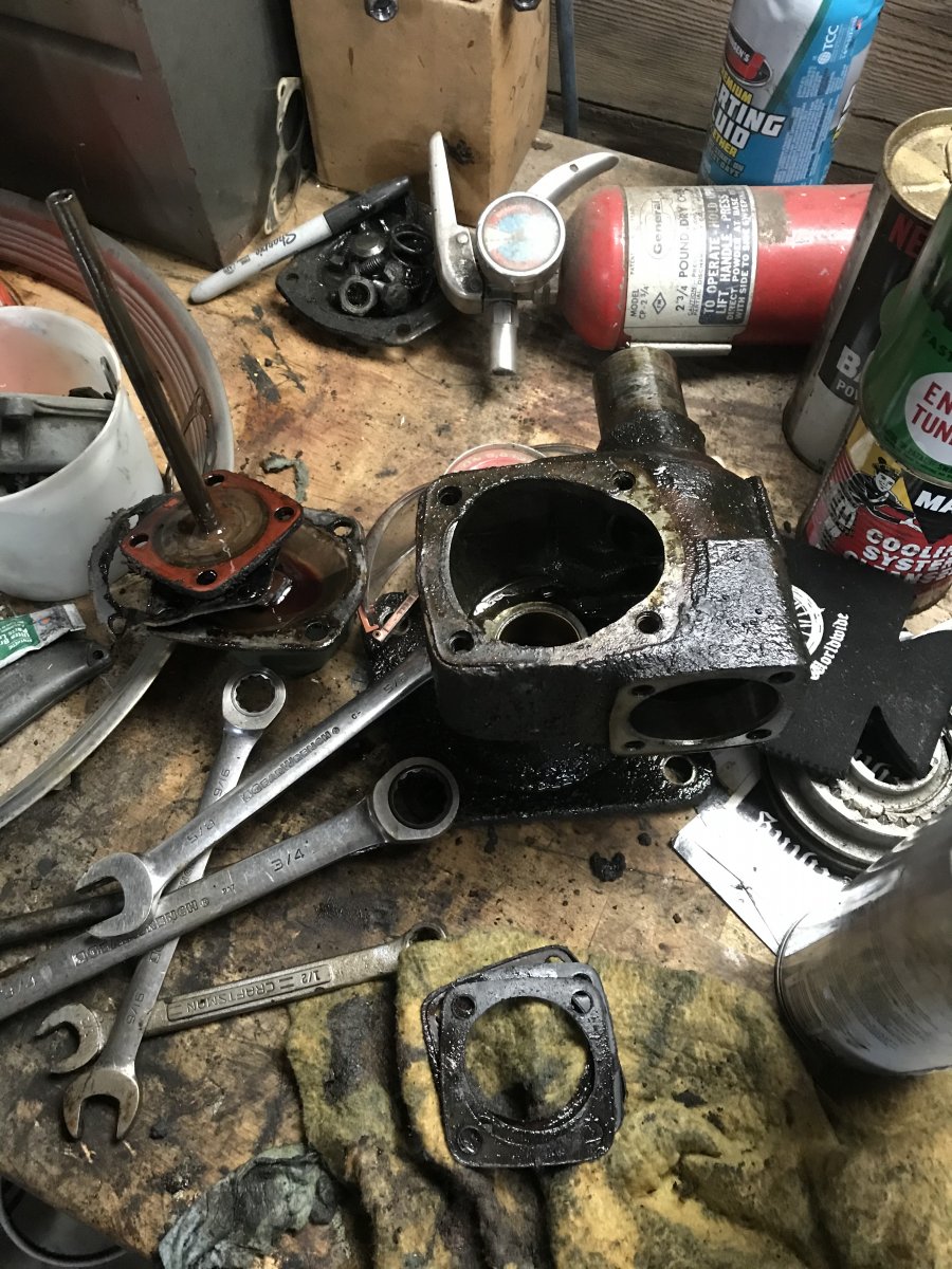

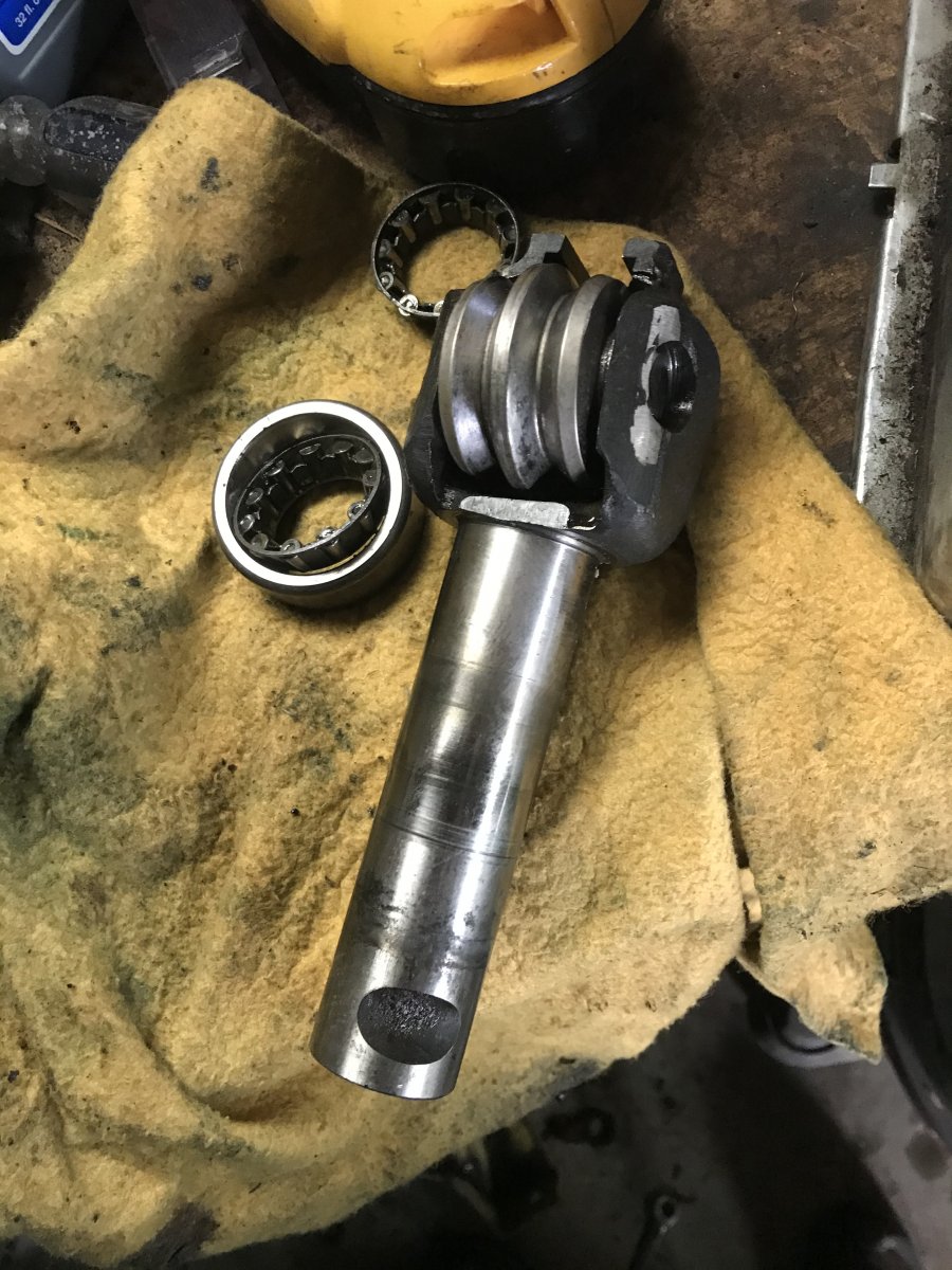

  8. The worm gear was toast in the box, so I ordered a new worm already pressed on a shaft and got he box rebuilt. I have been looking for a 57 “deluxe” chrome accessory bumper for a long time for this truck, and finally snagged one. I got it mounted too.

  9. I got the front end loosely mocked up and discovered the steering arm needed no modifying for front end geometry

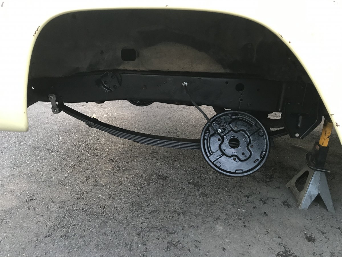

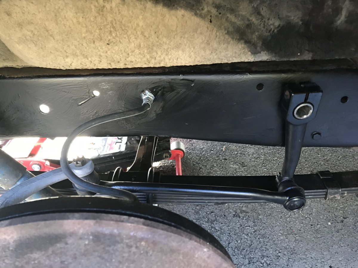

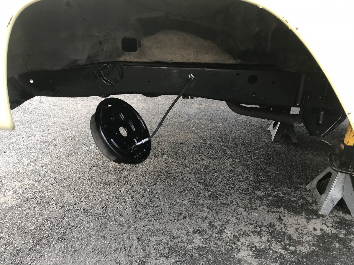

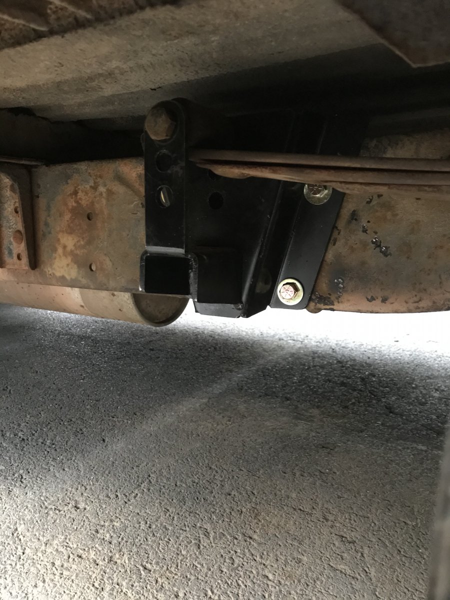

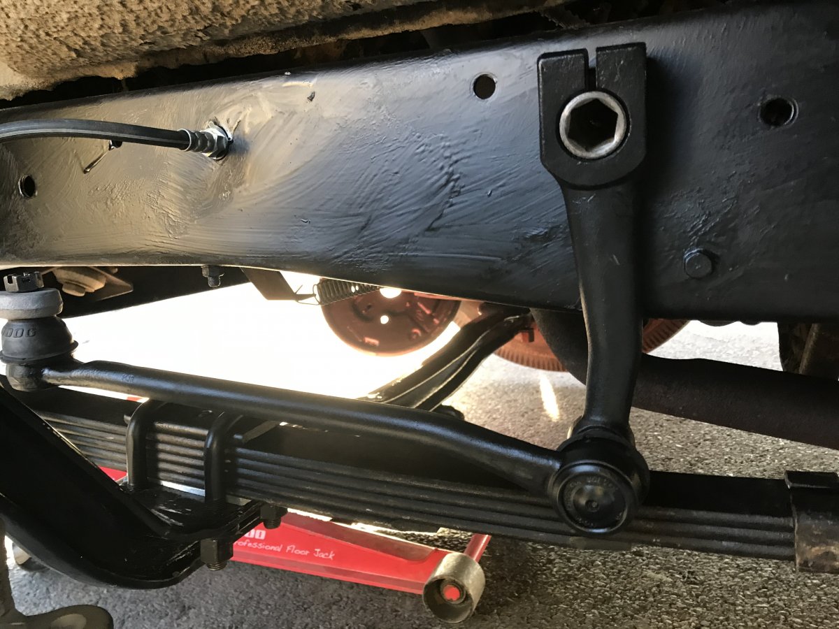

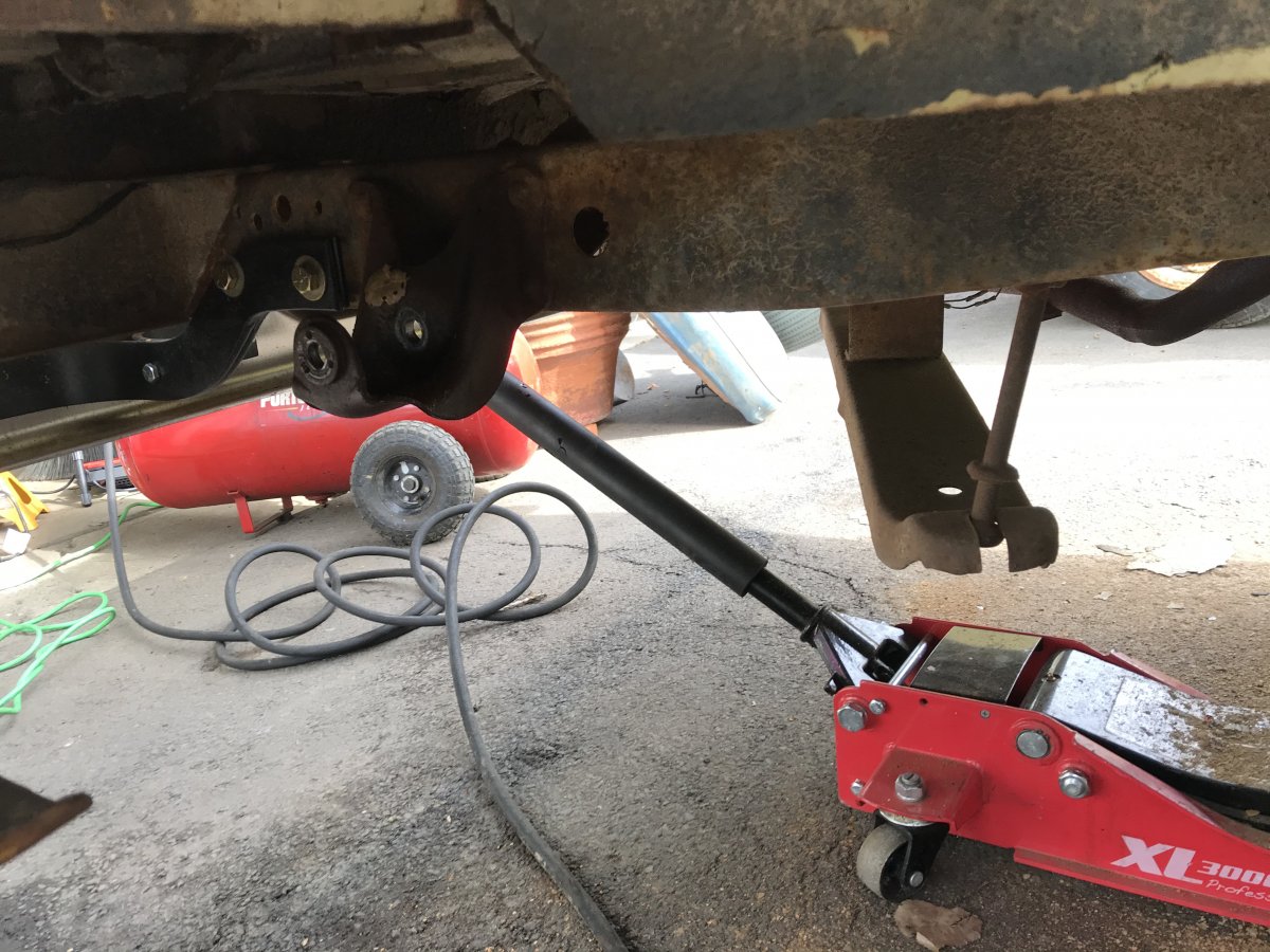

  11. So I moved to the back. Using the stock springs, Sids sells modified front hangers and longer shackles for the rear of the spring. You have to pop 4 rivets out of each side and bolt the new hangers on. The spring bushings and bolts were nice and tight on the rear springs so I did not replace them.

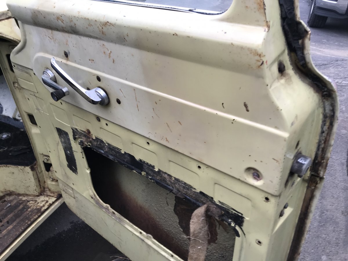

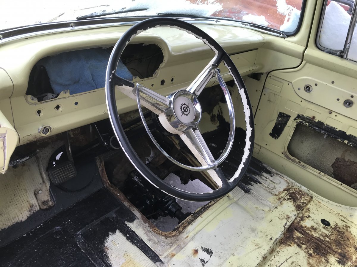

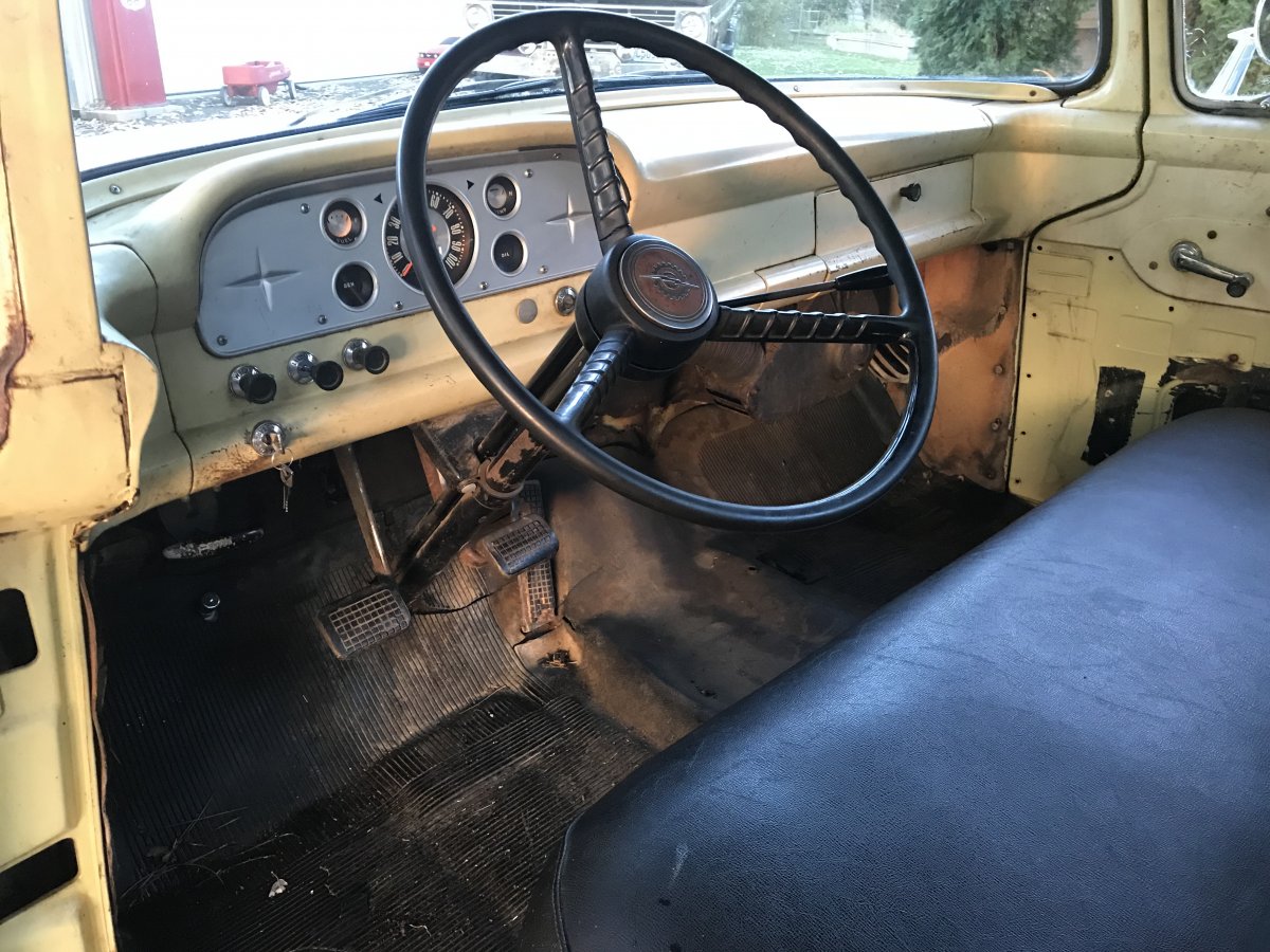

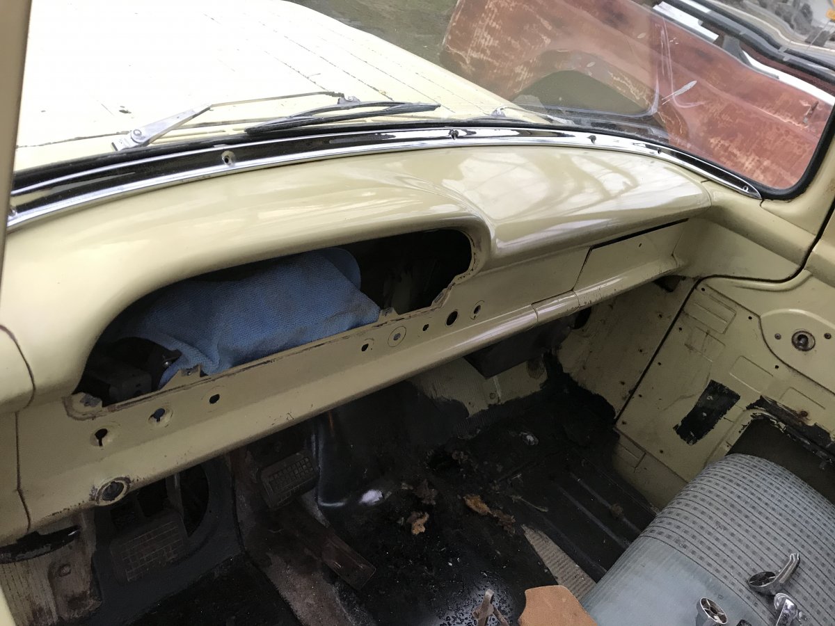

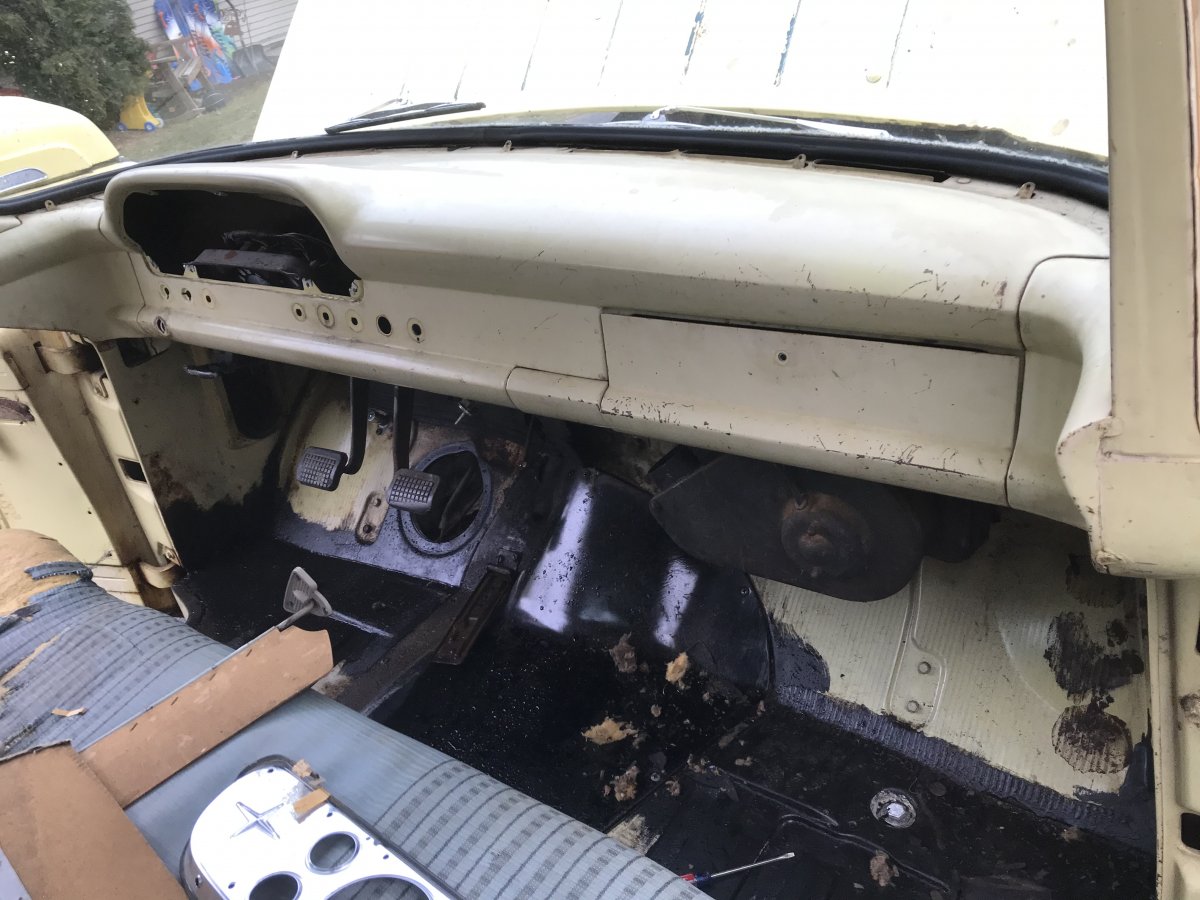

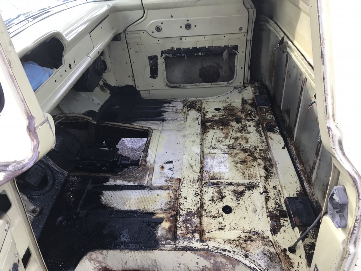

  13. Keeping momentum going, I gutted the interior and scrapped, wire wheeled and washed the inside. I removed the cowl bent flaps and hosed out the pockets behind them. I’m trying to make his thing as clean as I can, so no dust and dirt are stirring around. The original Inca Fold paint inside was badly faded and discolored, very gray-ish. A little or and polish and t came back pretty good. I brushed a little POR15 on e front floors and sent the seat and door/kick panels to my upholsterer

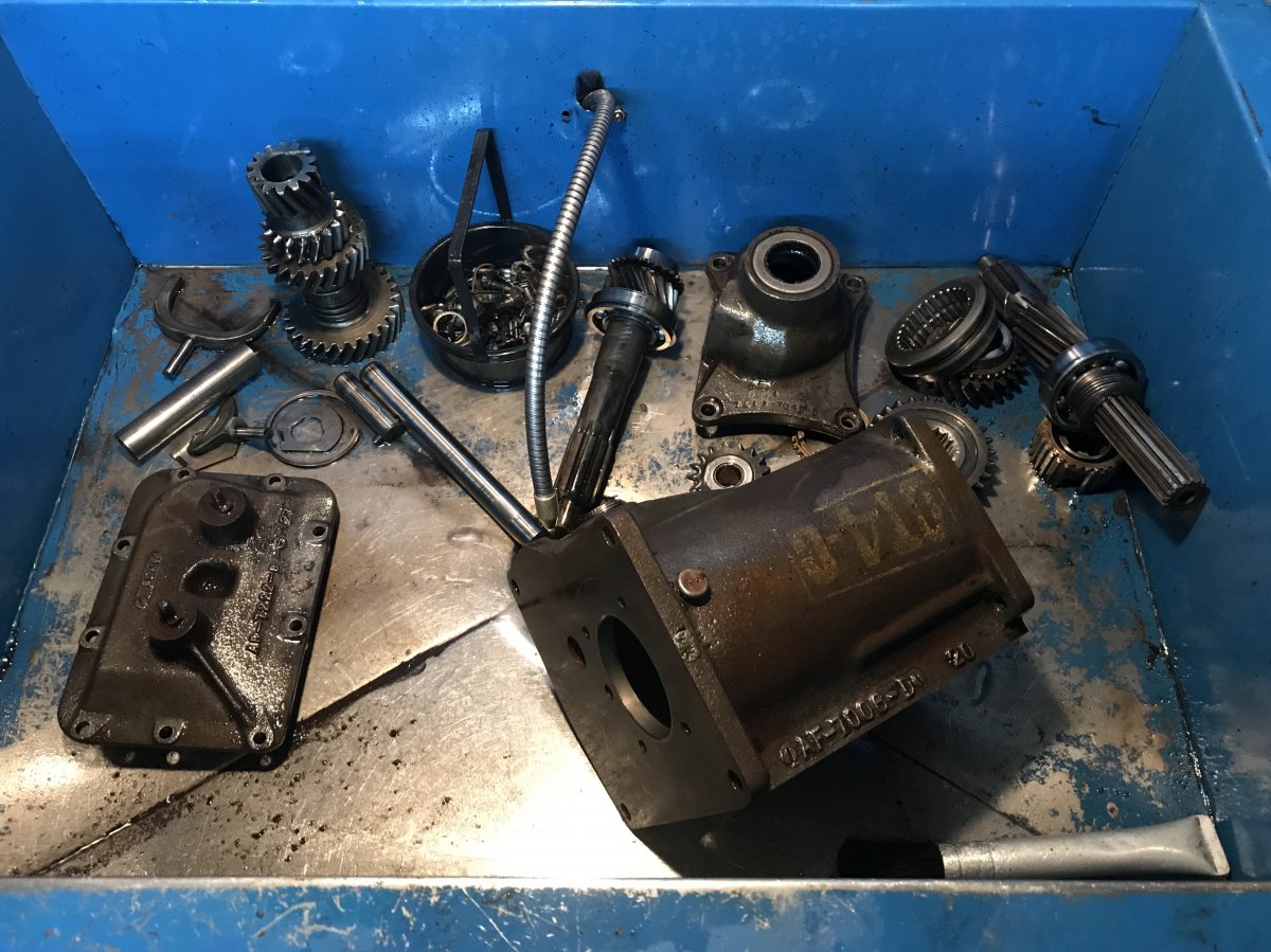

  14. I also picked up a spare trans at a junk yard last fall, and thought this was the perfect time to swap that. So I dug it out, popped it apart and ordered a few new parts. Cleaned it and put it together, and installed in the truck.

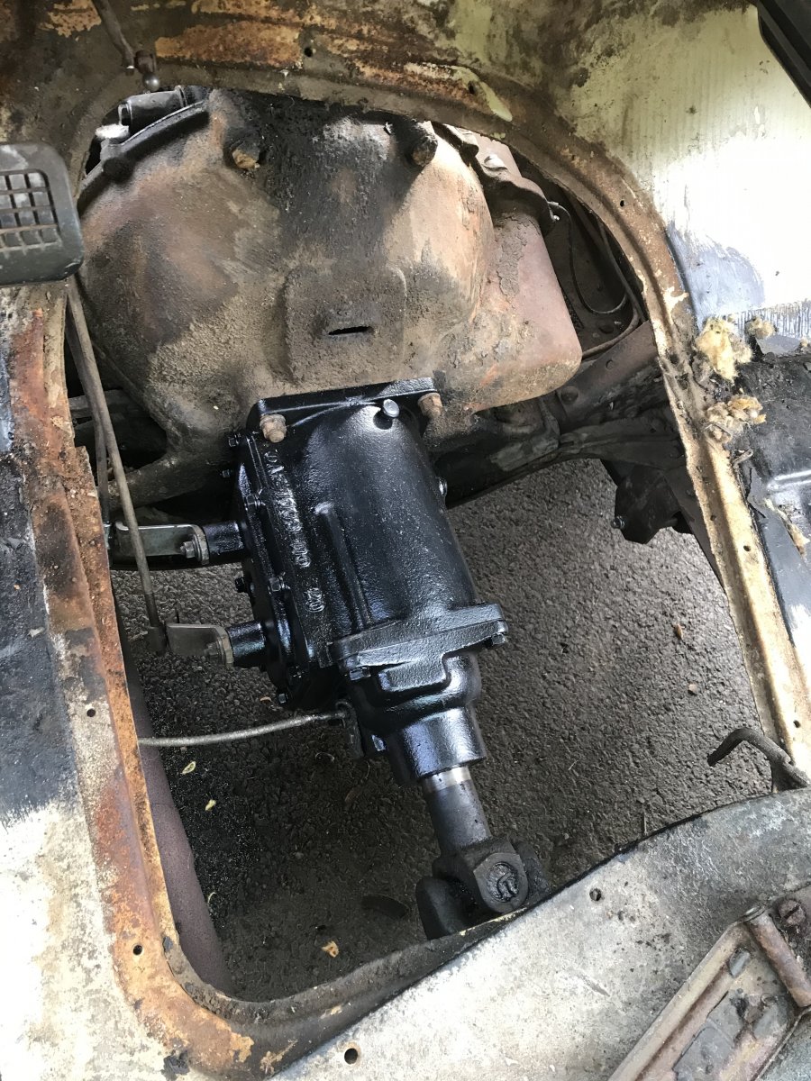

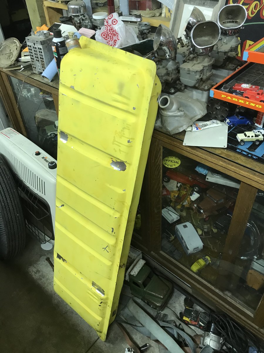

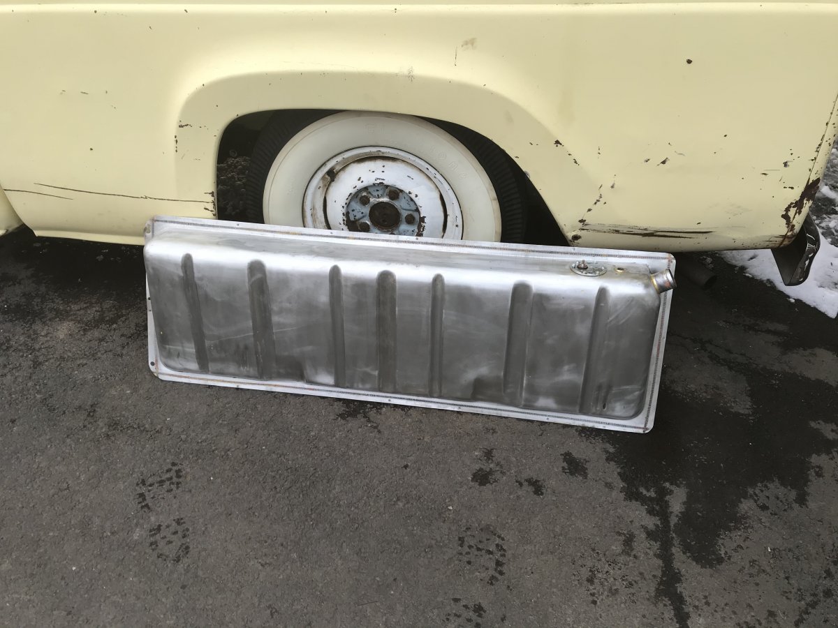

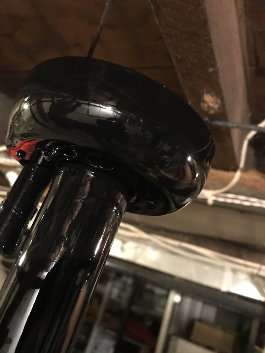

  26. This weekend was cold and snowy so did t get a lot done. I painted my steering column and got it and the steering box installed. Still need to refinish the wheel. Also, it has a new gas tank in it, but the previous owner painted it an ugly yellow...used some stripper and got it looking better
