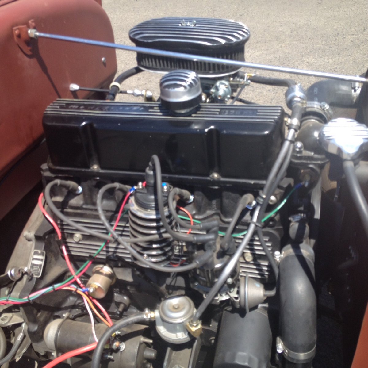

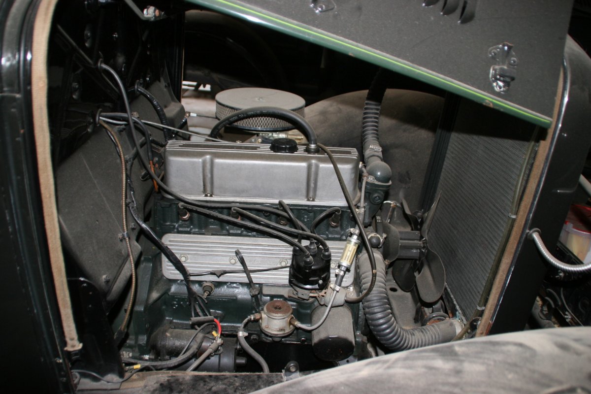

  4. IMG_8089.JPG IMG_8092.JPG My '32 roadster has a Mercruiser 181 cubic inch engine. Everything clears. Need a 4 inch spacer to get the fan close to the radiator. Will bolt to a '39 Ford transmission using a standard speed shop adapter designed to put an early Ford transmission to a SBC. Stock '32 rear end works fine. Generator (if you like the look) from an early sixties Chevy II 4 cylinder (and probably 6 also) bolts right up. Head from a passenger car 153 bolts right on if you don't have time/$ to built manifolds (the Mercruiser manifolds were water cooled). Aluminum valve covers and side plate were available on the Untitled.jpeg Mercruiser engines. Stay away from the marine cams they have the wrong torque curve (don't ask how I know). Standard distributor from a 153 passenger car engine works fine. Much stronger crank than the 153 engine (the industrial strength crank). I believe this is almost the current 181 industrial engine from GM. Ton of information on this (and the 153 engine) engine in the archives.

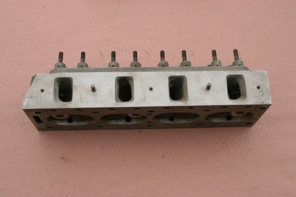

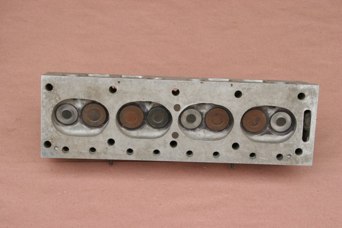

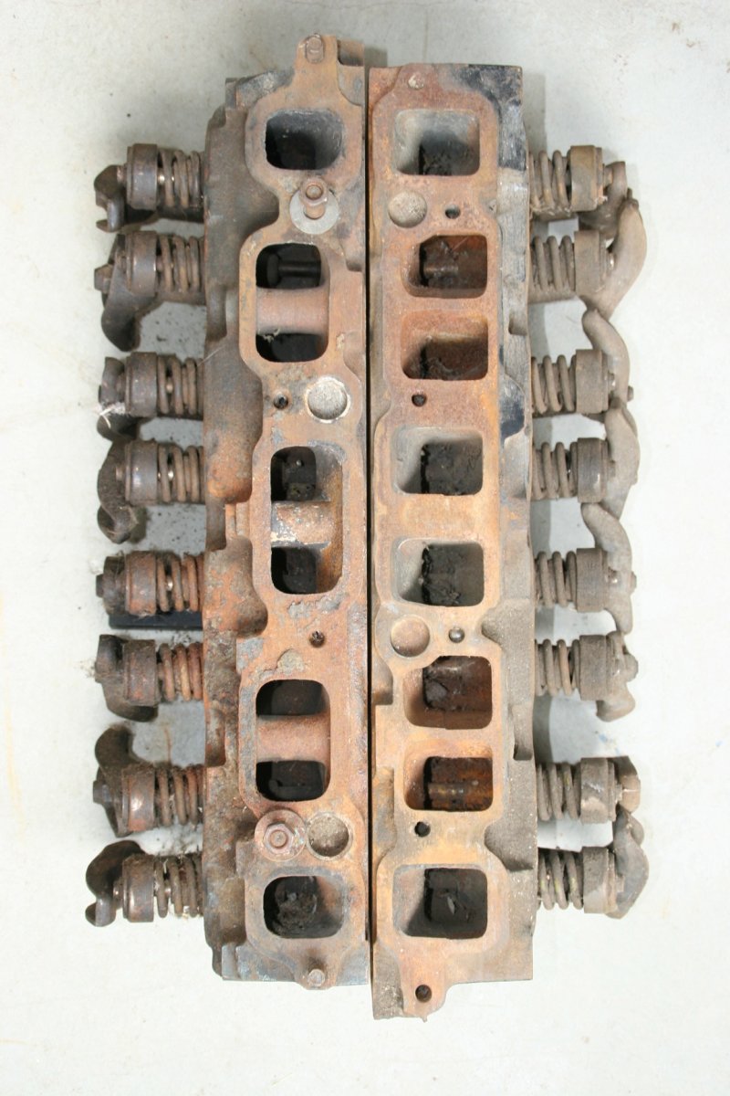

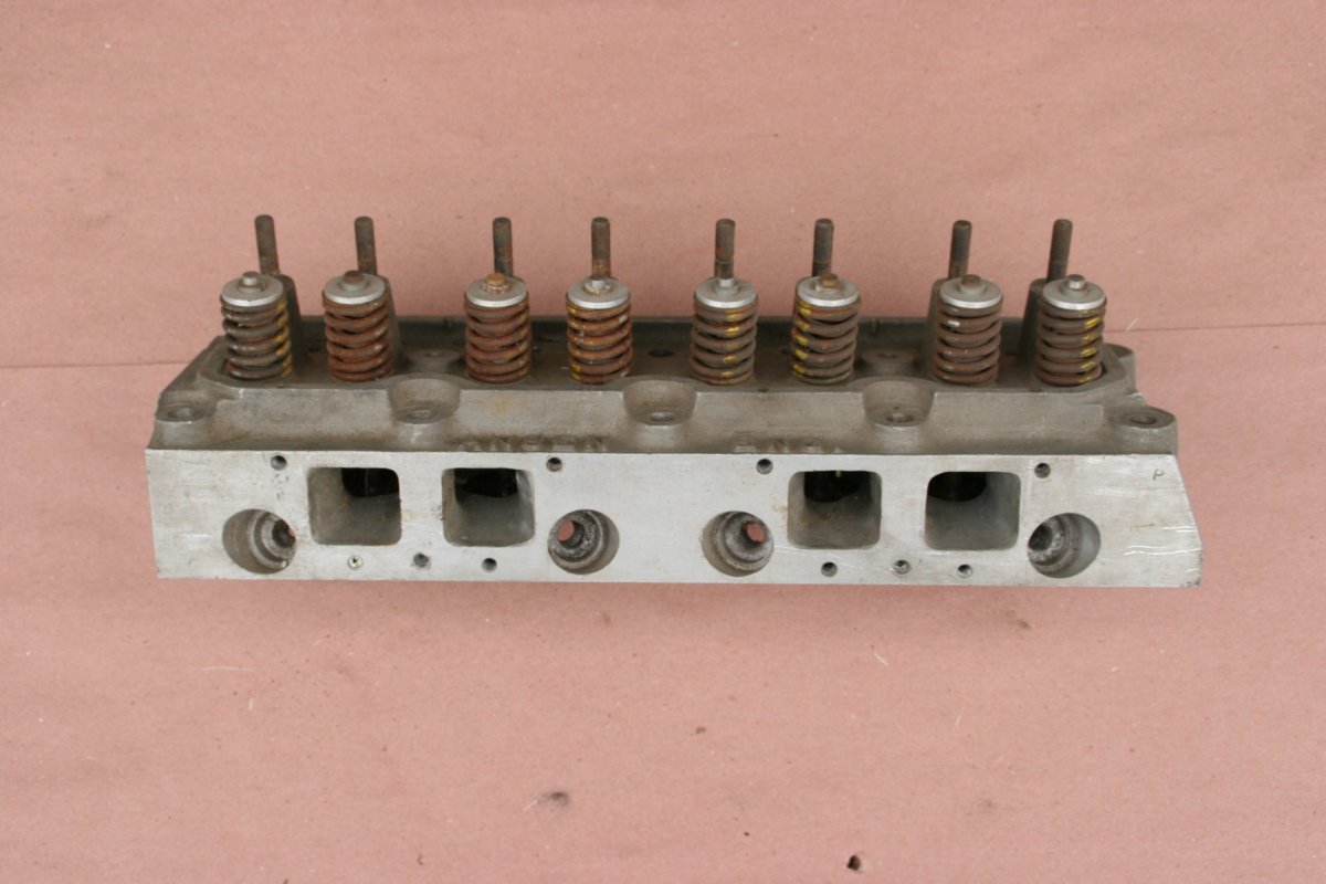

    One easy solution to your problem would be to get a Chevy V8 head, relocate EVERY bolt and make a piece to cover the push rods that will now pass outside of the block. A second solution would be to get one of the ANSEN heads from the early sixties, they made hundreds (about 200 if I remember correctly, but it has been a long time). See attached. A third solution would be a racing head I believe they currently use in the Australia/New Zealand area (help guys). Some of the Iron Duke 2.5 liter engines had crossflow heads but remember they are a different engine. Also attached is a photo comparing the ports on the 153 and 181 heads. A final thought the Industrial engine is 3.0 liters and the other two referenced are 2.3 or 2.0 liters. Remember what they always say, it is hard to beat cubic liters (or was that inches?).
    Charlie Stephens
    Lil'Alb, 29EHV8 and Jet96 like this.
  15. volvobrynk
    Joined: Jan 30, 2011
    Posts: 3,587
    volvobrynk
    from Denmark
    That's a nice head!
    And the quote you was looking for was: There is NO replacement for displacement!

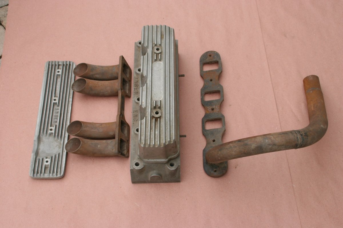

    A guy here had all the patterns to cast the Duggan/Deppe 4 and 6 cylinder engines and all the covers and intakes. He was setting up a foundry and then changed his mind. I think it is all in South America now.:(
    [​IMG] [​IMG]

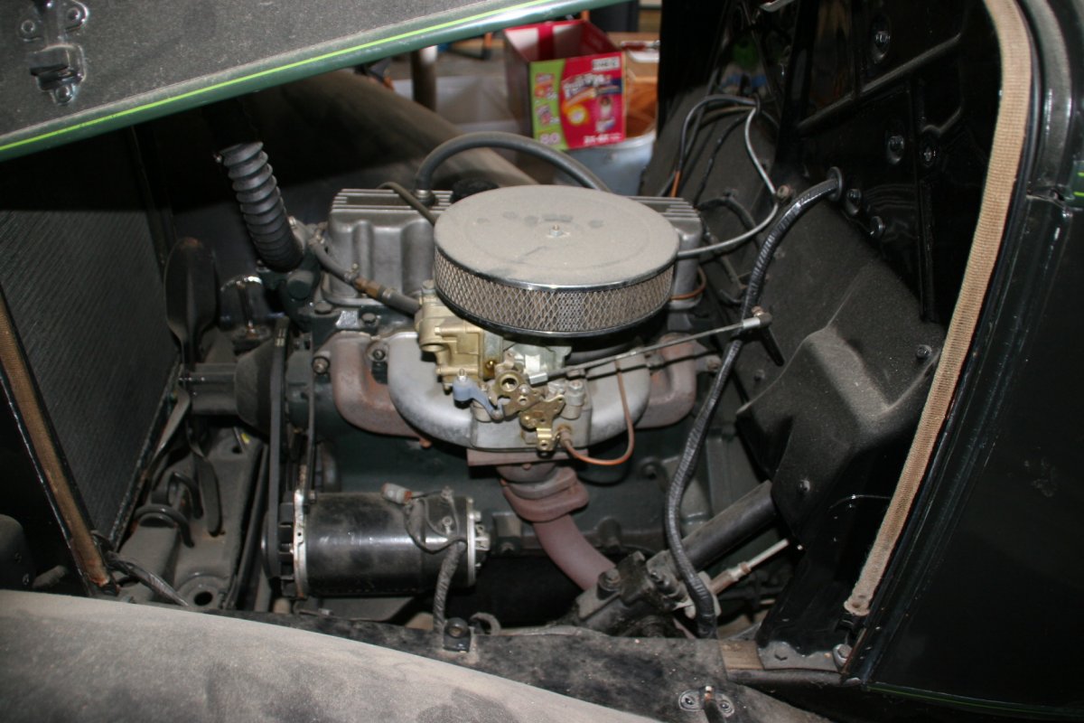

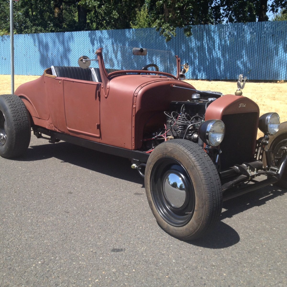

    I built this '27 roadster with a 120 Mercruiser a couple years back, ran great, sold it cuz I'm 6'5" and 250 IMG_2572.JPG IMG_2577.JPG
    Lil'Alb, 29EHV8, MO_JUNK and 2 others like this.
  20. There are pitfalls to consider in using a 153/181. being marine motors, they get amazing amounts of internal rusting. So before putting much into one, pressure test the head to be sure it will not fail right after you rebuild it.
    40 psi was enough for water to push a hole right through one of my heads.
  21. Yes, steel tubes welded into head for every bolt hole.
