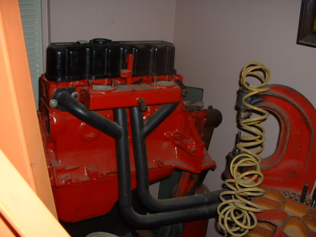

    Here are some pictures of what I'm doing. I started with an Offenhauser 3x1 manifold. The 153 is 2/3 of a 230 Chevy 6 and port spacing is the same for the ones it has. I'll build an exhaust header using flanges for 6s sold on eBay. You use the front set as is and cut the single port from the back set and weld it on.

    Thanks for the ideas. I have a couple of these and was wondering what to do for an intake. Mine are actually the Mercruiser variety so I am still looking for a rear sump oil pan and pick up. Is there anywhere to find those? Sorry to semi hijack.

    The rear wheel drive 151s (Iron Duke) pans will fit. The early '80s YJ Jeep pan is rear sump. I don't know about the S10s.
    UPDATE: Some 151 pans may fit but the ones with a one piece rear main seal will have to be tweaked.

    I have heard that the 151 cross flow heads will fit but they have small poor port design and thin castings that doesn't allow much porting. There are at least three 181 heads. One of the 8 port ones uses 2" intakes and 1.60" exhaust valves. These things are 2/3 of a Chevy six. Pretty much what works on a six works on a four. And there is a lot of interchange with some small blocks. 6 & 4 rods are slightly wider than V8 but use the same bearing. 153s use 2.0 181s use 2.1. Mains are the same. My 153 has a 181 crank and rods. 181 rods are hard to find cheap. They are not all the same. When they went to one piece rear seal a lot changed. Isky makes cams. Mine was ground by Erson just before they moved. Aluminum intake flanges for 6s are for sale on eBay. Use the front two. Get two DCOE mounting plates a a foot of tube and build a duel Weber set up. Grab The ECM and harness from Sunbird and run EFI. Lots of options and at least one source is talking of making some new stuff.

    Here's my head. Lump ports,1.86" intakes, 1.60" exhaust, 70cc chambers, and ported. The work was done by Tom Lowe. He said it should flow about 250 cfm and with flat top forged Ross pistons and zero deck CR will be 9.5 to 10.0 to one.
