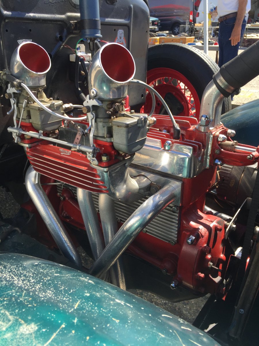

    My first suggestion would be to put your general location in your profile. There are some excellent engine rebuilders around the country but there are definite advantages to locating one that is close. There are also some to avoid. Be sure to consult the archives here and at fordbarn.com when you are trying to decide. Note that if a company has a symbol in their name, such as A&B machine, you can to to GOOGLE and search for "A&B machine on HAMB" and you will get what you are looking for. The search engines on HAMB and Fordbarn can't deal with symbols so you need to use GOOGLE. For the cam be sure to check out Bill Stipe. You can get a new cam with oversize journals and then ream your block to fit the new cam. The attached picture taken at LARS couple of years ago shows what I think you want to build.

    Hi Charlie,
    Thanks very much for your reply, without the red paint, that picture is exactly what I want to build.

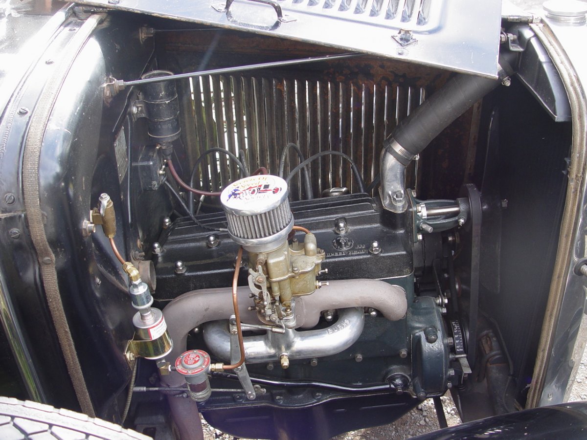

    I've run old Strombergs as well as the new ones and even used a Mooneyes EFI on my bangers. Both of my cars are equipped with Weber 32/36 progressive two barrel carbs. Much easier to tune than a pair of 97's. Check out the FS ignition. IMG_0063.JPG
