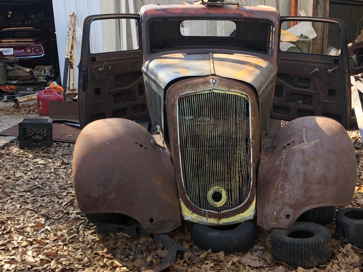

    Drug this 33 PC coupe home earlier this week after a thousand mile round trip. Completely disassembled. Previous owner passed and I bought it from his widow. Got it home and propped everything up to get a look at it. Most of it is there, and in usable shape. It’s missing the gas tank cover, needs the rear filler panel patched or replaced, and the bottom 6 inches of the inner trunk lid structure needs rebuilding. It’s had a stock style mustang II installed in the front, as well as a 4 link disc brake ford 8.8 rear, though both of those may need some redoing.
    Still deciding on the long term vision/plan for it. But looking forward to the project. It came with a fresh rebuilt 318 still on the stand, with trans. But I have a 440 I just swapped out of my cuda that may end up in it.

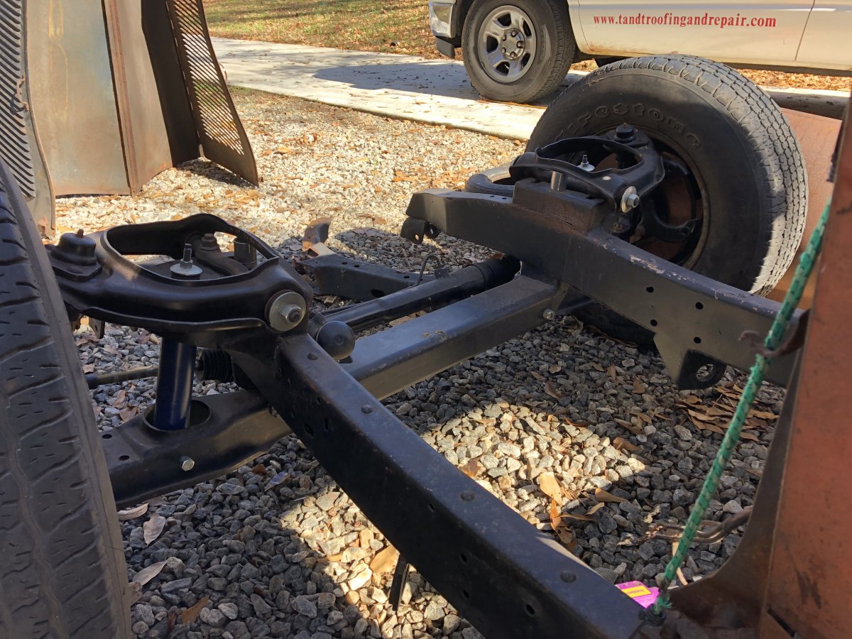

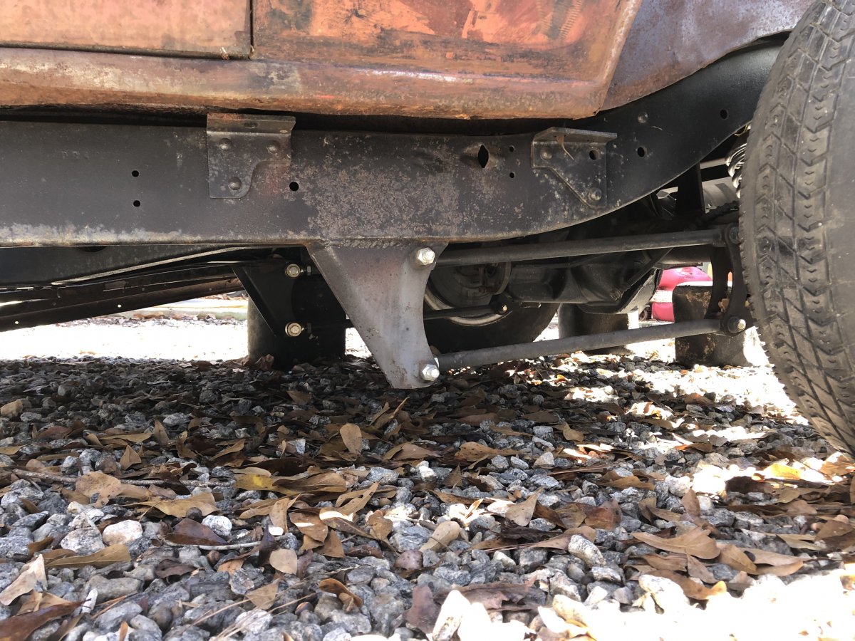

    Need to get this hunk of junk on some level ground and start figuring out where I’m gonna start. I think the first thing I’m gonna do, is figure out the stance I want, ride height, tire size, etc. I don’t really know what direction the previous owner was going with it.
    I’m not sure I’m a fan of the way he did the rear suspension. The forward mounts for the four link are mighty low, and the bars angle down. Panhard bar isn’t level the way it currently sits either. Both of those should be easy enough to fix with some new brackets.
    Not sure what to think about the front end. At the minimum, it needs to be rewelded. I need to get the fenders and all mocked up where they go to see if I’m even gonna/can use it. The track width seems too wide to me at first glance. I want the car to sit down, and I don’t think there’s enough clearance in the outside of the fenders to turn the wheels as is. I was gonna measure it, but threw my damn back out while moving some junk in the yard. Since all the original brackets and stuff were removed from the frame, I’ve also gotta figure out how I’m gonna remount the fender supports and everything else too.

  18. you got some good and not so good going on
    the ends or the rails are boxed and some store bought suspension pieces
    get the car on some level ground and start measuring
    the body needs to be bolted down to check if you like how it all sits. Those cars have wooden sub-rails under the body.
    then start checking the squareness of the frame and suspension mounting
    you need to set it up with the size wheels and tires you want to run, then modify from there.
    Im not a big fan of how that 4 bar set up is either but you need to establish your ride height before modifying.

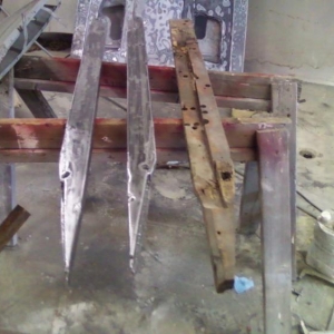

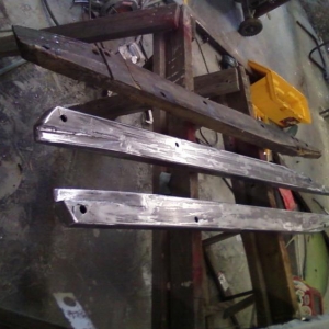

    here is a pic of some steel subrails I made to resemble the shape of the wood ones

    I’ve got one of the wood pieces. Once I get it where I can mock it up right, I figured I’d try and copy this one, or use it for measurements and make some temporary spacers. Did you just use to rectangle tubing to make those? Not being the one that took this thing apart kinda sucks, since I have to figure out how it goes back together with little to no reference.

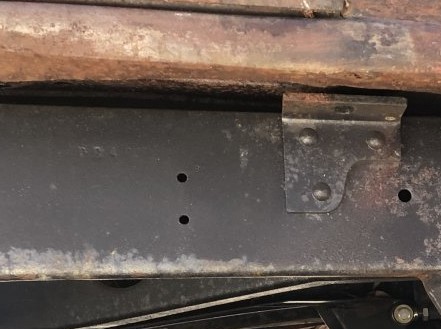

  20. Look REALLY close in order to see the original engine number stamped on that Plymouth frame rail....left side in the photo. It ACTUALLY looks like it is a PD not a PC unless I am seeing it wrong.... Plymouth engine number (2).jpeg
  21. I used 3 x 1.5 rectangle tubing
    sliced and diced to resemble the wood
    the inside step for the wood floor wasnt needed
    I also made a steel support for the body behind the seat
    It fit behind the interior, it was kinda like a mini roll bar. Stiffened up the body a lot

    Nah, it’s a C. I saw that when I took those pics earlier. Just took some more. Hard to get a pic that shows it clearly though.
