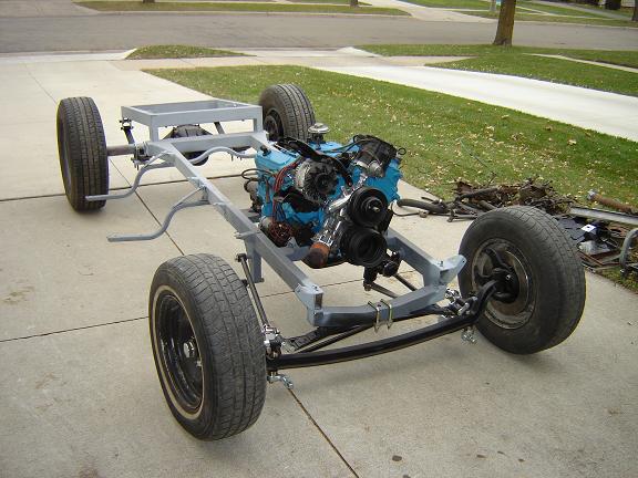

  4. hrm2k
    Joined: Oct 2, 2007
    Posts: 4,877
    hrm2k
    Here is a picture of the frame that Clark Bates built. It is for a 26 coupe coupe. It was built with a suicide front end. The finished wheelbase is 117 inches......hope it helps. There is an album on my profile showing the complete built. The album was stolen by me......so what !!!!
