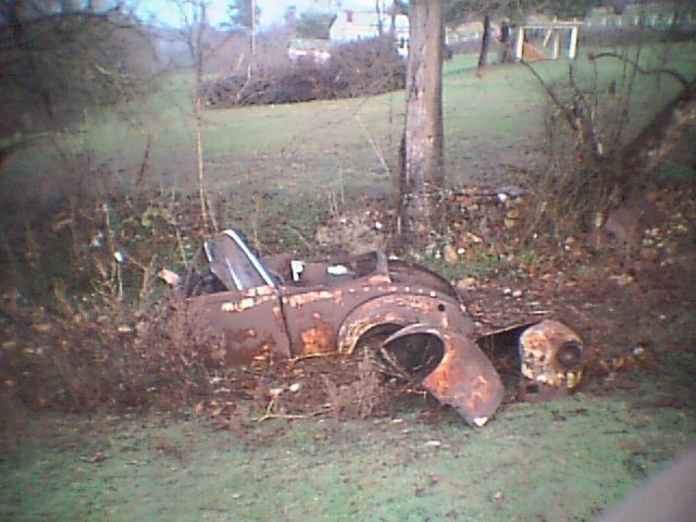

    after 20 plus years trying to buy this 40, the man finally let go,,maybe to late,, for the car n me,, need your input please,,, ill try to post some pics later, my junk computer doesnt seem to want to co-op erate, so the car is about 2ft away from the crusher,,cant do that,,so, i aquired a 40 2dr. sedan body, s.dakota,,rust free,, plans r to mount the sedan on my 40 conv. frame w/mounting kit,,and start cuttin,,n,, fittin??????? first question,, i want to use the cowl from the dakota body,, still intact to the rockers n floorpan,, ,good shape, need to use the top portion from the converible cowl,, looks like its 2 pc,, n spot welded ?? any suggestions? on seperating the 2 pc. cowl,,,its about one inch closer to the crusher,,,,,,someone hep me, hep me!

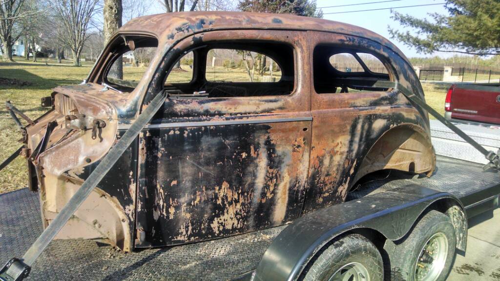

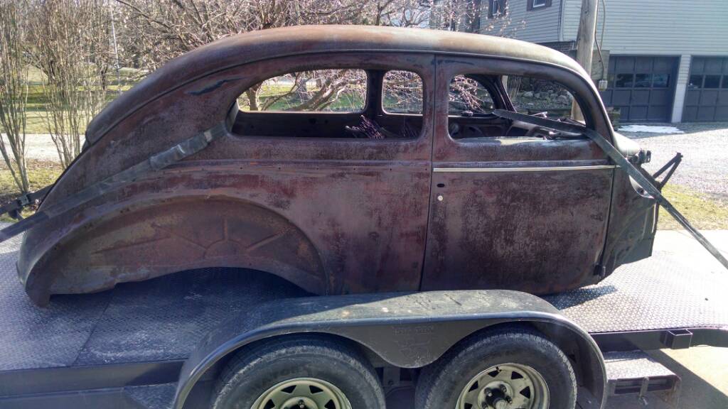

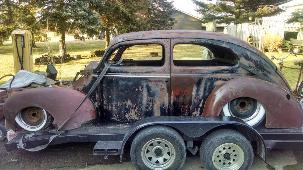

    Couple pics for ya

    Lots of work ahead of you but this should be interesting. The cowl is two piece and is both spot welded and bolted. They are not hard to take apart but require patience and several spot weld removals (firewall). All the welds are not obvious so keep looking when you think you have them all. The convertible cowls are scarce.

    thanks for the imput u guys,, mike,, i hope to have ready for the spinout????haha,,so tonite we drilled out lots of spot welds, removed a couple bolts,,then on the inside of the cowl there is a bracket,on either side,,and rite along those brakets there is a parting line, where the top portion of the cowl meets the bottom section,,more spot welds,,we looked it over n time was late so didnt go any further,, scott to post pics

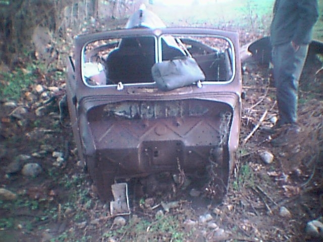

    This is what mine looked like when i got it. With a good 2 door you can do it. Like the other man said is you got a lot of the convertible parts and that's the hard part to find. I haven't started on mine other than building an engine and gathering up all the missing or bad conv parts. Good Luck!

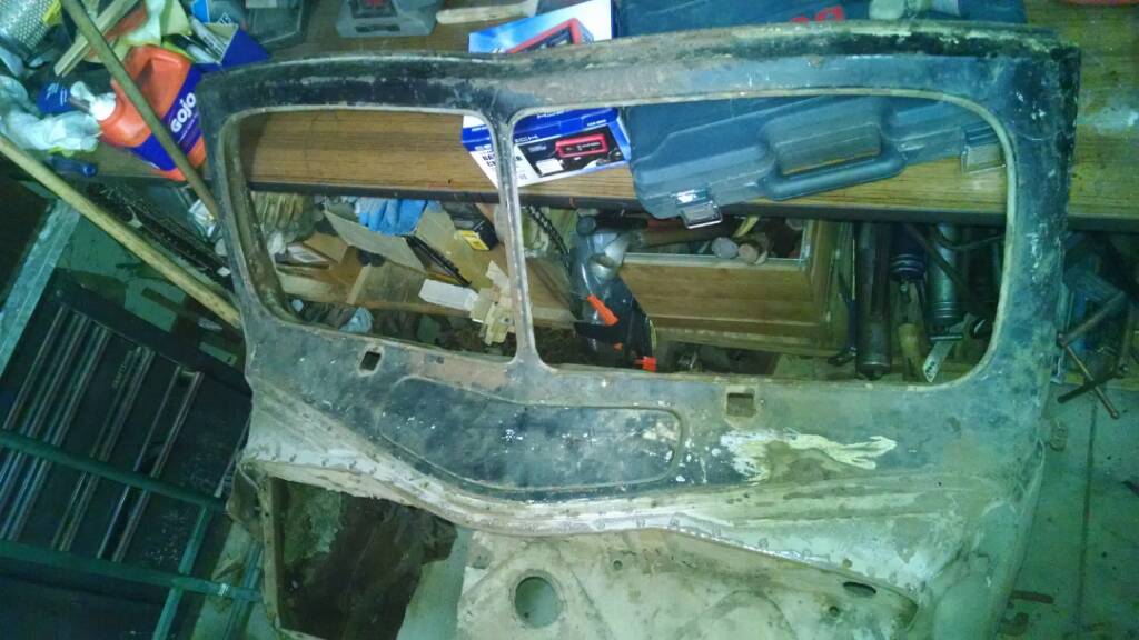

    Here's a pic of the new cowl. Plan is to separate the windshield frame from the firewall and weld to the sedan firewall.

    Brought the donor tudor body home today. some quick mock up work and it looks like a hotrod already
