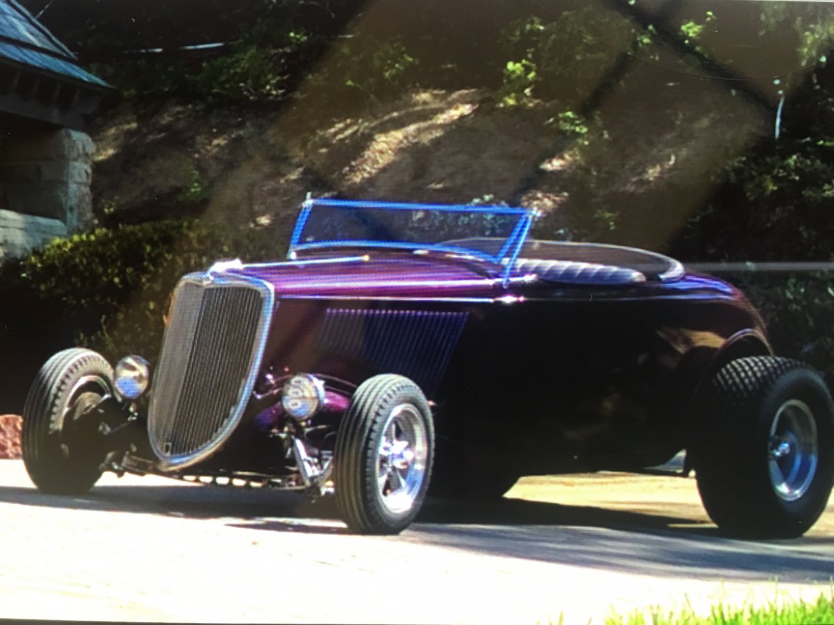

    I have been collecting parts for my 34 roadster for a couple years. I finally have a couple months to work on it and some of my other projects.

    I got a deal recently for a rear clip and 3 doors (well 2 1/2 doors) to go with my cowl.

    I got the cowl last year from a guy in Southern California, the rear clip and doors came from a friend in Northern California.
