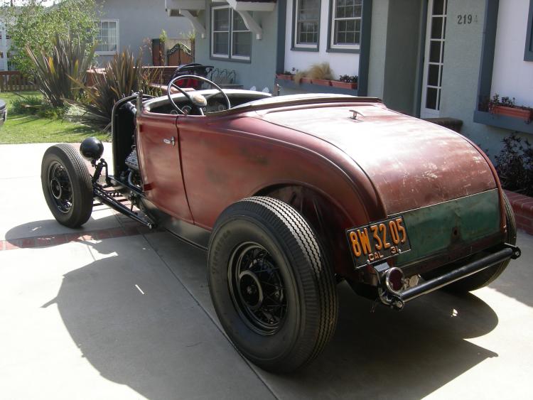

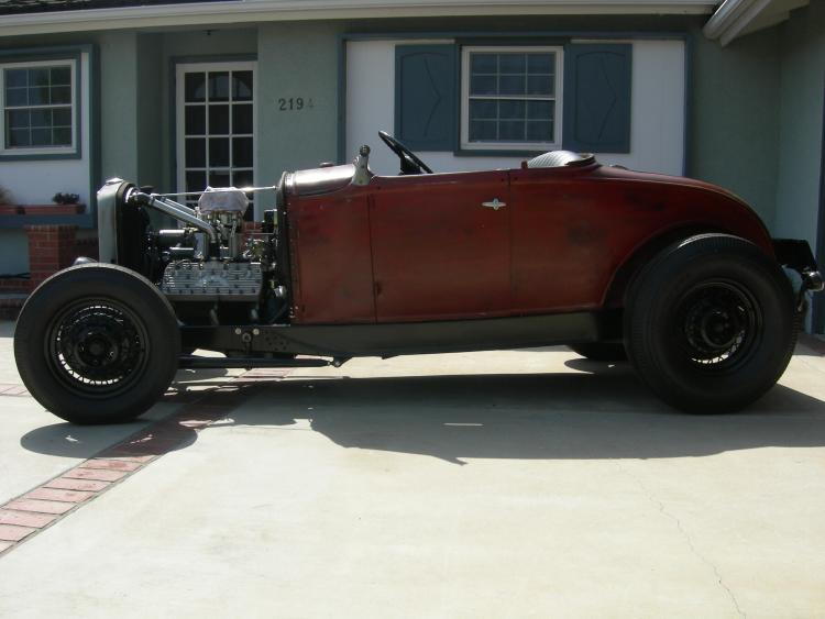

  24. This is my roadster. Patiently waiting his turn.

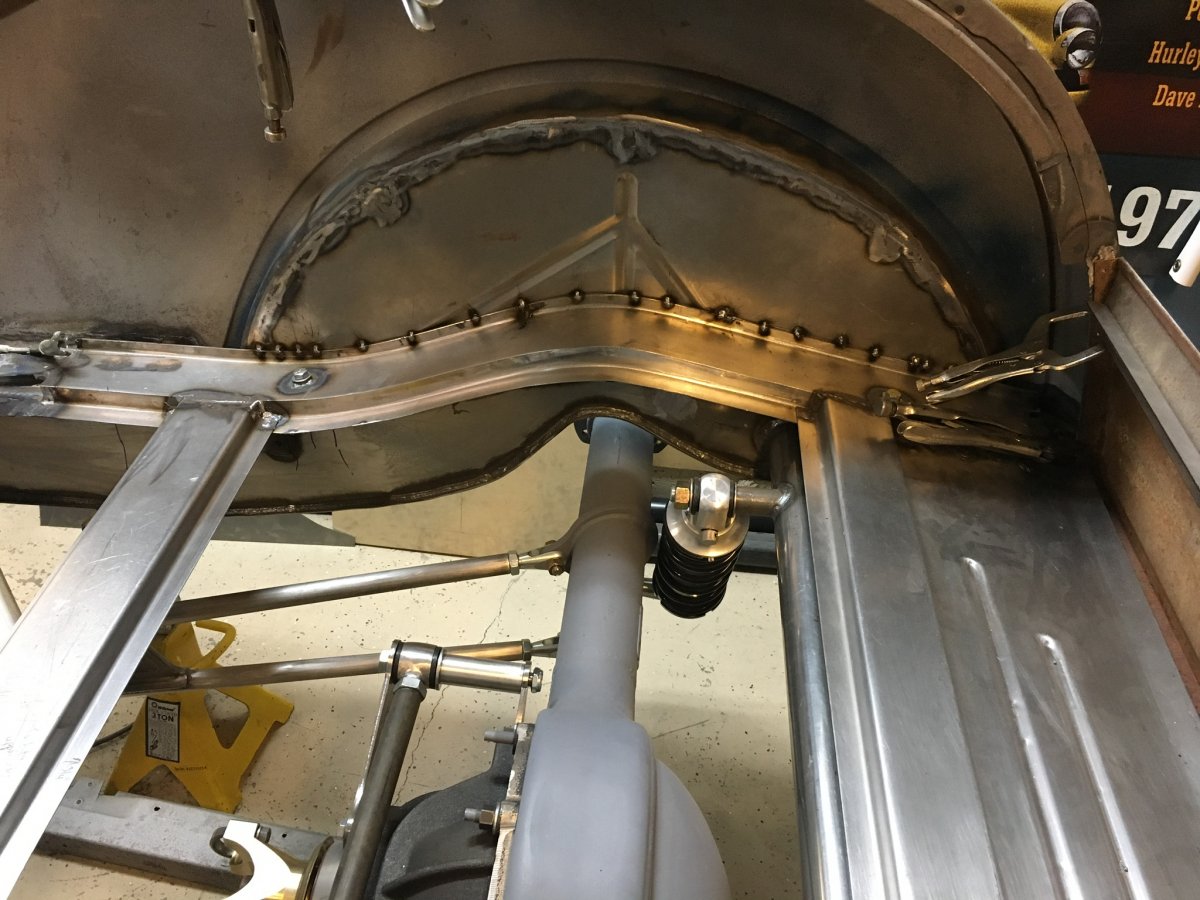

  26. IMG_5501.JPG IMG_5502.JPG IMG_5504.JPG Here are a few photos of my recent steadfast installation in my '31 (So-cal pinched '32 chassis). I raised all my cross members up level with floor rails- Lowers the body to hide the body to frame joint a little over an inch. So I didn't use Steadfast's small brace (plug welded some square tubing inside the joint of the old floor rails to the Steadfast).
    Just traced the chassis cutout profile to then transfer to the wheelwell. Welded the end of the vertical profile back in to keep it looking finished.

  28. Arnold, looks great. Thank you for that profile picture, it helps a lot
