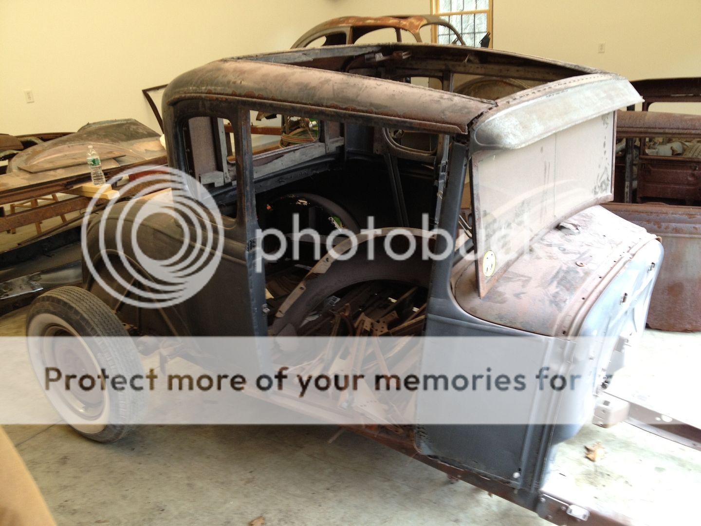

    The body still needs quite a bit of work, but its a good start. Here we are picking it up

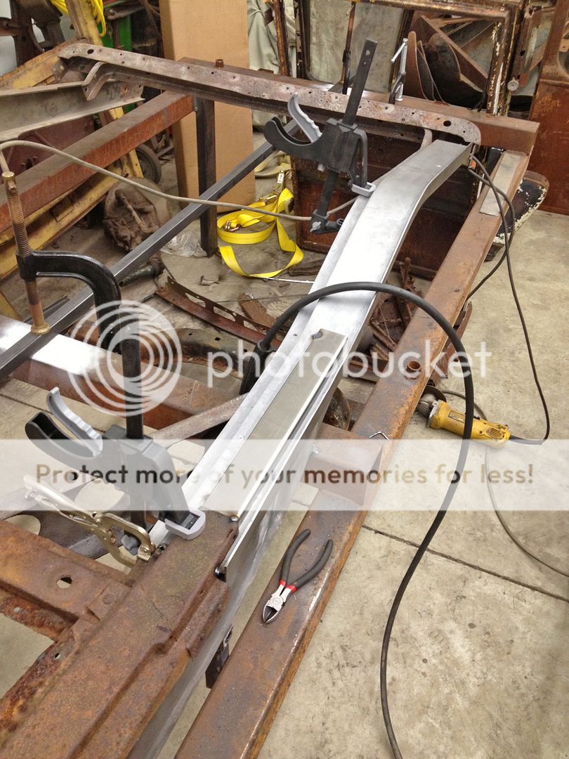

    We started with the rails. They were in pretty tough shape, especially the front third. We decided to replace the damaged sections. I drew the frame up in CAD and cut the new sections out on my CNC plasma.
    We then welded the pieces together and ground them up.
    Welded to the old rails
    After both rails were repaired and straightened, it was time to get them on the fab table and square them up.

    We got some more work done over the weekend. The front of the X-member is tied into the frame and roughed in and we started welding in the rear boxing plates
    A huge thanks goes out to Steadfast Mfg for donating the rear subrail kit and shipping it very quickly! I am really impressed with this kit. It is very high quality, fits like a glove and looks great! Thanks again guys!
    We started to install the subrails. Unfortunately, I only took one picture before my phone died. I will take more pics tonight
    After we got the subrails on both sides, we set the body on. The rear of the body still needs to drop down a little but its close. My buddy took one pic and sent it over to me. Sorry for the low quality, will take more pics tonight.

    Heres a couple more pics of the body on the frame. You can see how nice the Steadfast kit follows the frame and the inside of the body.
