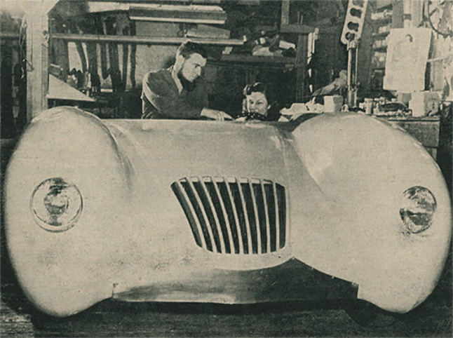

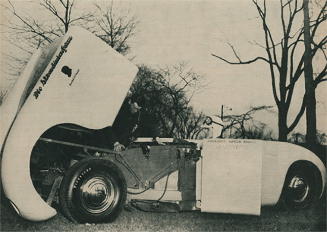

In any case, the two eventually stopped gabbing and got to work. The frame was widened 24″ and dropped 9. The “full-house flatty” was moved towards the center 24″, had a balanced crank, big valves, a Winfield cam, W&H dual coil ignition, 9.5 to 1 compression (damn! – Ed), and a homemade intake to fit the four dual-throat carbs.

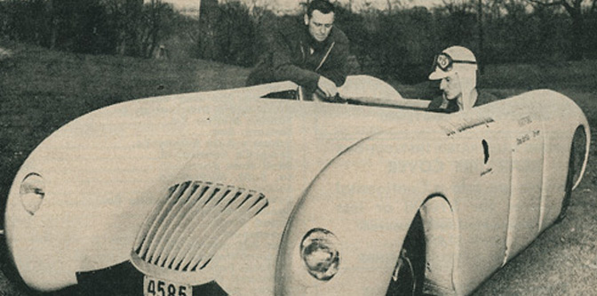

And how bout that body? It was completely hand formed using 16 and 18 gauge cold rolled steel. Over 39 sheets of that steel were used and there were approximately 140 feet of gas welded seams. It was all finished with 32 coats of “Sahara Sand” lacquer. The end product was 13′ 5″ long, 70″ wide, 35″ high, and weighted in at a portly 2200 pounds.
