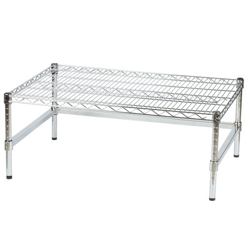

  18. I hear you, really I do.
    So answer me this,
    See this wire rack,
    It's USA made, chrome plated finish, 24x36" - on sale you can buy this for $58.00.
    Now why does just the chrome job on a 33 or 34 grill go for over $1000.00 on a pristine example?
    Volume on the wire racks? Ok-
    How many grills do we need to do to get the price for chrome on them down to 100.00 ?
    Cosmo49 likes this.
  19. stanlow69
    Joined: Feb 21, 2010
    Posts: 7,348
    stanlow69
    The people who built that $58 rack ride bicycles to work and get paid $4 a day.
    bondolero, BigChief and GOATROPER02 like this.

  22. So what's the difference in process between chrome plating wire kitchen racks and fresh steel 34 grills?
    I'm NOT being a smart ass either.
    Just some tough questions I guess.
    I would assume, the adhesion process, the material transfer process, any curing baking polishing process would be the same. EPA regulations, material costs, nickel cost, dump fees, insurance all the same. Overhead, rent, electric bills Etc all the same at least per region and a regional cost of living factor included.

    Seriously? Look at the kitchen rack next to a nicely replated bumper and you will see the difference. The kitchen rack has no shine or depth or reflectivity at all. It just has a light flash coat, no buffing, no triple plate, etc etc. (I have a repro bumper on the front of my '53, a rechromed original on the rear, and that exact same rack in my basement so I know exactly what I'm talking about.)
    There is no comparison at all.

    The shops that do the large wire goods have huge tanks, sometimes with computer controlled hoists and high speed plating baths. You wouldn't believe how many racks per hour they can do. All the steps in manufacturing process takes into consideration the finished product. Special wire, welders etc. The parts are not polished. Put them on a rack & run them down the plating line as fast as possible and still have a product that looks good. Have you seen one of these racks that sat outside? At the junction where the wire is spot welded the plating is not very thick and it will rust. Racks that go into coolers in restaurants are clear coated.

  29. That rack is probably hard chrome,no nickle or copper. HRP
