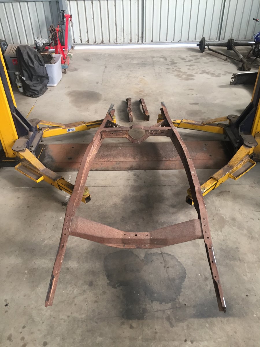

    This was the day I dragged it into my shed and decided to make a start.
    I had been collecting parts for a while but this is what I consider the starting point.

    I had hoped to be able to use the rails. But then I discovered they had not been massively pinched but torched off and welded back on. If I really wanted I could of reclaimed them but having a big repair on both sides at the cowl didn't please me, especially considering I wanted to have an unboxed frame.

    So with the help of my oldest son we removed the centre and rear crossmembers and I bought some aftermarket rails as well as a new lower front crossmember.

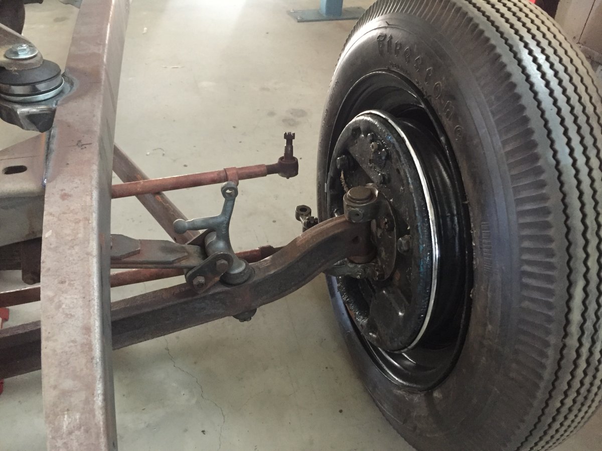

    I washed up and had 2 sets of 40's wheels blasted then made a set of 2 4" wide and 2 4.5" wide. I painted them black enamel and added a body colour thick detail line.
    Pulling the stuck perch bolts then assembling the front end for a mock assembly. My oldest helping me with spindles.
