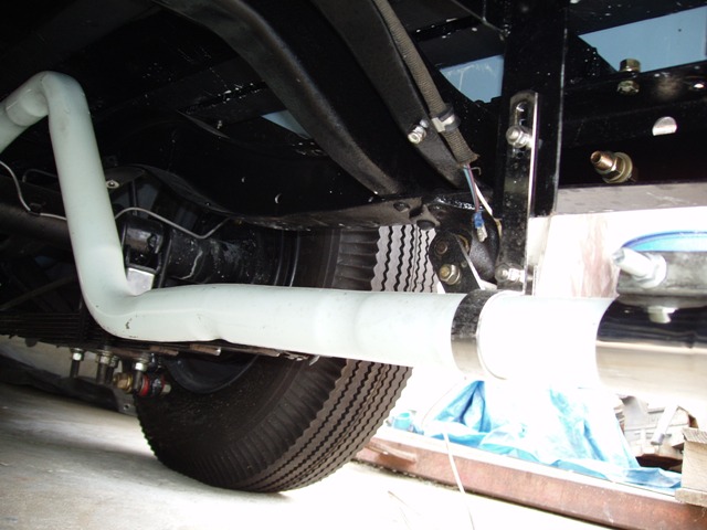

  23. 53chevy
    Joined: Mar 5, 2001
    Posts: 1,570
    53chevy
    I went the stailnless route. I used lake pipe hangers from Moon and fabed all brackets that bolt to the inside of the frame for the exhaust. the hangers I got from a company back east that have everything for exhaust systems. They make these bands when overlaping the pipe to secure them. Before polishing, I took the tail pipe to a muffler shop to expand the end to slip over the other pipe. This gives the best way to set up your tail pipe in relation to the bumper. Alot of em are pre-cut and need to be welded or screwed on. Hope this helps!
    Ken
  24. HELLMET
