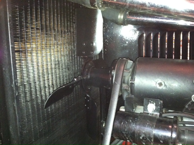

    I'm mocking up my flattie and need to work out some interference issues.
    I want to run my fan off the generator if possible. The fan I have is a '37 I think and with this fan the blades would hit with the radiator connections as well as the magneto. Also, once bolted to the generator pulley, it looks like the blades would be about 3-1/2" to 4" away from my radiator.
    That being said, I am looking for another fan with a smaller blade diameter and a longer hub length. I think I may need a '32 fan based on some pics I have seen but not sure. Can anyone give me hub lengths and blade diameters for the various generator mounted fans?

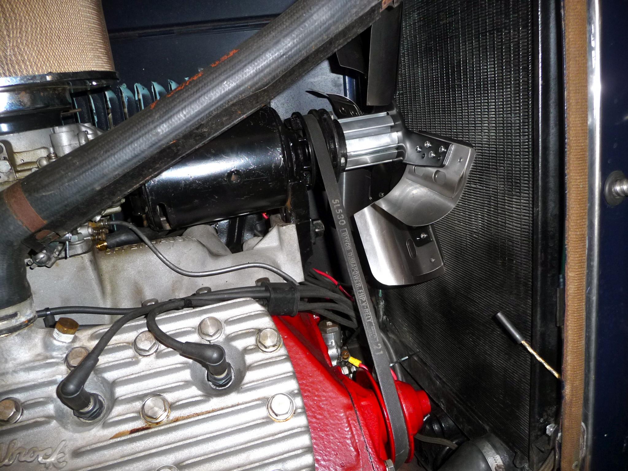

  13. Groovybaby6
    Joined: Dec 29, 2008
    Posts: 810
    Groovybaby6
    from Denver
    I had a similar problem but I have a stock distributor on my '32.
    I ended up using a '38 pickup 4 blade fan that I took to a machinist friend of mine and had the shaft shortened because it was too long to fit between the generator and radiator.
    He also had to cut down the blades to clear the hoses.
    Here's what it looks like.
      149.2 KB
      420
  14. Junk Hunter
    Joined: Feb 1, 2010
    Posts: 290
    Junk Hunter
    from The Ozarks
    Here's a better profile pic of what I've got with my current fan mocked up about where it is going to need to go. This fan is about 15 3/4" in diameter. Going to need one that is about 13 1/4" diameter max but I'll trim and balance if I need to. Based on the comments, sounds like a truck or tractor fan with a longer hub might be what I need to be looking for...unless I stumble upon a '32 fan.
