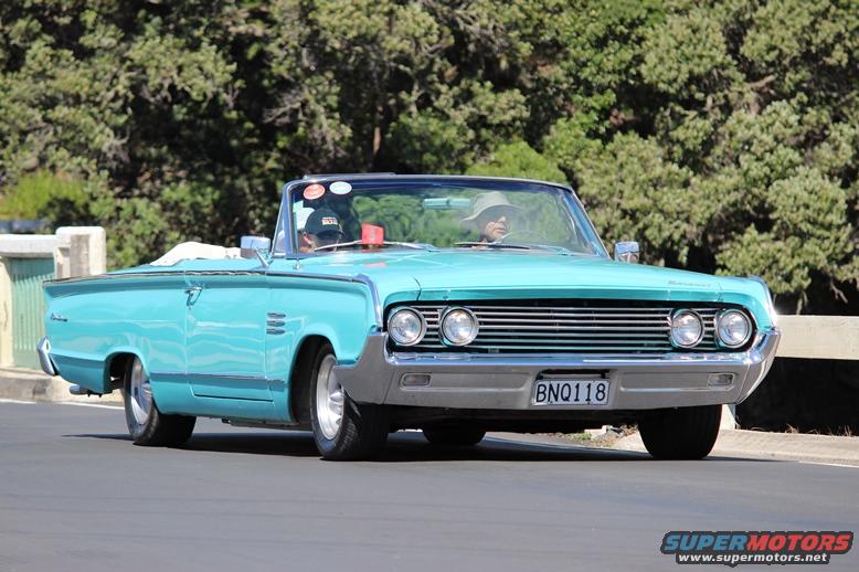

    I've been thinking about making a tube grille for our 1964 Mercury convertible for a while. The original grille is a stamped aluminium affair with vertical bars. The design is fussy, and the blacked out areas really needed repainting.
    I don't have a good before pic, but this one shows the grille reasonably well. A complicating factor is the quad headlights. I designed the grille to use the existing headlight surrounds. This means that the new bars follow the same V profile as the original, both vertically and horizontally.

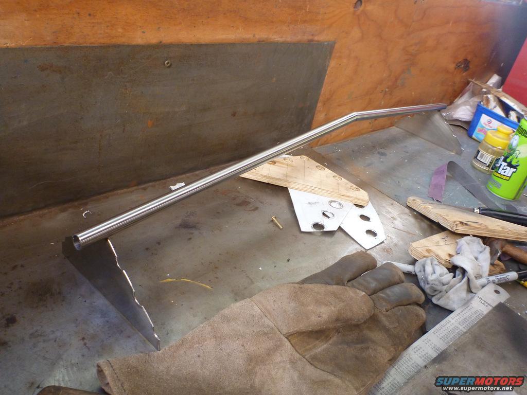

    After checking out some tubing sizes and looks I settled on a 7-bar design using 5/8" (16mm) stainless steel tubing. I made some plywood mounting brackets to test out the look.
    When correctly assembled the headlight bezels cover the ends of the tubing.
    After sourcing some tubing and cutting to the correct lengths (the usual measure twice, cut once routine) I made a template (with the small holes) then used this to create a couple of mounting plates from some stainless steel sheet. The larger holes were drilled with a unibit.
    Most of the holes where then cut off with a Bosch shear to leave this shape. The small cutouts were a bit help in locating and aligning the tubing.

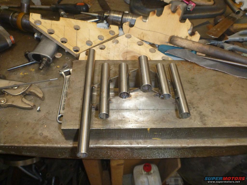

    For these short pieces I also used the plywood brackets for alignment when welding.
    The tubes were MIG welded to the mounts. I didn't have an SS wire handy so just used the normal steel MIG setup - hopefully this won't bite me in the ass later.
    Due to the stepping spacing of the headlights (that matches the overall V at the front of this Mercury) the mounts are not at 90 degrees to the tubing.
