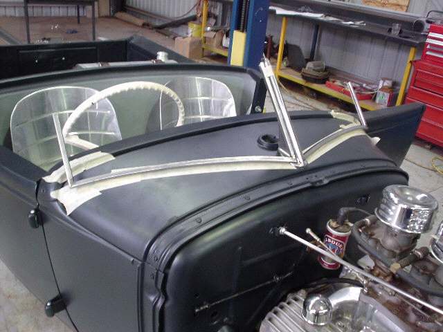

    heres my attempt at a duvall/hallock type screen on my RPU.It will have no frame along the top of the glass.
    will explain it in the order of photos, i hope!
    1st shot is the stainless u section , Go find an early falcon wagon, the tailgate glass has a perfect section for this job as a top finishing strip, its on there with a rubber seal, if the seals good you can use that too. Now go and find ANOTHER early falcon wagon..coz u need two.
    I had cardboard patterns of the basic shape already so i knew the angles, cut out a V in the channel and bend and tack.Mke sure the angles are identical on both pieces.The curve in the cowl is easy to bend in, just do it slowly and check the fit often
    Next i mucked about with shapes for the centre pillar in cardboard,was going to put a hole in the upright but my minimalist streak won out, so no hole.
    Then I gas axed the pieces out of 6mm plate, ground them to shape, and flipped the bird.
    next shot of the piece in the vice shows the two thin strips that act as locators for the stainless strips, and give the piece some shape and tidy it all up..this will make more sense later.
    Last two shots are it all together so far..the stainless strips will be secured to the centre post with little countersunk screws that go inside the channel before the glass goes in. the centre pillar will have 1/4 inch fine thread tapped in and bolts up from under the cowl.
    I havent figgered out the outside posts yet as you may have noticed..thats saturdays job.Will update it then.
    The only tools you need for this is a mig, and angle grinder and patience.
    I love my Metabo 5 inch grinder..it built my hot rod single handed.

    okey dokey, next bit..
    First shot is the frames bent up and tacked, then cut to length, hallocks that kinda go up and out towards the sides, have a kinda 'jaunty' chitty chitty bangbang look, didnt want that.not that theres anything wrong with chitty chitty bang bang...the first car i remember.
    next is the ubiquitous cardboard pattern, went for a teardrop shape to follow the curve of the tank into the cowl strip.arty huh.
    next are the patterns , and cut out bits of plate. Fuck you.so i cant control a gas axe to save myself..at least im not fakking on about '32 values.
    Then had to bend the teardrop to fit the cowl curve..tricky as its a compound curve...heat, bend, fit,heat ,bend ,fit blah blah
    next is the welded and ground bit in place...wasnt that quick??
    here are the two side pieces nicely set off against a lovely striped panel given to me by Whodaky..Thanks geoff!
  18. lowsquire
    Joined: Feb 21, 2002
    Posts: 2,567
    lowsquire
    from Austin, TX
    aaaand... what it looks like now.
    there is a bit of wire to approximate the top of the glass
    last two shots are it all precariously set in place with vise grips and masking tape...nope still not finished..have to drill,tap and mount it all tommorrow then make patterns and get the glass cut.
    Thats a fairly solid eight hours work..im not very quick but what else do you do on a rainy shitty saturday on the farm.
    Ill be picking up the Jet Hot coated lakes pipes monday, and driving it tuesday i hope...completed shots then.
