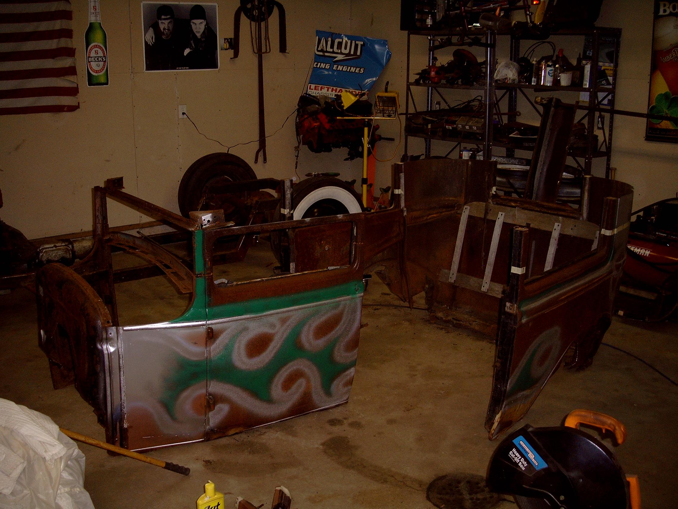

Absurd yes, I had my doubts for sure.
The little A, I'm clearly doubting myself again, in this picture
Pic by Tim Sutton

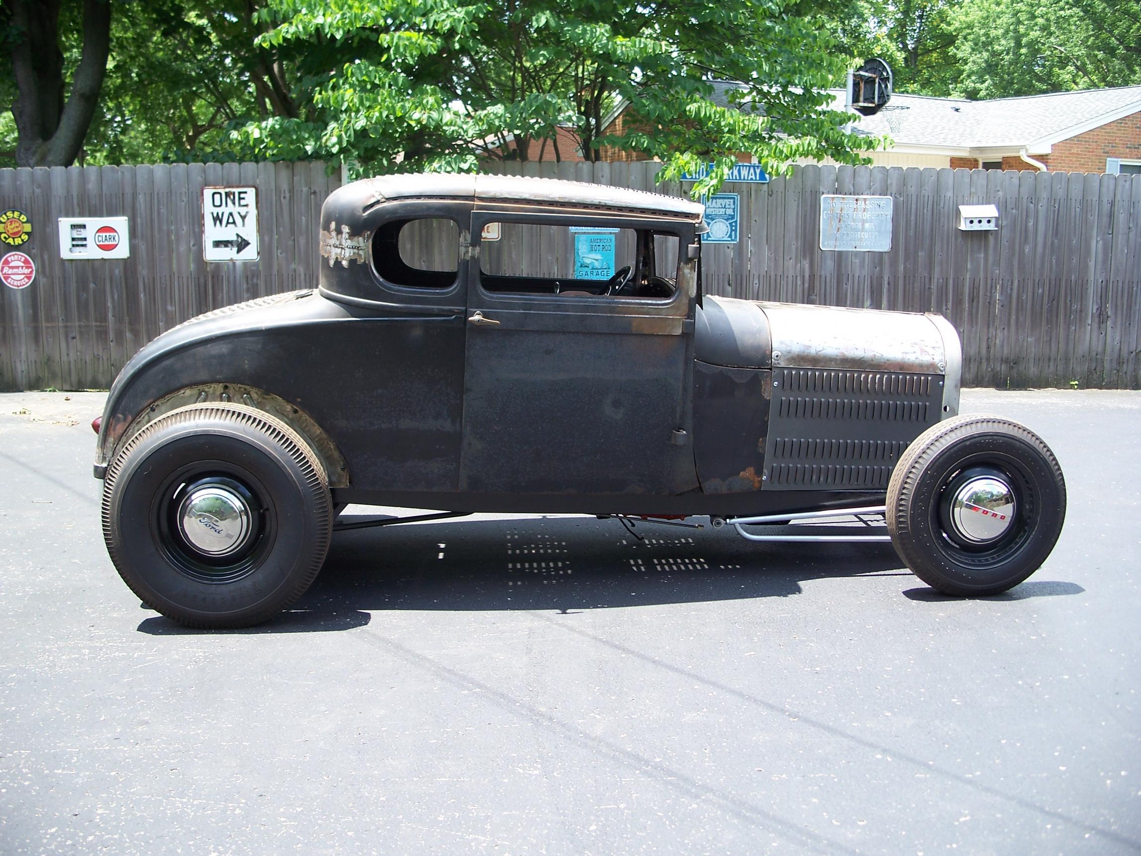

about 2.5"

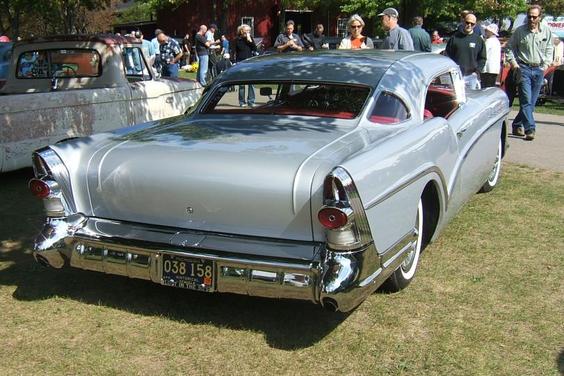

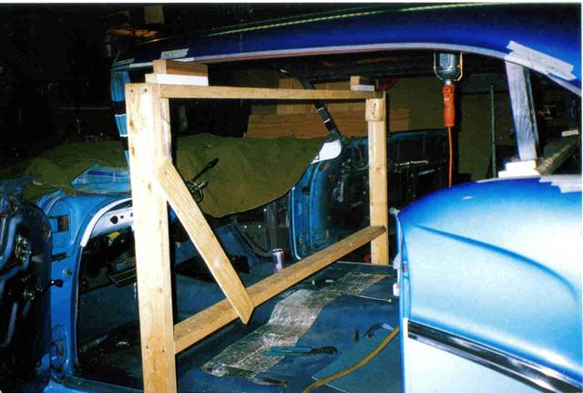

When I chopped my 57 Buick , I didn't have 5 helpers
so made a wood a-frame to hold it up.As the chop
was to be 2-1/2"a block that size was add to the a-frame.
After the a and c pillars were cut and reworked the
blocks were removed and top lowered .
TwoChops

2 1/2" is a perfect amout looks great

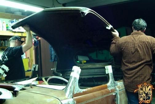

...the moment....
...scary time....5 1/2" front, 7 1/2" rear...

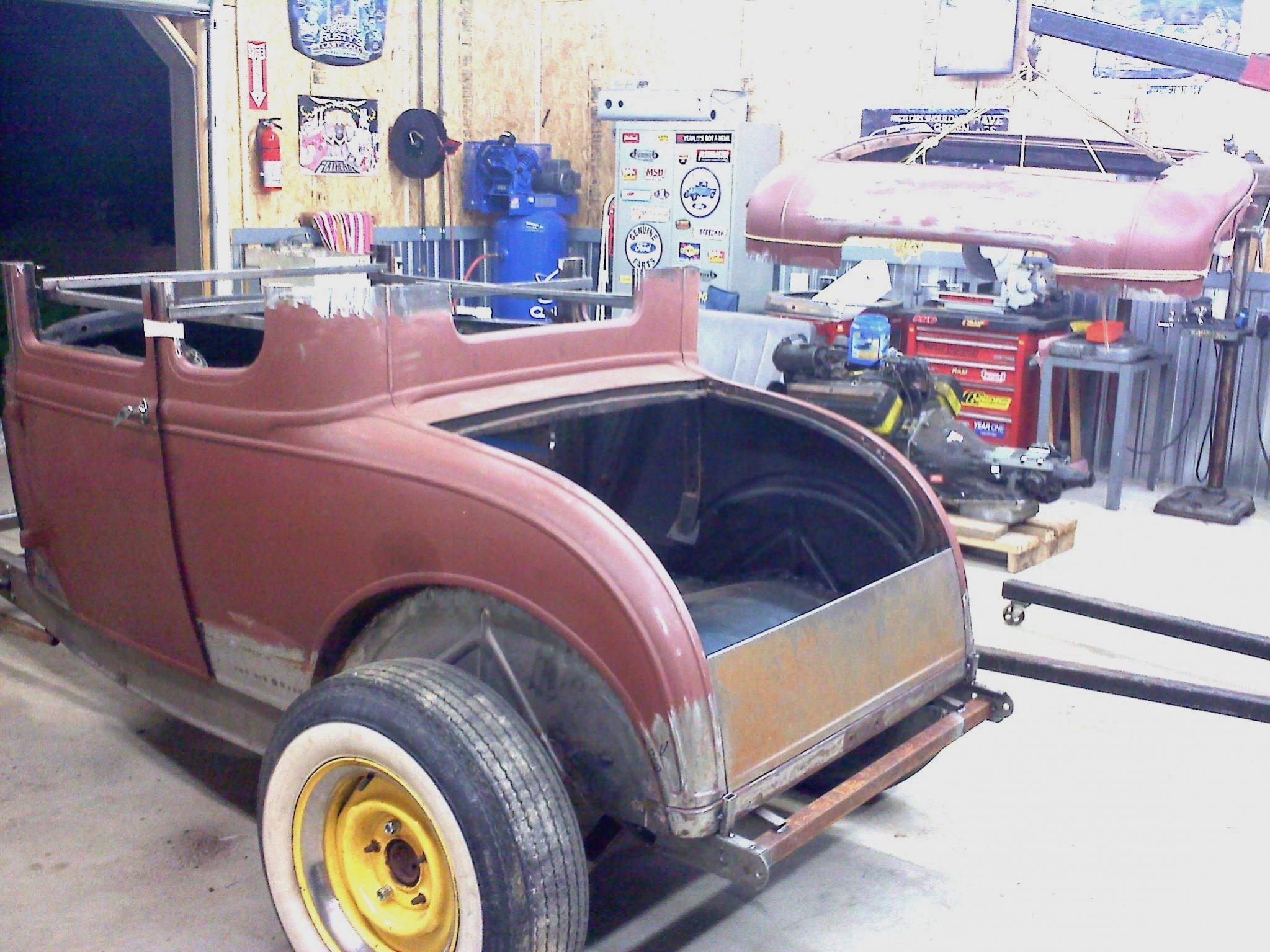

My son helped me chop Rob's A.

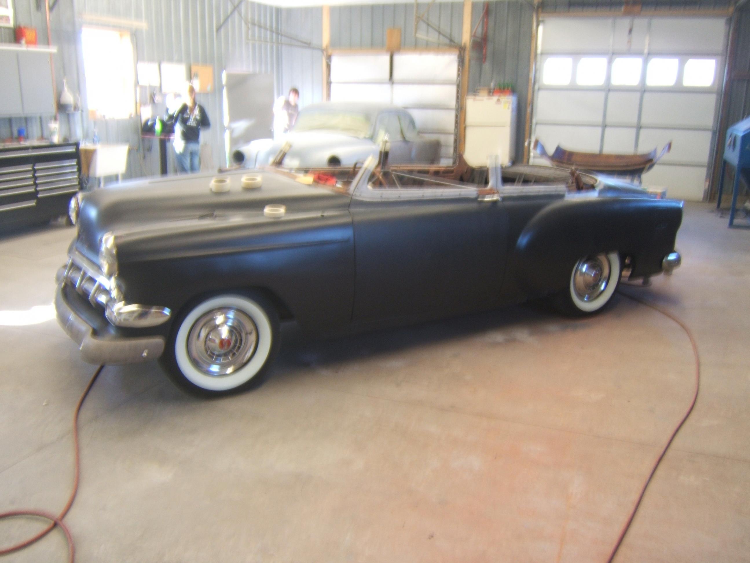

a few years ago... chopping by friend's 54 chevy.
