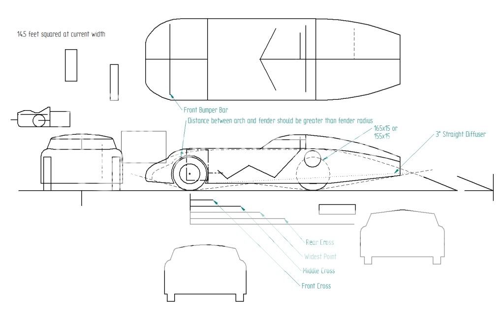

    I'm still carving away at my drawing:
    I've put the cockpit back a little and altered the front. What I'd really like to do is get it solid-modelled and run some CFD on it, it's the little tweaks, especially around the rear, that could make big differences to how streamlined this thing is.
    For headlights, I reckon I can use some sealed beams hidden behind flush-fitting clear covers screwed into the body work. The shapes are all pretty simple to hand form, the most difficult being the fender 'pods' covering the top of the front wheels. They're not really necessary but without them the car is a bit featureless. I think it'd look a lot like MGs EX135 and EX179 but with the two person cockpit stuck on top.
    There are a few reverse curves and a few compound curves but because everything is rivetted together (and to a frame) I think I can tackle them individually without screwing up a massive single panel.
