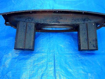

    A long while back I acquired a mid 1930s Packard limousine dashboard.
    I really loved the elegance of the gauges and glove boxes, but had been thinking that it would never fit in a Model A. It's a really big dash meant for a big car. Below you can see how long it is compared to a coupe dash rail.
    I also made that cardboard panel to size so I could see what it would look like in a Model A. TOO BIG.

    First step was to cut up that dash. I was a little bit nervous here, but it's only metal, right? What we are after is the center section out of this dash.

    were those just long gloveboxes?
  13. Long gloveboxes, no little doors. The original gauge tunnel fits inbetween back to the firewall.
