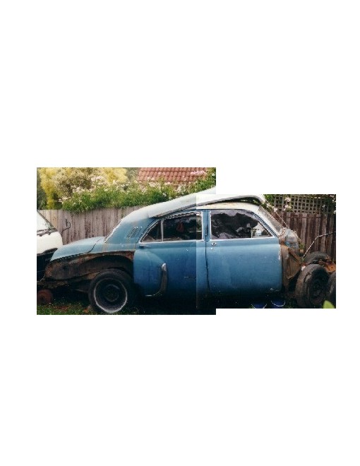

Hi Darren...The Caddy was originally a 49 fleetwood... was on its way to the crushers...Probally the only one in Australia..maybe a embassy car as it is RHD.......Chopped the top 4 1/2" at the front and 5 1/2" at the back to get stance flow...Have been plodding along on getting the left door finished...had to stretch it to make a two door..and shift pillar back...it all ties in with replacing the sill (rocker panel) and all the related sheet metal fabrication from the dog leg to the hinge pillar which had to be rebuilt as it was all missing or cheese with rust...I'll post some more pics in my album in the next few days........Doug

So what's with all the marks on the top of the Buick if you are not going to chop it...former owner...?
I'll be watching this one as I have a '48 Caddy sedanet in my shed awaiting...
And Morac41, I'm interested in yours as well...is it going to be a hardtop or a post car when your done...???

Hi.. 40 Studedude...Have moved the post back...big job to make it a hardtop...I like the post look on a chop top....check out my album for some of the build so far....Doug

here is the right hand rear quarter, as you can see a pretty ugly repair form the previous owner, not to sure what he was thinking welding a patch over the panel bolt holes. i am going to cut this out and start again.
cheers darren
