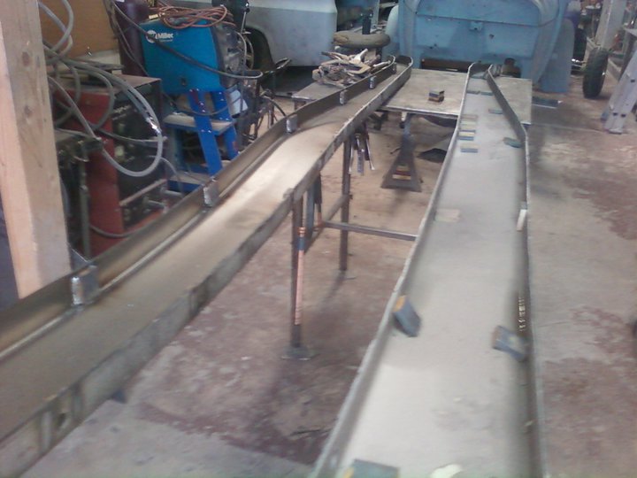

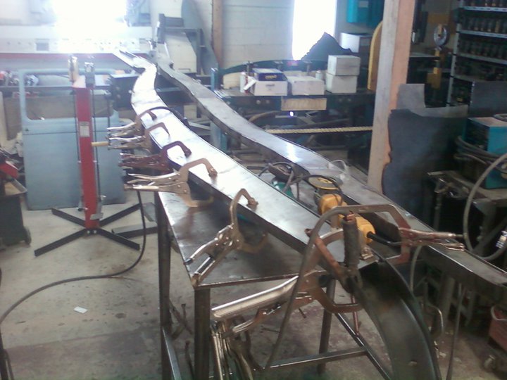

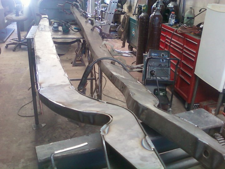

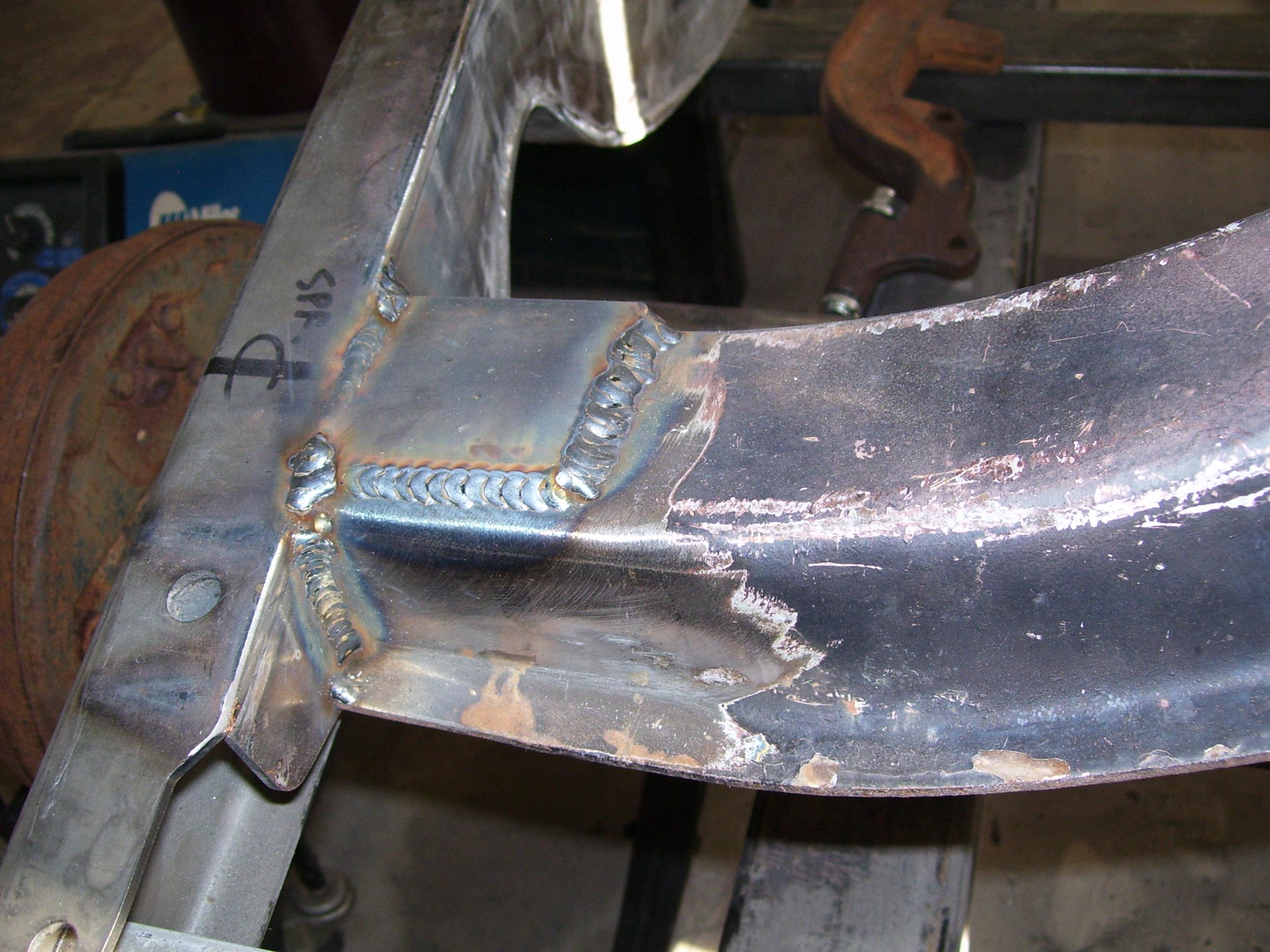

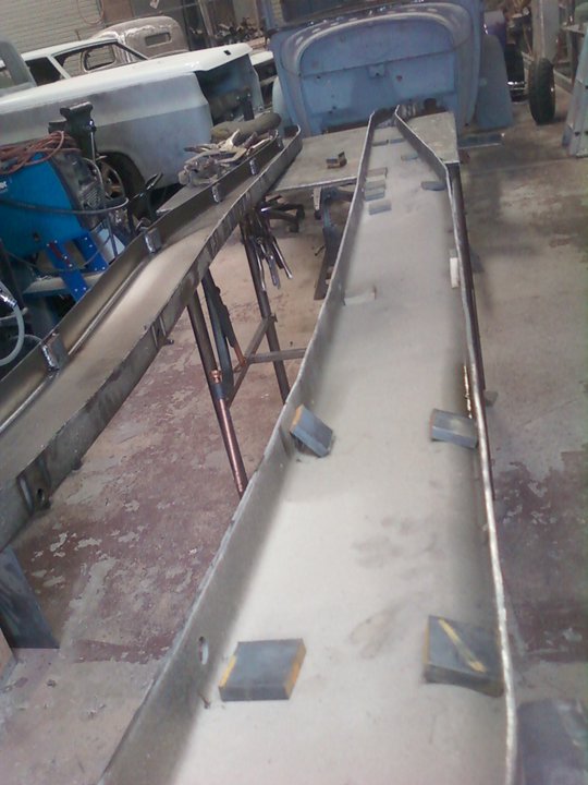

First off we make and cut all these little spacers to set the boxing plate depth. Weld them in like so...
Then tack in and weld the plates.

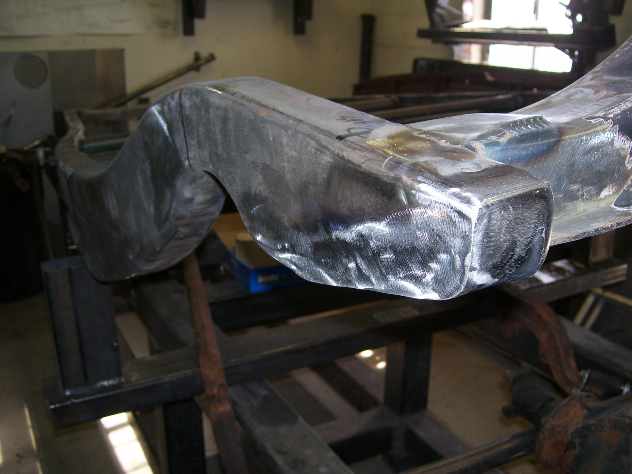

We did this at my friend's shop, Wild West Rod and Custom on his jig.
This is me grinding the welds down nice....

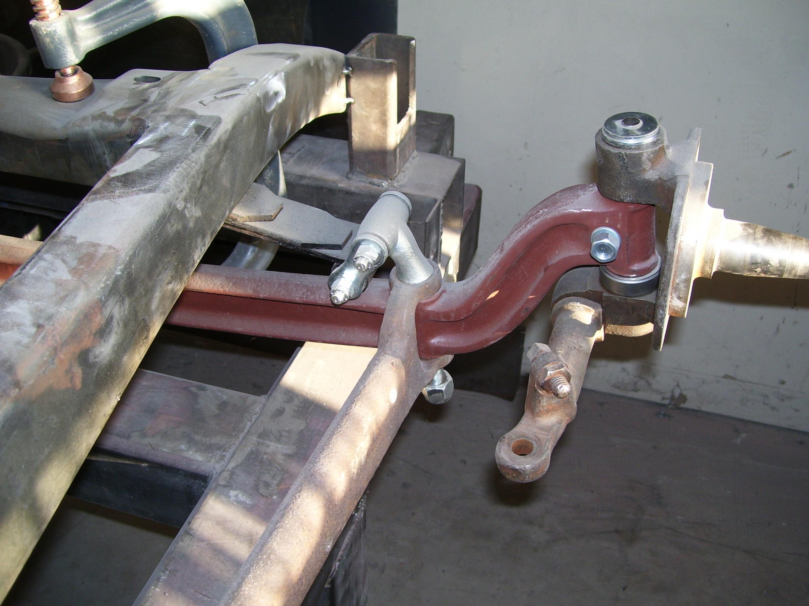

Default Re: The JOHN KENNEDY build thread. My '29 sedan on '32 frame

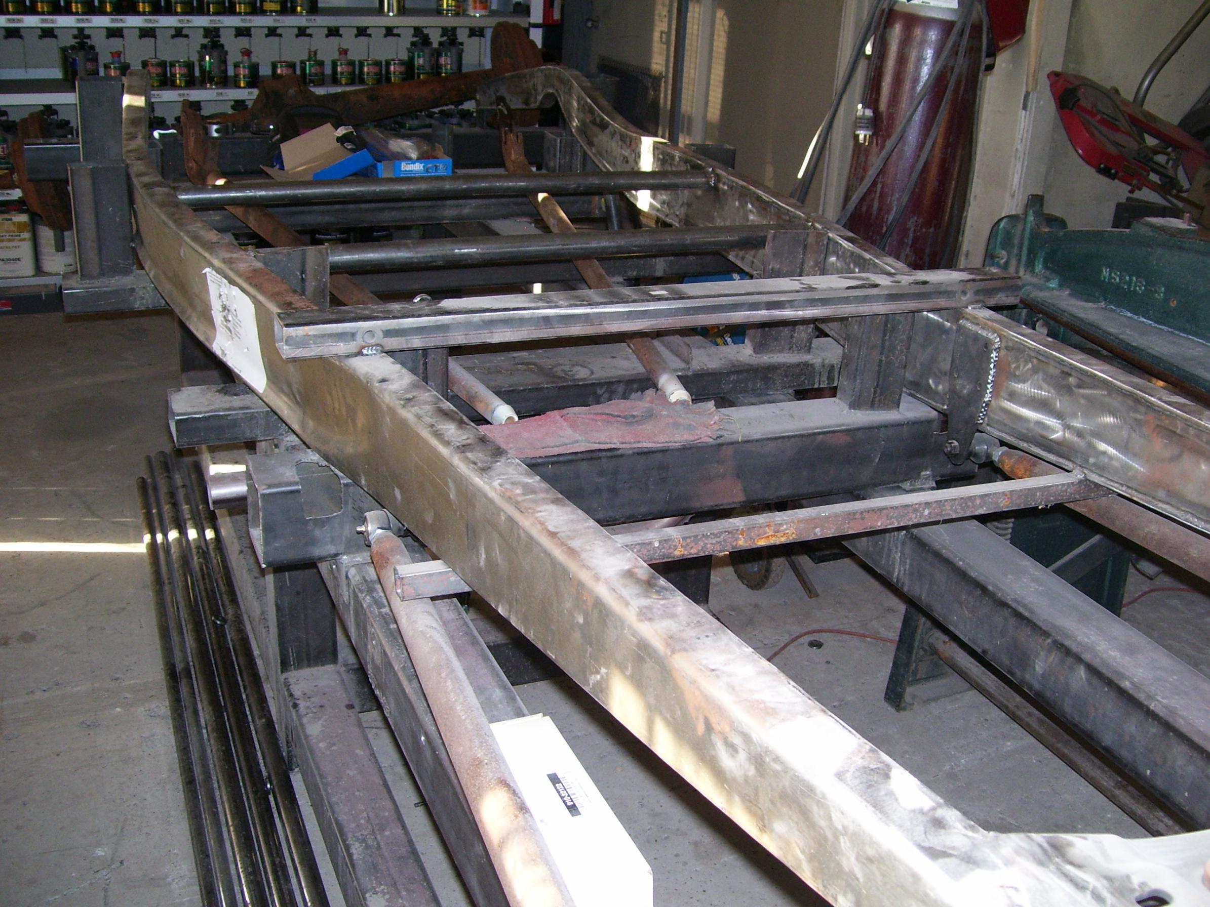

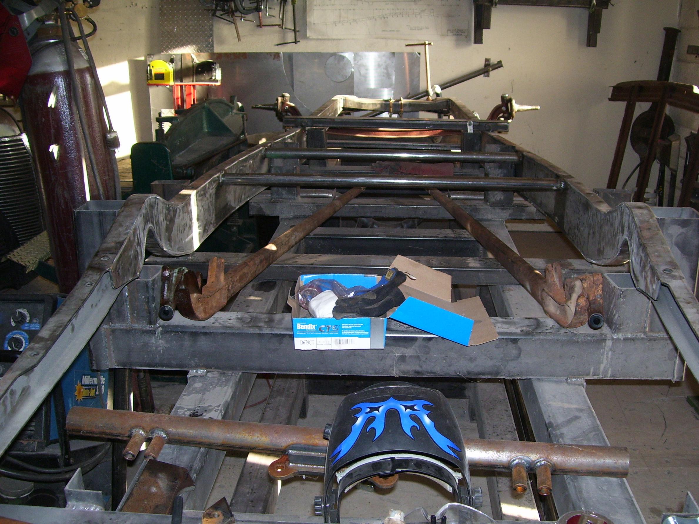

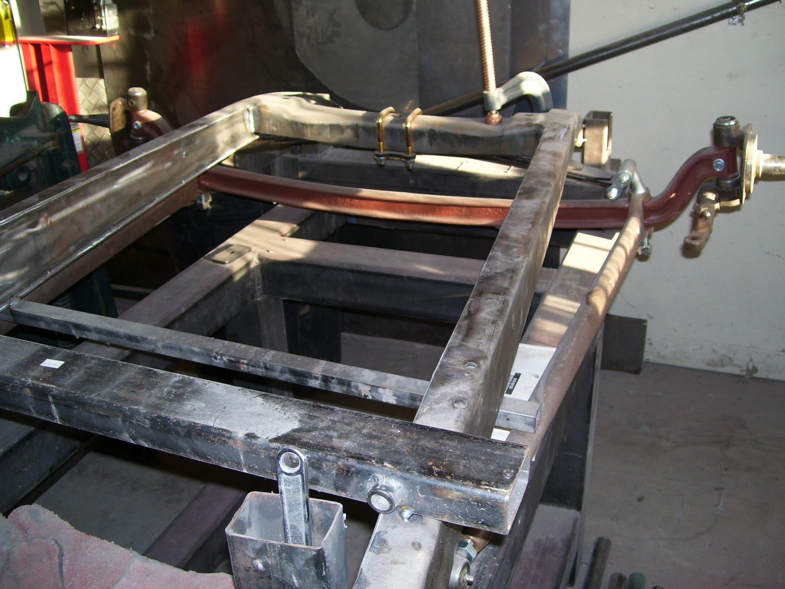

Kind of jump forward a bit here. Got the frame attached to the jig, started on the model A front crossmember. Then attached the spring and Ford dropped axle purchased from HAMBer 296V8 here - he's in the HAMB-0-dex if ya need a good axle.
Also added some F-100 spindles that I rebushed at home...

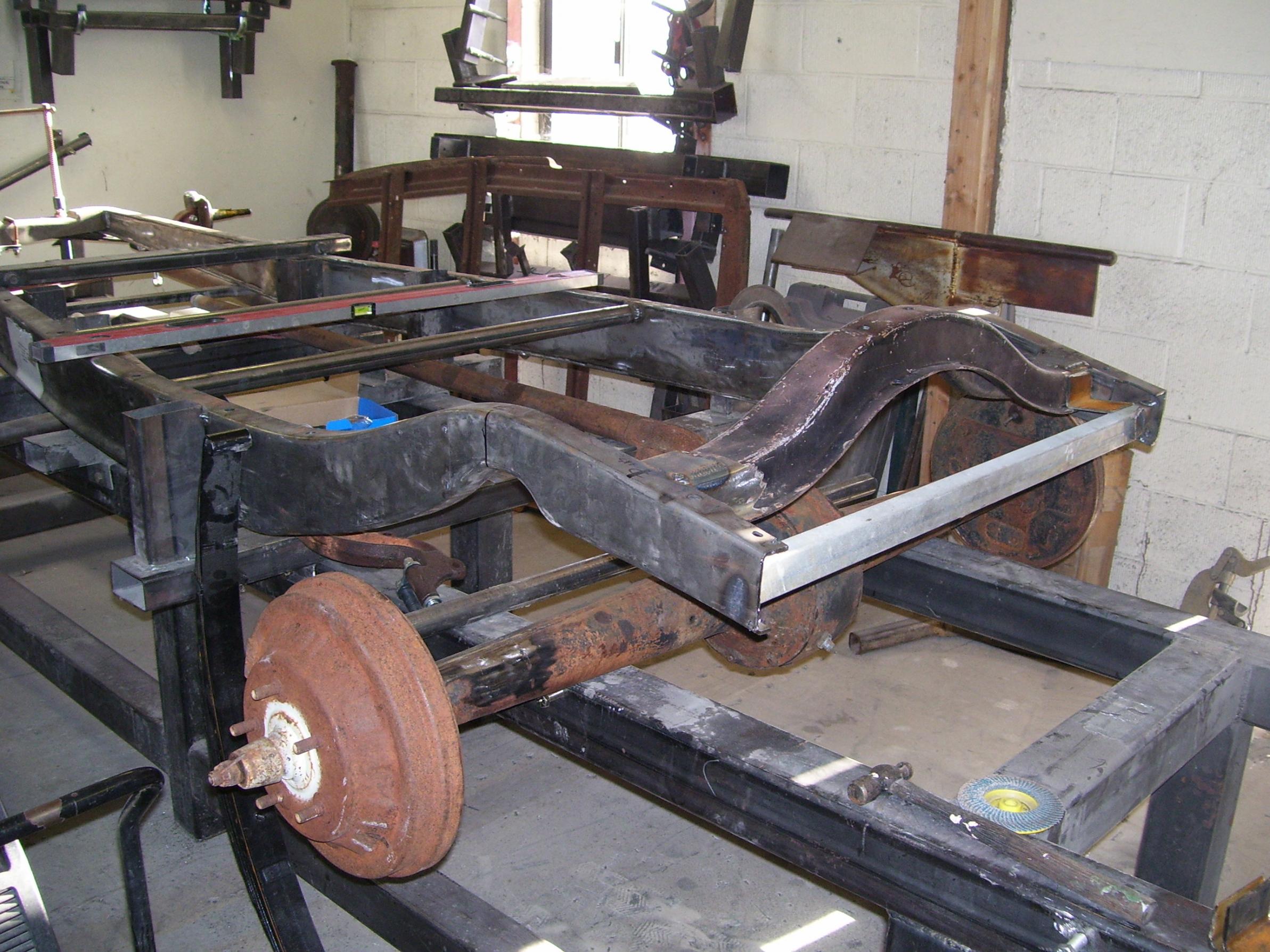

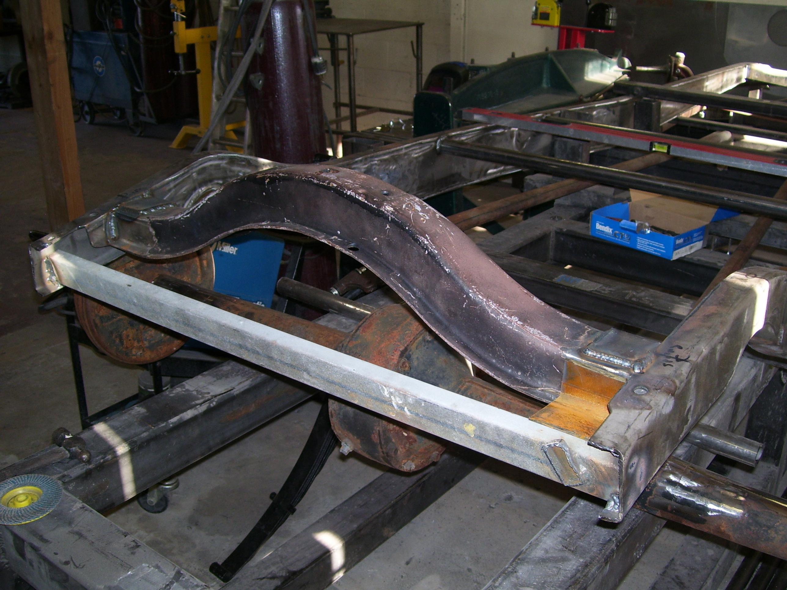

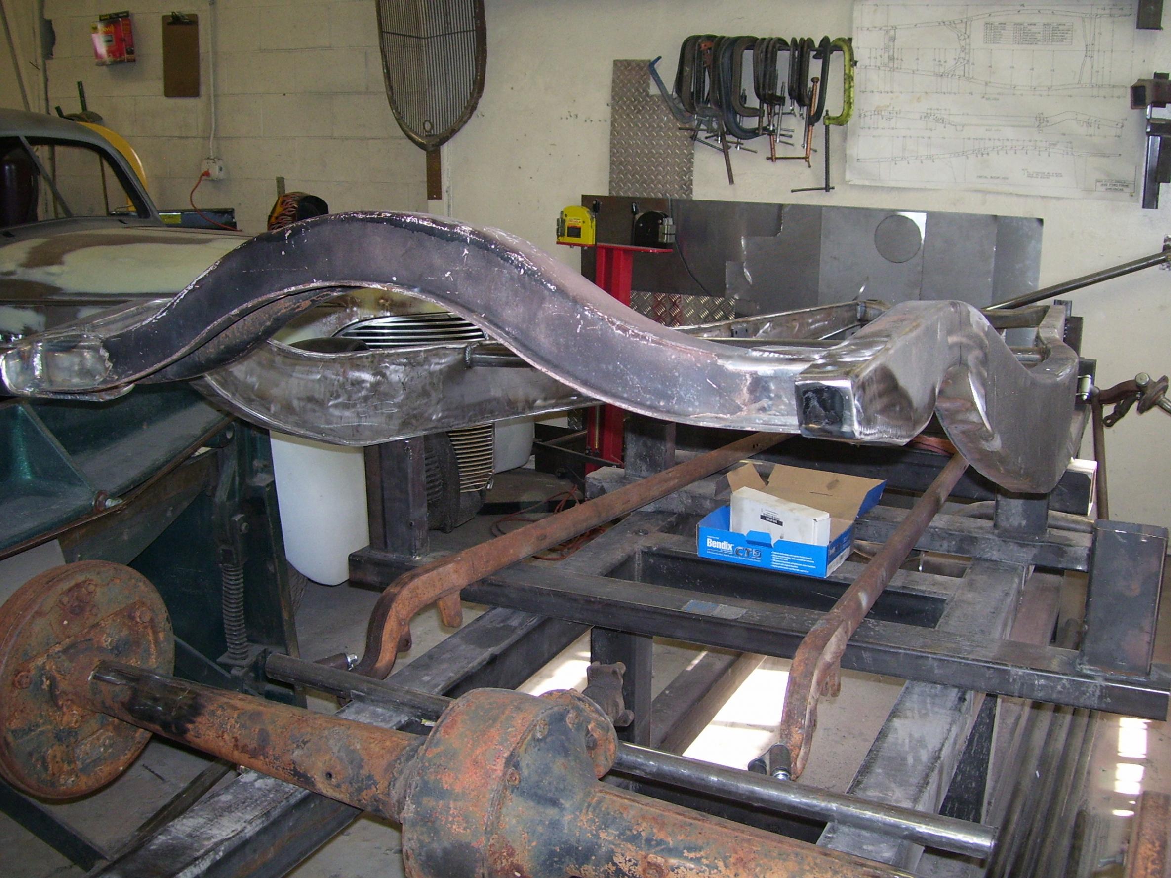

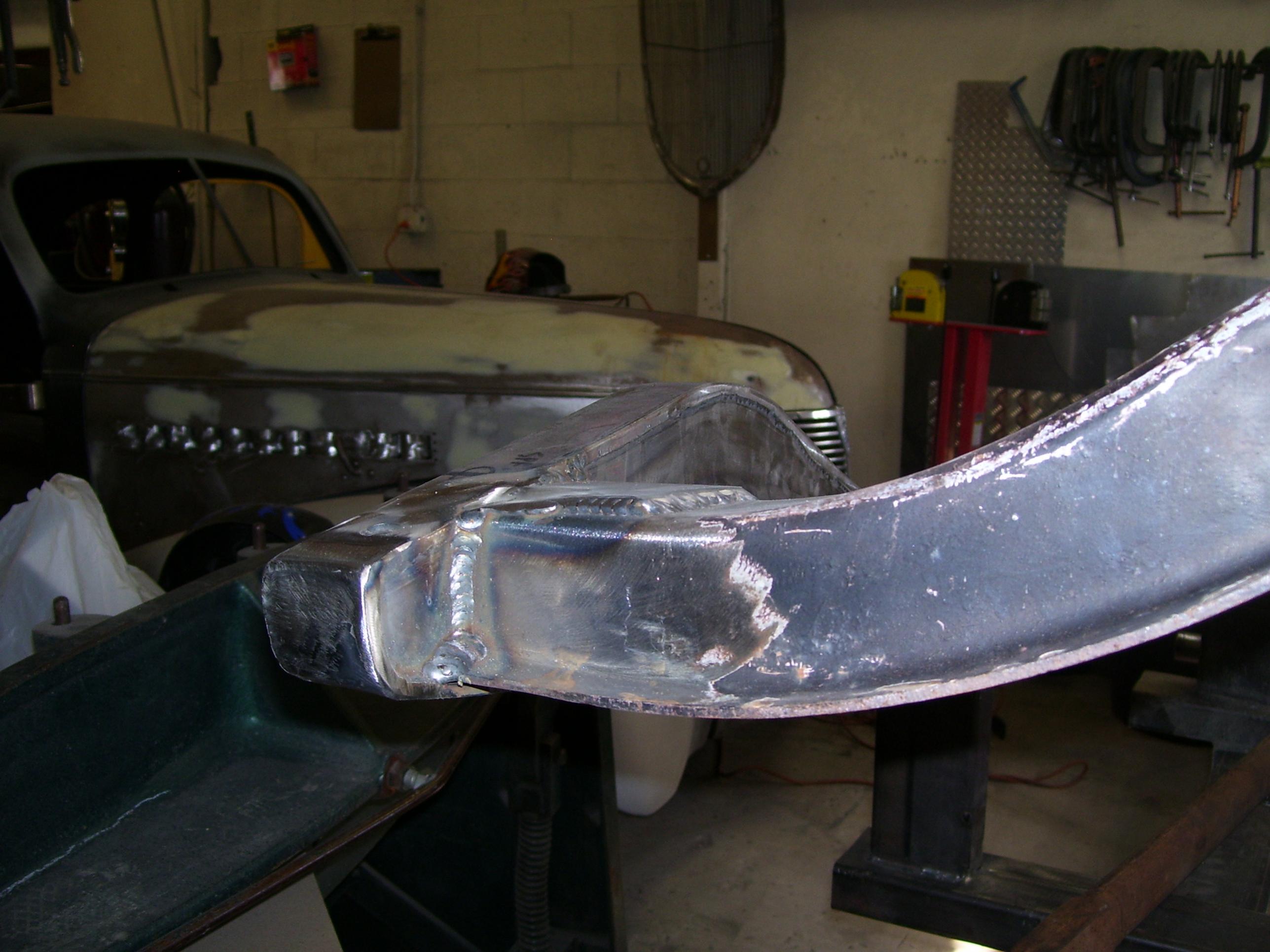

Yesterday, October 14th, Randy and I welded in a Model A rear crossmember that I had. Of course, careful measuring and planning goes in this....
Decided not to use the tubular rear crossmemeber as it looked too modern.
