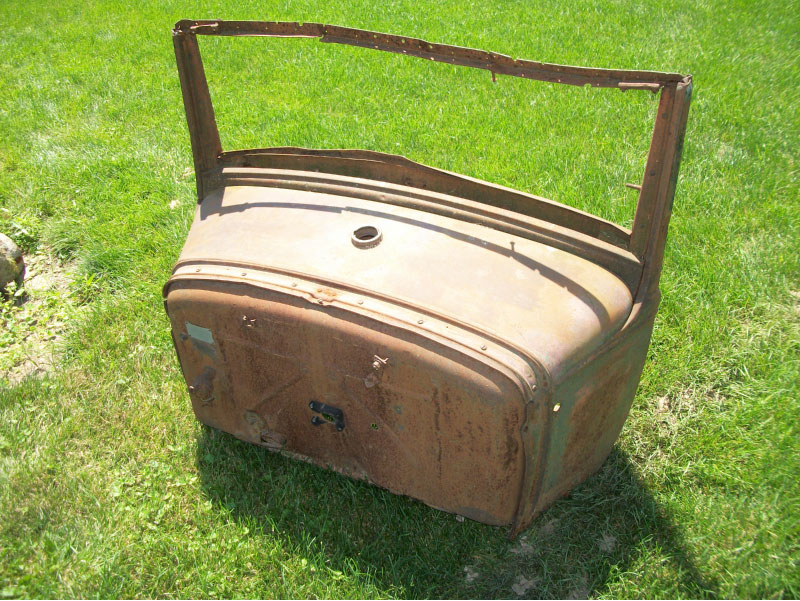

    Well I not sure that I am starting this thread a bit early, but I need some inspiration or perhaps an artist… This project starts out with the inspiration of Edsel Fords 1934 Model 40 Speedster. In the creation of a speedster, that has queues from the Art Deco cars of the 1930’s & 1940’s. Here is what I have so far, butchered 1935 ford chassis, 1950 Ford Flathead, and a 1930 Model A cowl form a sedan or coupe some closed body type.
    here are a few ideas that i am trying to use in styling the desisn fo the body.

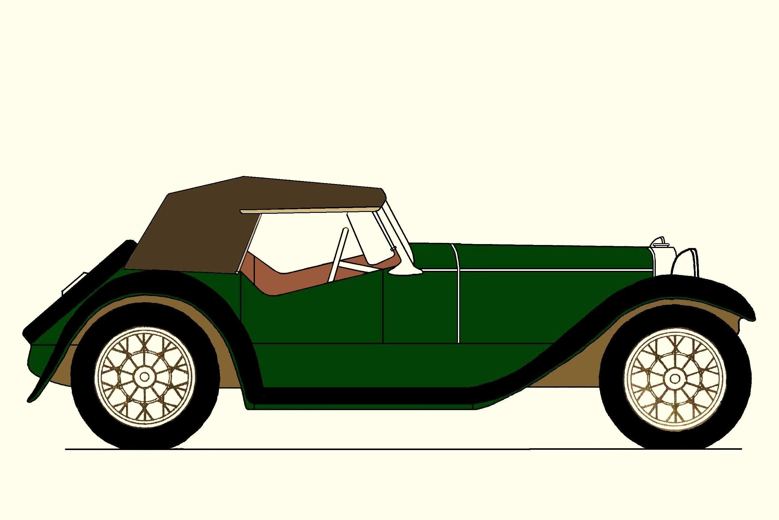

    Here is a drawing of My DAWFORD Special.
    I used the fenders, Splash Aperons, running boards and wheel base of a Model A Ford and grafted a Body resembling a 30's/50's British sports car.
    I'm building mine with a 3.7 Mercruiser 4 cylinder torquer engine.
    The DAW part of the name is made up from my initials and the FORD is due to the Model A Ford frame that I started with making it a DAWFORD Special.
    I will peobably stretch the wheel base to 111 inches to make it look longer and lower.
    It will end up being a big sports car but due to the light weight components and the 225 hp it should go and handle quite well.
    225 hp, 250 ft/lbs torque in a 2000 lb. package.
    Dick :) :) :)

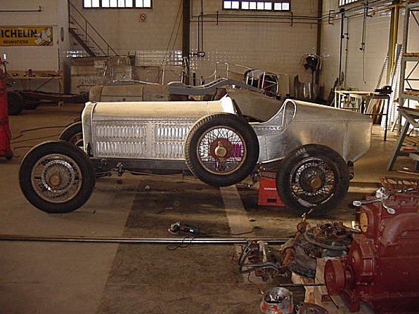

  13. out plowng- there are LOTS of photos of this speedster that go through the build pretty extensively. I don't remember what I googled (T speedster, probably), but they were on the owner's flickr acct!
    Of all the speedsters on the NWVS site, Peter Daun's is my favorite! Apparently, h built the buck, made a mold, and then destroyed the buck... bummer.

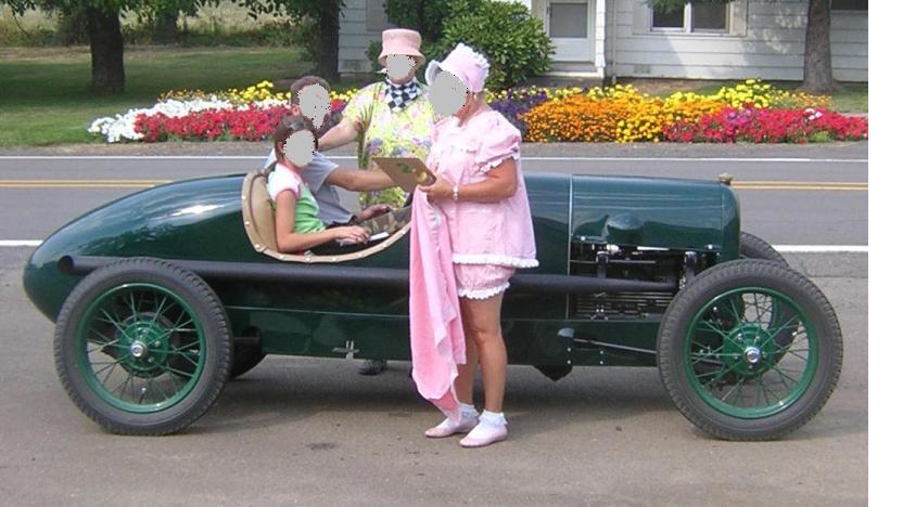

    Some from a recent car auction.
  15. slodat
    Joined: Aug 18, 2009
    Posts: 189
    slodat

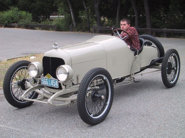

    Thanks, that is my car. My dad and I built the car when I was in high school.
    Here is a link to my flickr account with the speedster photos.
    http://www.flickr.com/photos/ivanjorgensen/sets/72157603566811292/

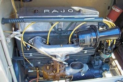

    The engine is a Model T block with a Model A crank. The head is an original 20's aftermarket RAJO Model B overhead valve conversion. We run a Stromberg O3 carb.
    Here is the engine:
    The car still has the original 2-speed Model T transmission. In addition we have an aluminum case Warford 3-speed transmission and a 2-speed Ruckstell rear axle.
    The car can keep up with modern car freeway traffic, but the problem is stopping. The combination of rear wheel brakes, skinny tires, and light body making stopping very concerning.
    The radiator shell is custom made. It was modeled after a 1920's Paige radiator with a stock Model T radiator sitting behind it. We had a nice looking Paige radiator, but it turned out the core was in very bad shape. The Paige radiator and radiator shell are one piece, there is no radiator shell. Instead of replacing the core, it was cheaper and easier to make a new shell.

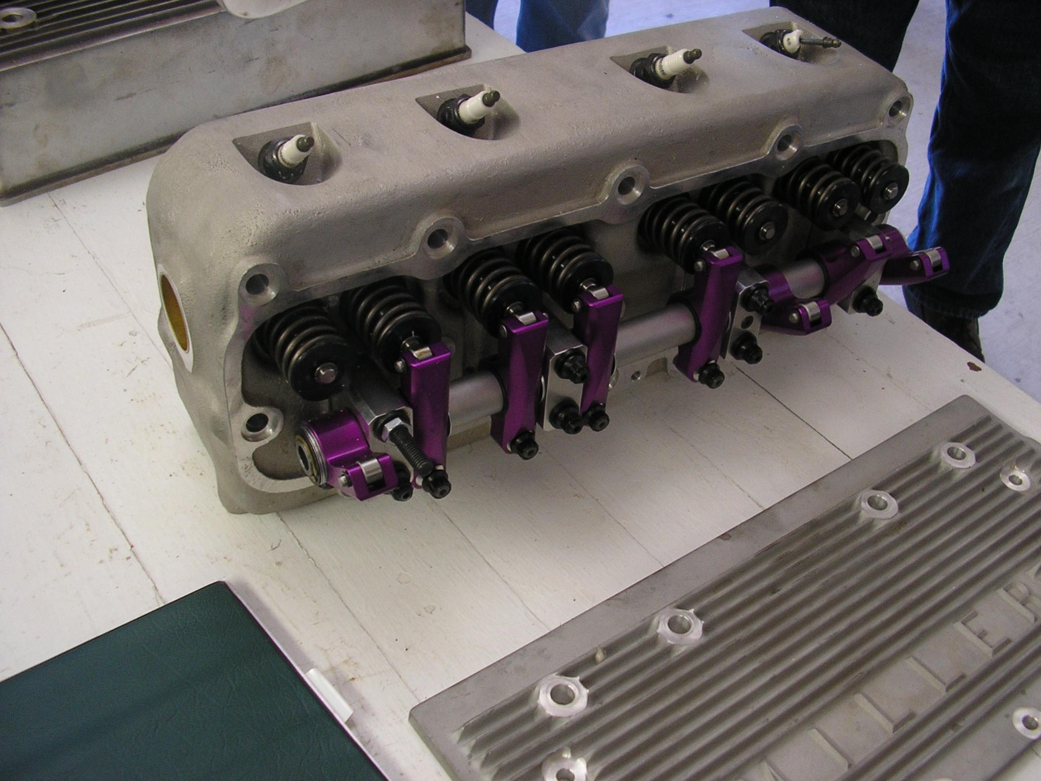

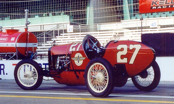

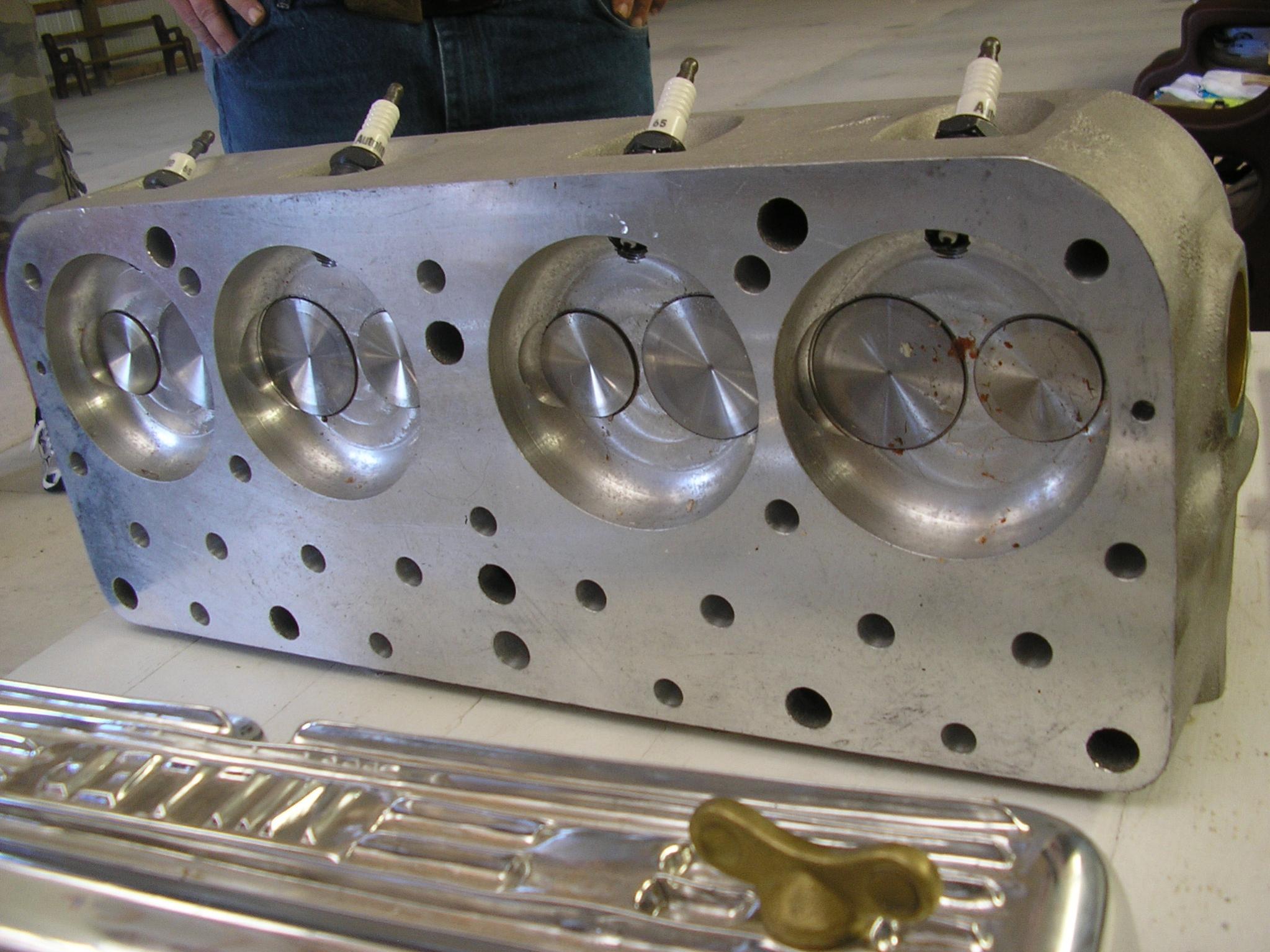

    Just got back from the Local F.A.S.T up in Northwood, Iowa. Wow what some neat cars. here are a few pics that have caught my eye.
    Check out that Head... for a Model A ford
    Over head valve with needle bearing rockers, and HUGE intake valves...

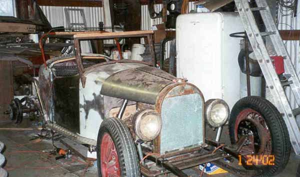

    Ran across a rolling frame with all drive train components from a 30 Plymouth. No body panels, or radiator, thought it would make a good basis for a speedster. the engine is a 196 Cu in L head Banger that makes about 50 hp with its 6 to 1 CR. Wheelbase is 109 which is maybe too long. Thinking of using a couple construction wheelbarrows as the basis for the cowl area, maybe rear offset the co driver's position, then building the rest aircraft style, fabric over wood. Currently has wood spoke wheels, would probably look for some later wires.
    Engine would get some more compression, couple of SU carbs and a home built.
    exhaust. Anybody out there have a early MOPAR speedster?
