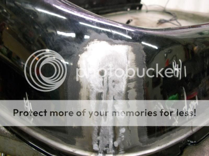

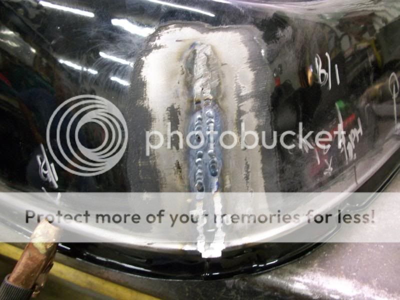

    Once its all welded up grind down the welds just proud of the parent metal on both sides.
    Now we can get to hammering. If you made your patch oversized the only part of this prject that will need to be stretched is the point of the pie, circled below. (and it wont need a lot either)
    once you get that part stretched grab a file and start working just that point.
    for the rest of hammering we are dealing with misplaced metal. its the right size but slightly out of shape.
    To correct this I use that same soft dolly and tap the low spots only from the backside again circled below.
    continue to tap/file until your happy with the shape then go back and weld up any pinholes,
    those spots will need a slight amount of stretching before you run the file back over them.
    It doesnt take long and you'll be to the point that a heavy coat of primer will fill the low spots.

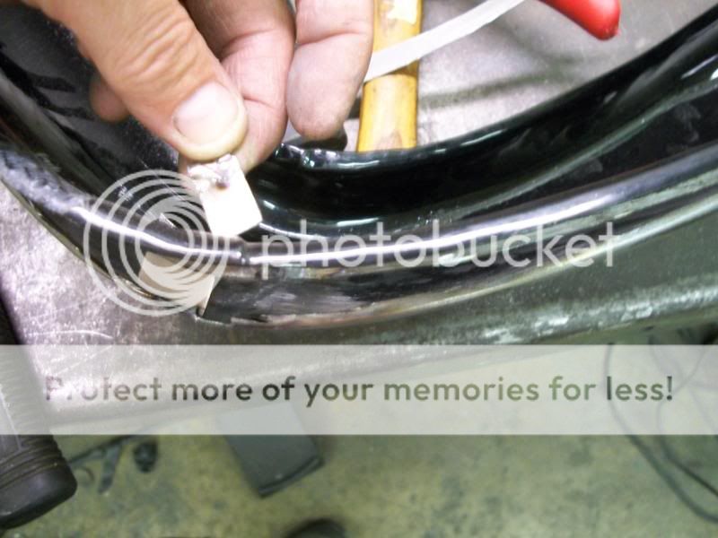

    cut the tack and remove one of the bridges holding it open so you can fit your patch
    again just slightly oversize so you dont have to do a bunch of stretching. There is a built in cheat here as you are welding between a couple 90 degree bends so it wont move a lot anyway.
    try and keep the gaps to a minimum and make sure it stays somewhat flush. This ones not as critical as the outside piece because its mostly covered when finished.
    weld it in place and grind smooth, then cut the other bridge out and repeat the above steps.
    Now you can bend and finish welding the outer lip, then file it to shape.
