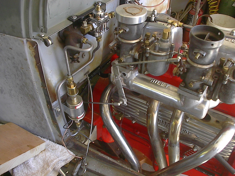

    Can you pull from the other side of the carb like this...?

    Thanks, Bodger. I could if I had a resource for old style carb linkage. Speedway and the Hot Rod Shop have standard lengths of linkage and a few options to fulcrum and change direction so the push of the stock linkage becomes a pull on the carb.
    I would need some kind of an arm on the other side of the carb. I would also need that nifty looking copper thing you got by the firewall.
    The guys at the local NAPA store just laugh when I bring in old carb parts. Most of the young guys don't even know what a carb is, I don't think.
    You do have a nice set up.;)
