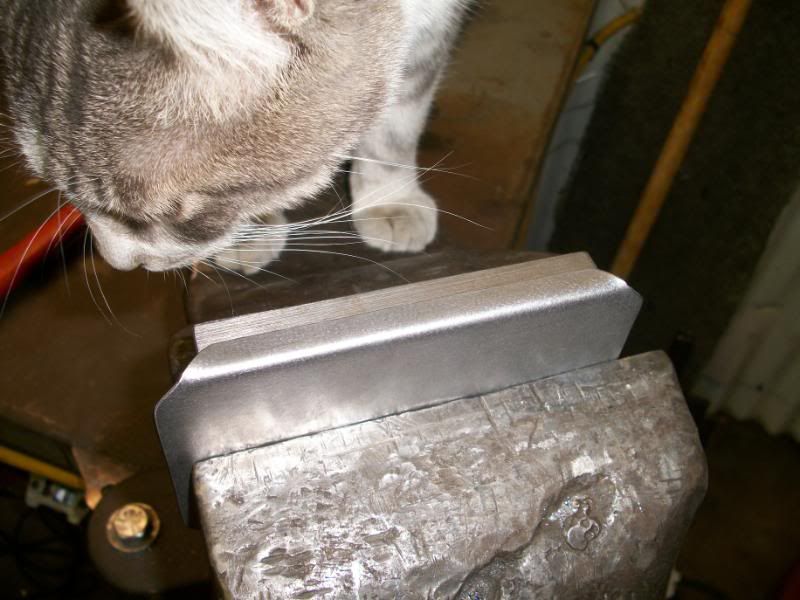

    This will be the inner skin, and it will need a step in it to make it rigid. No step roller,, hmmm. good thing I fixed the floors in the falcon, cause you can use the same beading technique from that on this one too.
    I marked the outline of the step
    and clamped it over a piece of 1/8" thick steel plate with the edge of the steel along the outline.
    The outline should be 1/4-5/16" in from the finished edge.
    edit: remember this is slightly oversized, so measure in 3/8" in from the outer edge so when its trimmed to fit it will end up at 1/4-5/16". Hey it was real early in the am when I did this thread.
    Hammer the edge down using a deadblow rubber rock on a stick.
    Once that side is done move to the next, make sure the corner of the outline is lined up with the corner of the plate underneath.
    DO NOT DO ALL FOUR SIDES!!! leaving the bottom unfinished will give you a cheat later.. We'll get back to this in a minute.

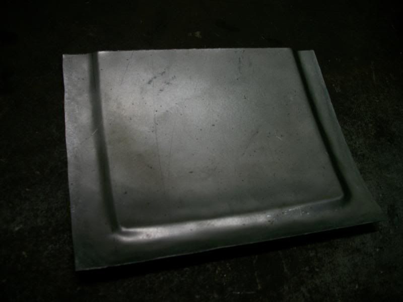

    now for the curve,, I just bent it by hand till it was close. This caused a couple of puckers in the raised portion. dont worry yet, we have to shrink that part anyway to make it stiff.
    This is one of the few times that I use a torch to shrink anything, propane torch works smurfectly. FIRE WOOO HOOOOOOOO!!!! (put the kittys in the office for this part, they are no help with this one and burnt whiskers stink!.)
    in order to get it to shrink properly you'll need more heat in the corners, marked that out with fancy squiggles so you can see where to heat it more.
    YOU DO NOT HAVE TO HEAT THE METAL HOT ENOUGH TO CHANGE ITS COLOR FOR THIS TO WORK!!!!
    Several light heatings will produce a lot nicer finished product. I heated and cooled the piece and checked against the dash several times before I was happy.
    Now for any puckers that you put in manhandling it for the curve, put your rubber rock in the vise, hold the pucker over the sweet spot and lightly whack at it with a smooth faced rock/stick.
    You may have to work this a couple times too, again smaller whacks will get you a nicer finish.
    this is what you should end up with,, note the one spot that is darkened, thats all the heat required.
    now double and triple check your fit for size and contours!
    once you know its gonna be ok you can finish stepping the lower edge. The idea about leaving this open will allow you to adjust for any top to bottom adjustments without getting the step to close to the edge.
    sometimes rolling in a contour can change things on the hyperspace level and then it wont fit.

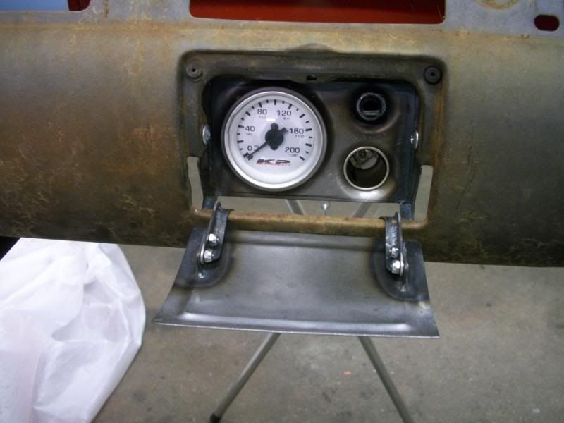

    now before we get any further we need to address how to attach the hinges, being that this one was total custom piece of crap that wont fit anything else I just welded a couple tabs at the edge of the step to bolt the hinges onto.
    love my tig! for those of you with a mig, you can cut a slot and slide the tab into that and weld from the other side so it wont show.

    heres the inner with the hinges on it,,
    and with the controls and such in the mockup dash. minus the holder closers. all the gaps have since been filled to, more pics of that later.
    see how the hinges work as stops too, so when its open there is a gap between the lid and the dash. the screws are 4/40s, nuts are 1/4" wrench. hard to get the scale but they are pretty small. it will have acorns holding it all together when final install is done.
    I also added a 12 volt outlet in there too, nice to be able to charge a cell phone or ipod while your driving, the added bonus to the hinges and the latches is that when charging something it can be laid on teh open door and both sides have guardrails, so when you go round a corner you wont have to chase it all over the floor.

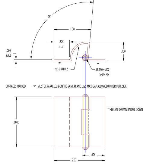

  30. For those of you don't have the skill level as this nicely fabed hinge. Here is a very nice over the counter hinge.
    I use this style of hinge, they're only a couple of bucks.
    This a style of Hidden Hinge
