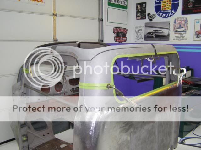

    Then he decide's to chop the top and section the cab. The chop will be 5 1/2" in the back and 6" in the front. The section will be 1 1/2" in different area's of the mid section as you can tell by the pics. First he decides to section the cab.
    Then put's it back together.
    Then he chop's it and starts cutting.
    Since the truck has a severe chop the back window would be a mail slot so he only chop's the rear window area 3".
    Since the rear window is pretty wide it would look out of proportion so he narrows the window to 28" and then lowers the window to give it the right look. Before he finishes the rear window area he makes a wood buck and a new top on his owner built Yoder hammer.
    Here he does some finishing work on his planishing hammer.
    Then he welds it in
    Here's the finished top

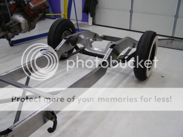

    Once Jimmy gets it to this point he puts the cab back on the frame and lowers the frame with a 3" dropped Axle and flip's the rear end. Then he mock's up the motor and fender to see how it is going to sit. He decides it doesn't sit low enough and does some investigating on how to lower it more.

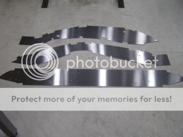

    No problem for a man with this kind of talent. He says I think I can build a lowered frame easier that I can lower the stock one. So he decides to do just that. Now this is where it seperates the men from the boys. First he draws it up on his computer.
    Then he proceedes to cut it out with his laser.
    After he cuts it out he runs it through his sander and here is the finished product.
    He cuts an inner and outer frame rail and bends a 90 degree bend on them and then welds it in the middle to make a boxed frame rail.
    Then he puts it on his jig table and welds it together. This thing is a piece of art.
    WaLa!!! One complete 51 ford truck frame that is lowered a total of 10"
    The rectangle holes in the top and bottom frame rails will be curved and put in later. He had to do that so he could bend the frame rails in the brake.
