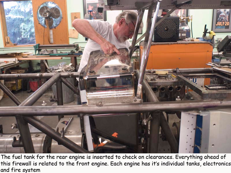

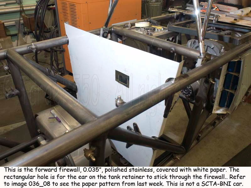

Well, I almost made the post on Friday. I guess my bonus for meeting the deadline is out the window. But the update's there and it shows some of the previously completed components coming together.
It shows the forward firewall being fit along with the fuel and water tanks which are all stainless and continue the process of crafting a piece of fine art that's intended to bump the current Land Speed record (415.896) by over 100 mph. Boggles the mind. I try to imagine being at the 5 mile mark on the salt and shooting the car as it sails by at over 500 mph...and I just can't wrap my head around it. Last year I shot the BUB 7 motorcycle liner as it sailed past me at around 370 mph. It blew my mind that I got background panning blur with a shutter speed of 1/1000th:
http://www.chevyasylum.com/lsr/bsf20...09_20_jpg.html
But I digress. Here are a coupla examples of the craftsmanship, not to mention the progress on the liner.

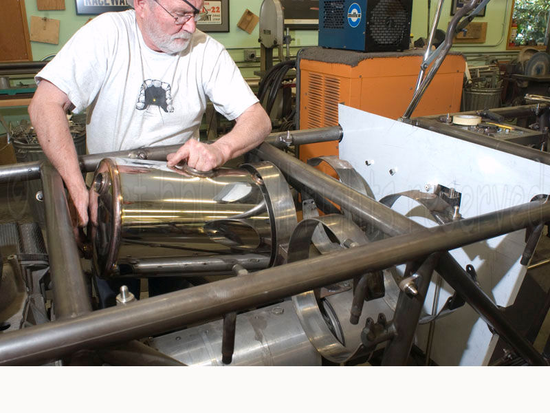

These are shots I made the last time I visited the shop. They're mainly of welding details. Sounds boring as hell. But I found 'em to be fascinating as far as the quality of work and the consistency of the beads are concerned.
The attached photo shows a fuel tank made from stainless. It's a frikkin work of art. Otta be in the Museum of Fine Art. It's for a dragster, not the liner but it was there on the bench and it kinda screamed at my camera to photograph it.
The last photo in the series shows the original plans for the liner's frame. Speakin of frame, that's what they did with the plan. It's in a frame and hung on the wall. Art is where ya find it.

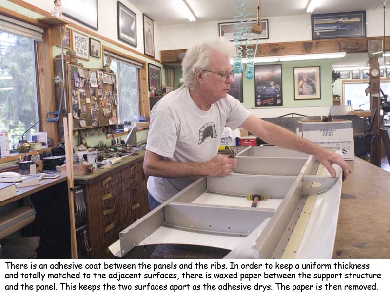

Here we go again. This week's post shows the oil pan access panels, the body skin assembly and a security concern. Well, the head of security is takin a bribe, more or less.
Every time I add a group of photos, I see something else that blows my mind. In this one, it's the method of fastening and bonding the body skin to its substructure:
