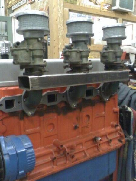

    Alright guys... Here's some shots of the prototype.
    Let us know what you think?
    1. What would you change?
    2. What would be your choice?
    3. What are your questions?
    4. What is your advise?
    This intake will be available mid summer in the Cast aluminum 4X2 version. 4X2 version of this intake will use the center two carbs for normal driving and then.... Outside two will come in progressive at wide open throttle.
    The 3X2 intake will come along after that.
    The 2X2 will be an option if enough interest is there.
    The log will have the 3 bolt stromberg 97-Ford 94 flanges.
    It will have a "Water Heater" for the weather challenged.
    Dickster will be providing the linkage kits for these intakes.
    The header flange is 3/8" Cold rolled steel in a plain flange, stub, or header kit.
    The intake and header flange will be fully o-ringed with hi-temp silicone o-rings. So no leaks EVER.
    Like Tom said.... The 1st New Technology for 235-261 in over 50 years.
    Kevin
    Ooltewah Speed Shop
    Kevko Speed Equipt.

    Interested in all the above. I would really be interested in the pictures.
    I have an all Edmunds setup on my 235 and I am looking for something different for a 261 I am working on.

    Hi, 6inarow. I'm curious as to the benefits of a water-heated intake-manifold. Is the idea to replace the heat exchanger present between the stock intake and exhaust?...For quicker warm-ups? Thanks - Rick

    yes, its been debated quite a bit, but in my cars a heated intake always runs better.

    We've talked about header ideas, but what it really boils down to is what you guys want. Do you want a kit or a done deal, bolt on header that could be raw metal or ceramic coated in your choice of color.
    If it's gonna be a bolt on deal, it will probably work better for all involved if it was a shorty design similar in legnth to a Fenton manifold.
    What do you guys think?

    Seeing as though the Fenton, Clark and Graham headers will work with Fenton, Offy, Edmunds, Nicson and all the other non-elbowed intake I suggest you might like to look at making headers for intakes with elbows.
    Intakes like yours, the extremely rare Howard 5 pot for chevies, and my favourite - the McGurk 3 carb need free-flowing headers without the tight turn of the F, C & G headers. All other headers on the market have that abrupt 90 degree turn as soon as the gases leave the exhaust port, which is not required when you have an elbow.

    Hey, if you are trying to get a headcount for people who are serious about buying this, you might want to post this over at inliners.org & stovebolt.com...
    If I weren't staying stock with my truck I'd be all over that! There are actually alot of intakes for the 216-235, although 99% aren't produced anymore.
    http://www.jalopyjournal.com/forum/showthread.php?t=200740&highlight=stovebolt+intake
    Are you guys planning on doing some kind of flow tests? or tuned length runners? or is this just a piece of square tube with carbs on it? I don't mean to shoot your idea down, but fenton intake and exhaust are readily availiable.....gotta one up your competetion, especially since the have the "vintage" factor on you...
    I don't think anyone makes an EFI setup for the stovebolts....
    Personally, I'd LOVE to see a badass sidedraft setup for the stovebolts, kinda like what they used on the vettes
    These are kind random thoughts.... just my $0.02

    The McGurk 3 carb intake was the original thought behind our idea. The 3 and 5 carb original McGurks are so rare it's a joke. Most of the ones you find for sale are for the GMC. The header will be for the elbow type intake. Not a copy of the others on the market. The tubes will have a natural flow and not the confined short 90* like the Fenton's and others.
    Our intake will have the option to water heat, if you decide to use it. If not, you can plug it off.
    The headers will be tube, not cast.
    Tom and I are members over on the other boards too. We are just feeling the water here. Flow tests will come after the prototype is cast. We will be trying different runner lengths and log configurations. As far as we are concerned, we already "One Upped the Competition". Nobody now or ever has made an intake/header combo with these options or technology. A new product can't really have a "Vintage Factor" This is a new product that is geared for the guy who wants to run a vintage engine with vintage carbs that really work.
    We welcome all comments and criticism. You should also know that this is a work in progress, and we appreciate your interest.

    we had briefly talked about the side drafts too. It might be a possibility for cars with hood clearance issues like my 56. Like Kevin said we are testing the waters to see where the interest is. Maybe DCOE's????
    Our attempt is to make something that works (carburetion) that Joe 6 pack can do in his garage (how about that c.s. set up Chevy used to clamp the intake and exhaust to the head), that you would like someone to admire when you pop the hood - 3 or 4 carbs on an inline that actually WORK.

    Hey Mark, thanks for the note. Once you see how Kevin did this, its easy to see how it will flow. He is so particular that it wont leave his shop until its perfect. He will post some photos when its time. The turns are a major consideration for us and Kevin has it handled. Pics to follow

    Since our intake is Stromberg-Ford 94 based, you could bolt on the Moon 97 EFI system if you wanted computer controlled fuel injection.

    There is a guy who made headers for his SBC out of the type of pre-formed elbows you are using for the intake. He did such a bitchin job - they looked like cast headers similar to Fenton sBC cast headers. A hell of a lot more work than tubular headers though.
    I'll see if I can find a picture.

    I'm not sure the 250-292 family has been overlooked? They are great engines, no doubt about it. Clifford has a ton of stuff for them, even a side draft intake....
    The 235-261 stuff is gonna be our focus for the near future. Other stuff might come along if things move along as planned.
    We would love to have a side draft intake if we had a user friendly side draft carburetor to use. The Weber or Dellorto stuff if WAY to tempermental for everyday use. Any suggestions?

    I hate to be Debbie Downer, but how many of these do you expect to sell?
    Or how many people have enough ass in their 235 to run FOUR two barrel carbs? Or even THREE two barrels?
    Vs.
    How much is it going to cost me to design and produce this intake?
    I like the idea, I'm just sayin'...
    Now a good split exhaust on the other hand, is something EVERYBODY with a 235 can use. You've got a much bigger market.

    Don't get me wrong. I LOVE it. Four big carbs would look awesome. Especially if you've got the motor to take advantage of them. I just don't think that there's enough of those people to not lose money making these. You've got prototypes. Improvements on prototypes. Then casting the final product. That's a lot of money invested before you've even sold one. Realistically, how many will sell and how fast?
