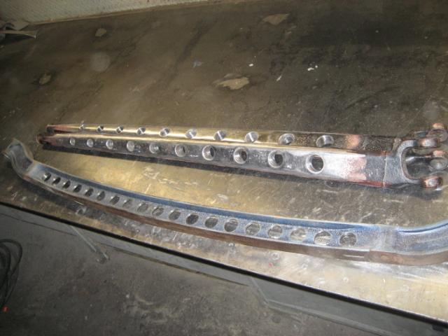

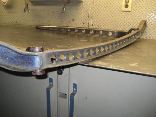

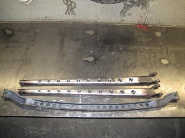

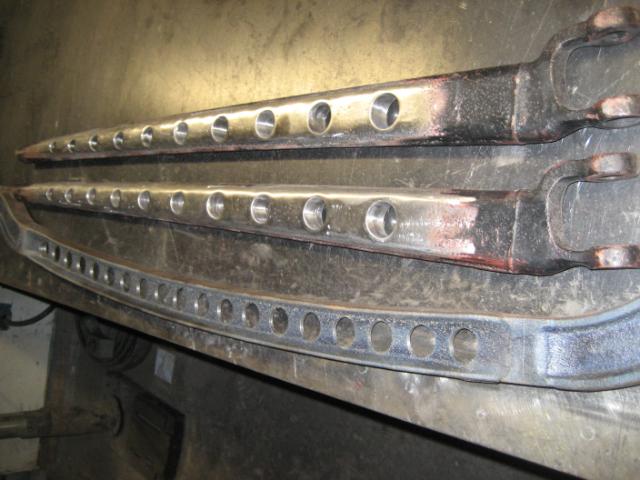

    Between layout drilling welding and grinding it took me 10 hours to do this. I want to thank Jeff (gmgrunt) for making the sleeves for me.
    I have been thinking about drilling 3 more hole between the perch bolt hole and the king pin. What do you guy's think about doing that?

  3. Not if you are going to drive it.
  4. Nice! I think this has come up a few times, and the general consensus is no, don't drill past the perch. I didn't on mine.

    dont drill any more holes.
    would be a bit too tryhard..unless it was under a real early sixties nose-up drag car.

    Axle 1-1/8 drilled on 1.777 centers that leaves 5/8 between holes
    Bones Used three size hole saws 1-1/2,1-1/4,1 250 rpm that's the slowest my drill press goes
    grinding I used a 4in 50grit flap wheel and a DA with 80grit
    Now after I got the input I wanted about drilling more holes I'm done and there is nothing I would do different
    I'm still going to peek it just need to find that tech article on how to do it
    Is this want you wanted to know:D
