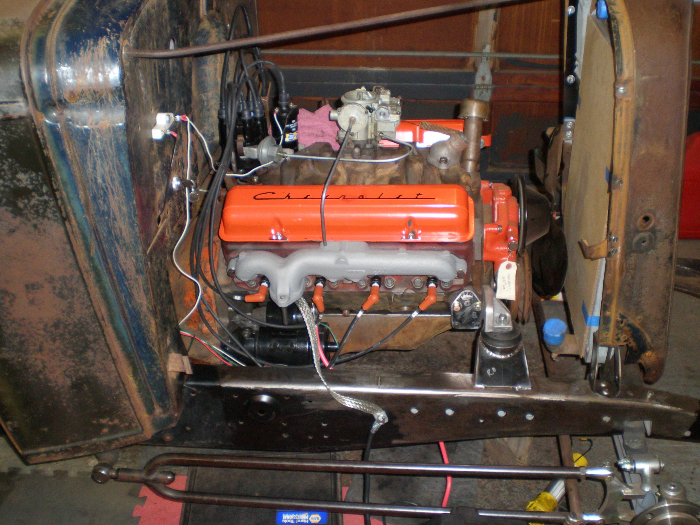

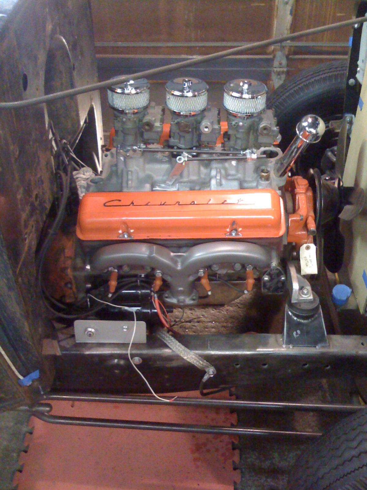

Parts list: '57 283 backed by a T-5
'39 Ford rear converted to open drive and hung on a T spring
Wide fives
F-1 steering box

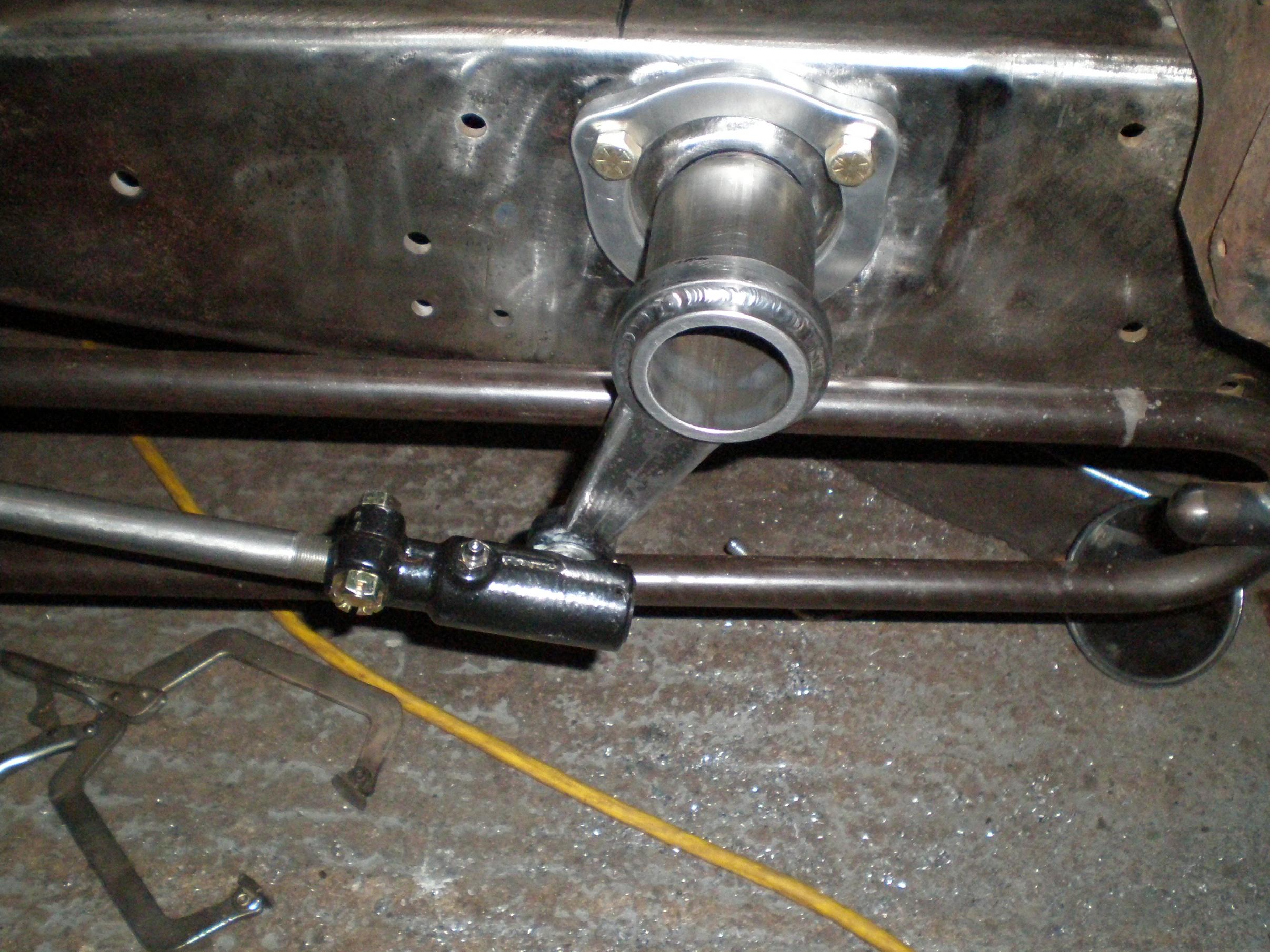

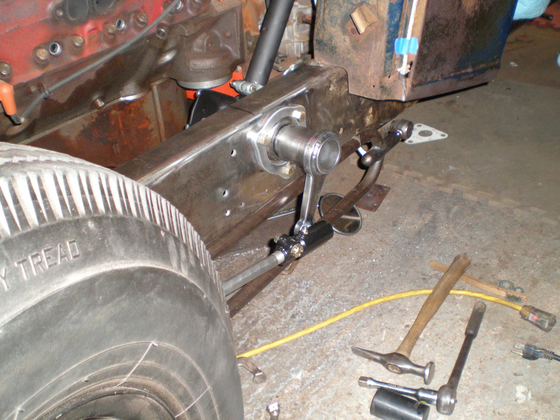

I was originally trying to work with the original crossmembers, but as I worked my way from front to back, they all got replaced.

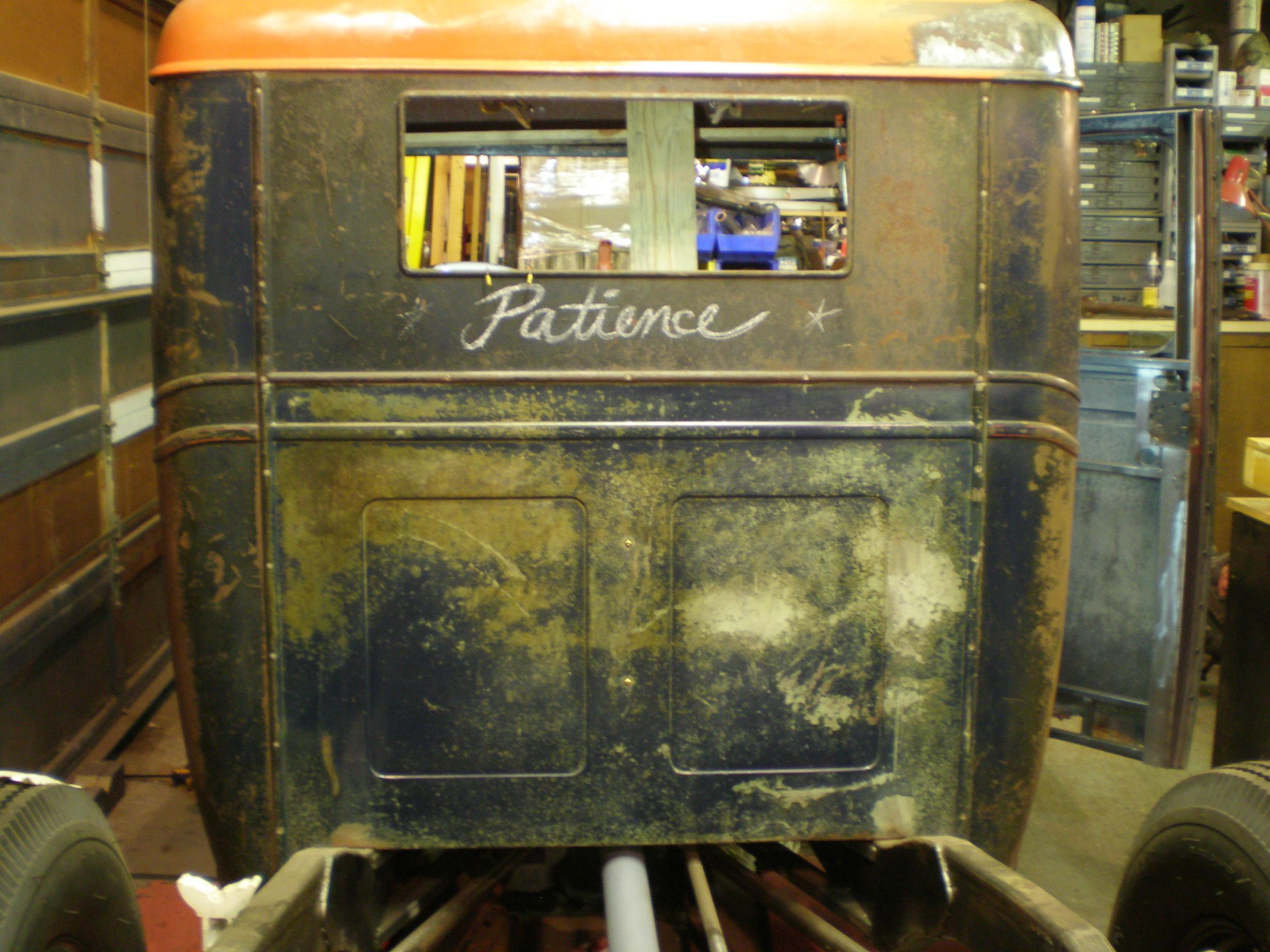

Overall the cab is real straight with the typical rust issues ( door bottoms are gone, visor is rough, the cab lower panel is beat and the rockers very rough, though I did find replacements for them and they are even the same color!)
As far as wood replacement, I am kind of taking the road less traveled and basically replicating the critical shapes of the wood members in cold rolled 11ga. The A and B pillars are made in this fashion. I bought one new A pillar to use as a pattern $$$ but had enough left of one B pillar to figure out it's shape. There are also all kinds of brackets that held the cab together originally, and I had one side to copy.
The skin will attach with screws or steel rivets depending on the location.
