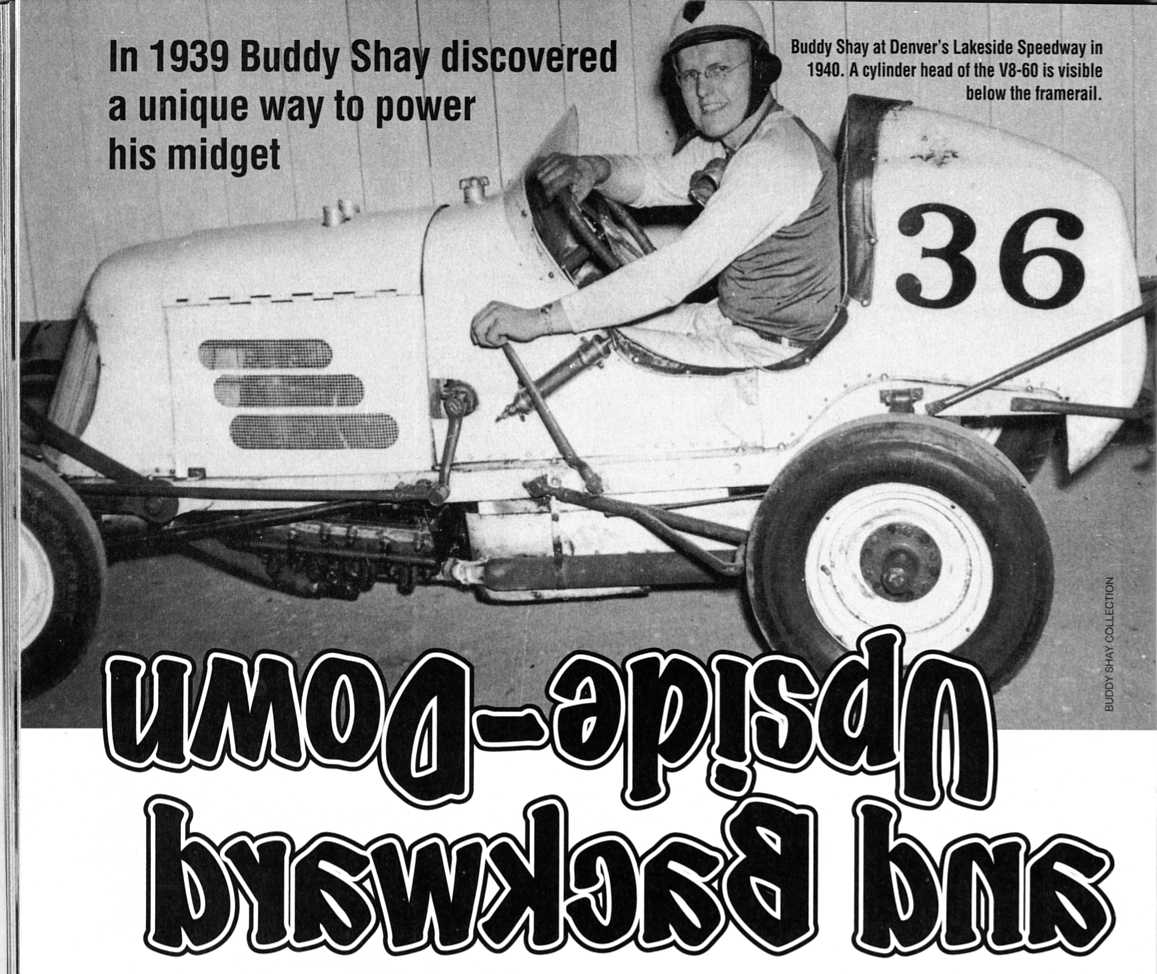

It's 1941. Buddy Shay and Frank VanDersahl had been campaigning a midget car for a couple of years, but their Chrysler 4-banger just wasn't cutting the mustard anymore. The v8-60 cars at their local track in Denver, CO were blowing them off and the...

That has to be the strangest solution to getting competitive that I've ever heard of. I sure hope other HAMBers will come up with more info.
The more I think of it, I'll bet a bag of donuts that one or the other of those guys had some aircraft background. Inverted engines were very common in the 20's and 30's.
Click image for larger version
ID:	650563   Click image for larger version
ID:	650564   Click image for larger version
