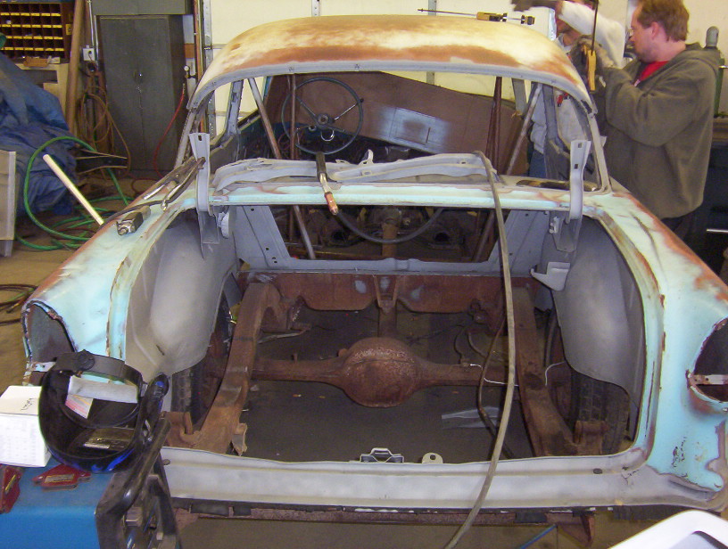

    I know CSU55 covered this indepth, however this is the factory correct way to convert a Tri-5 chevy from a Granny 4 door to a 2 gear slamming 2 door.
    Most people don't know but 2-door post cars ( sedans) share the roof and most of rear quarter with a 4-door version, which makes this a pretty straight forward conversion.

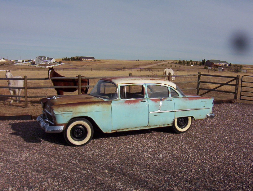

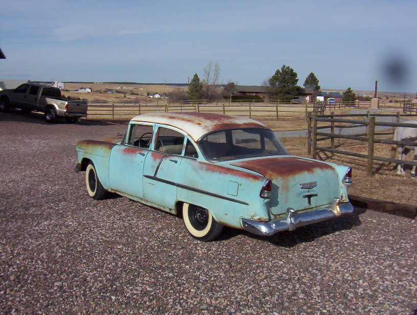

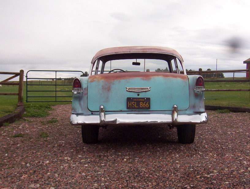

    I purchased this 4-door about 2 years with the intention of stuffing a 350/350 in it and sell it. I learned a tough lesson that nobody wants to pay anything, like near nothing for decent running driving mechanically sound 4-door '55. So after much research and lamenting over the amount of work it would take to do it I said FUCK IT!! I can do this!!

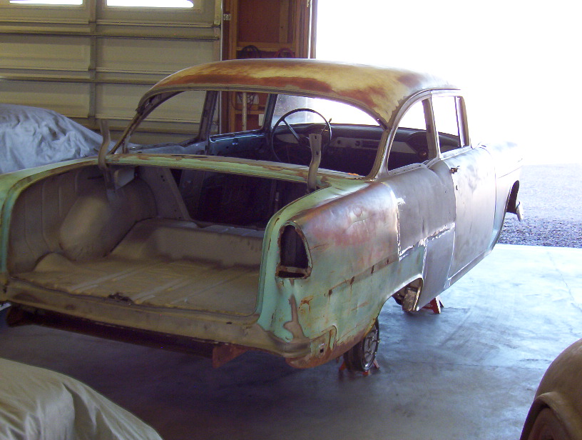

    So a little help from Squablo on some '55 2 door doors and two really rusty, read WISCONSIN rust, rear quarters and B-pillar. I got the parts last spring and I waiting until Christmas break to start. I may be an idiot but I know my limits so when it came to the fitting of panels I enlisted a close friend and metal master, Mark Hopkins and E-Street Hot Rods (303)-646-2262.

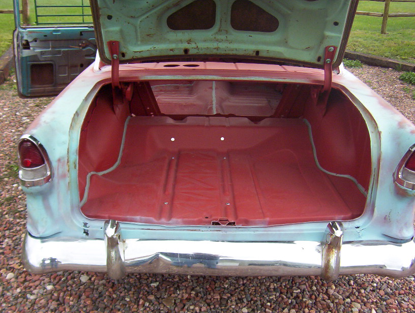

    We basically gutted the car and found out that it needed more than just a floor, inner and outer rockers were marginal, trunk pan had some issues, several floor braces needed replacemant so we ordered all new steel.

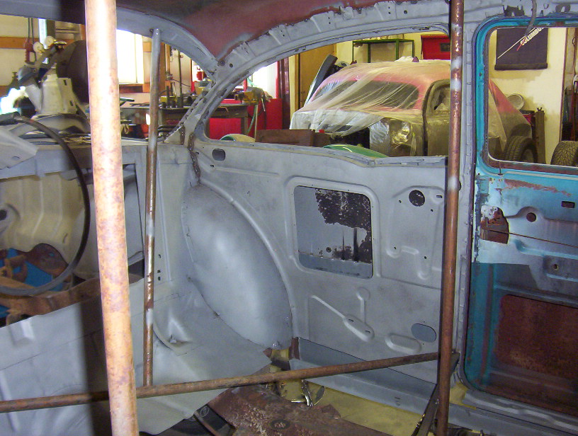

    We then braced the roof with some tubes and cut away the rockers, floor and trunk pan so it could go to the blasters. We did not want to burry and rusty metal so we wanted the area of surgery to be solid steel and clean.
    We also discoved that the rockers cannot be replaced until the front fenders were removed. That is why in most pictures you see it without the front fenders.

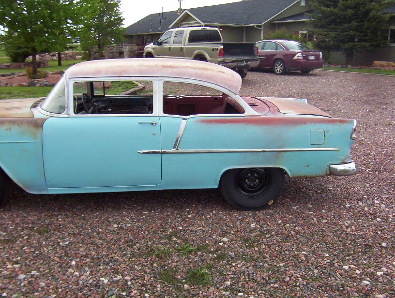

    To do this you need to start with rockers first and get the car square. Then we hung the 2-door doors and checked the alignment with the door top and front clip which told us where to cut in the rear quarters. Remember these '55 rear quarters were only good above the belt line and we had add lower front quarter patches and some inner structure.
    In the end we had a a factory correct 2-door '55 chevy that is want I really wanted. The down side is this alot of work, probably 80 feet of welding and grinding!!
    In retrospect I would done this with a better 4-door start. Mine was border line, but it was what I had. You can find really solid 4-doors out there cheap and that would be the best start for a project like this.

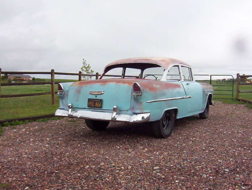

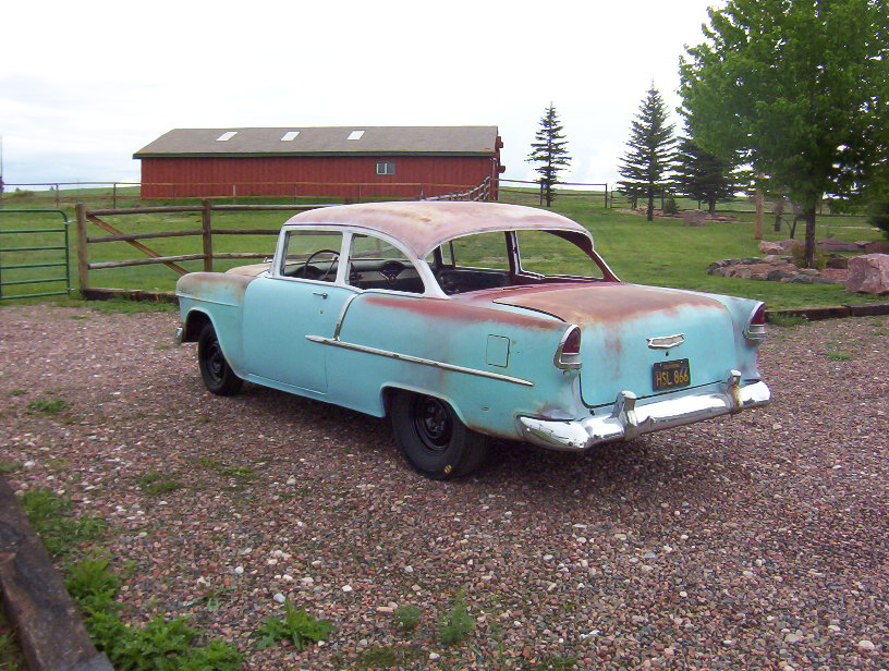

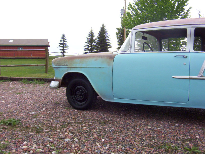

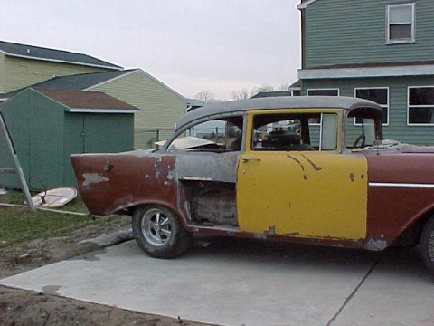

    Here are some pictures of the car with side trim and new wheels and tires. I did not use ANY BONDO, what you see is the metal work, so it is not perfect.
    I am shooting for that early '60 gas class car that is mostly stock street car that a guy would bolt on the pie crust slicks and run on the weekends.
    Cody at Hurst racing tires hooked me up with the perfect set of pie crust cheater slicks for the rear that fit perfectly.
    I ordered some enamel Chasmere blue in spray bomb to try and match the patina. I still need to do some more work on it , but it looks pretty good for now. I need to get my front seat upolstered and put the glass in the car.

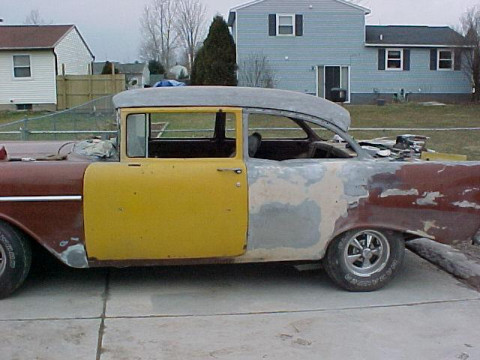

    I've read through CSU's tech and I've seen yours, and I've also seen one done using the whole roof from a 2 door sedan. So let me ask you a question. Do you think swapping the whole roof from a 2 door sedan would make this easier/less welding, assuming you had it availible, or would you cut them the same way you did here? Because for my '57 I have a '56 2 door sedan donor and the roof is very nice. The roof is good on my '57 too, but I thought it might save welding and fitting to swap the whole roof over with door pillars and window surrounds in place. Got any input for me? I'd like to hear your thoughts on this.

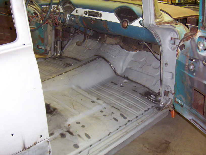

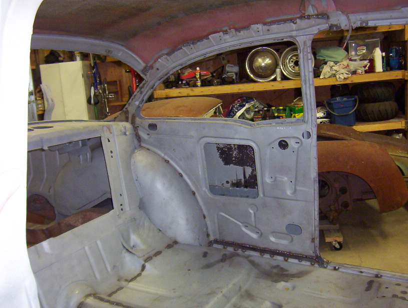

    Also, if you had some close-up pictures of where you put your weld seams on the inside and outside of the tops of the rear quarter windows, I'd like to see them. I've seen this done like CSU did leaving the rear pillar intact, and the way you did keeping the quarter windows in one piece, and from the looks of it I like the way you did it but I'm wondering if it's easier or more difficult to do it that way.

    I think it would be easier to cut it through the quarters versus removing the entire roof. The majority of welding I did was inside floor pans and trunk pan and inner fender wells. Basically we laid the 2-door quarters over the 4- door quarters and used the same trim hole on each one to align them. Like I mentioned above this conversion is basically factory correct and you can use the roll up rear windows and everything just like a 2-door.
    The weld seams on the quarter windows are on the inside ( see inside pics) and I am just going to seam seal the outer edge. It is super solid this way and really no need to weld around the outside quarter window frames.
    I would however make sure I started with a very solid 4-door because the pans and rockers are the same which would have saved alot of time.

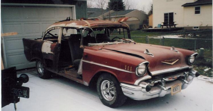

    I have so many questions for you. The metalwork on the car looks top notch. The cut line where the roof joins the new rear window opening, is it below or above the drip rail? That's the joint that concerns me the most, I'm not sure where it should go. I can't even see where the weld is on your car, it's very clean. You completely cut away the rear pillar on each side, correct?
    Also wanted to make sure you got the interior window garnishes and the glass pieces I sent along, and that you have all the window regulators you need.

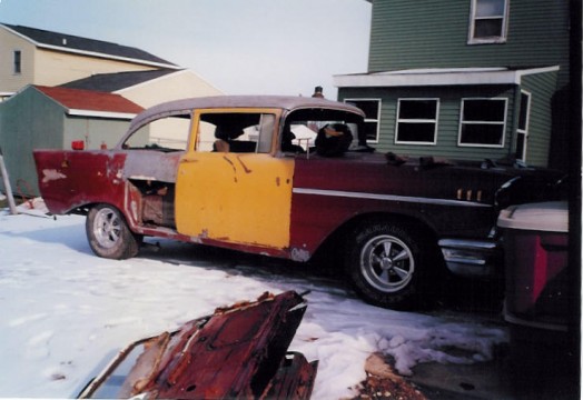

    I'm attatching pictures of the full-roof swap conversion I was referring to. (not my car, not my pics, just something I found on the 'net) Do you think that is more work than how you did it? I'm starting to think your way is going to be easier since the full roof section is going to be a bastard to move around and align. Your method would let me do each side independently. Can I ask how many hours you think this took, not including the floor pan/rocker panel stuff, just the conversion portion?
