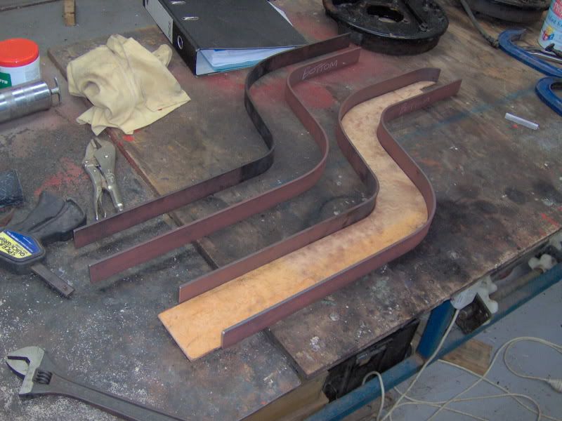

    The rear Z was a bit more of an undertaking. Because the rear of the frame was going to be visible I wanted it to look kinda like it was built that way...no bevel cut RHS in other words.
    I drew up a template with the 10" step that I had decided on. Then I drew a few more before I ended up with this one
    then I transferred the shape onto 5mm (as close to 3/16" as I could get) steel sheet and flame cut 2 of them out
    Bent up some 40mm x 5mm strap for the top and bottom webs.
    and welded them up
    Next I had to get the rear crossmember sitting where it was going to be. I cut the crossmember off and built a frame to hold it exactly 10" above wher it use to be
    I stagger cut the frame to spread the stress and make sure the back half of my frame didn't just drop off. Once the crossmember was tacked in its new position on top of the jig and the rest of the frame was also securely tacke in place, I just needed to fill in the gap.
    Some fish plates and boxing still to come to ensure a good strong joint between old and new
