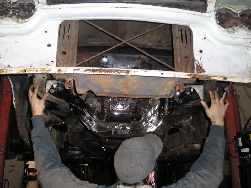

    So, as alot of you know, I am a major supporter of the camaro clip swap into a chevy truck. I have threatened to Post a tech article on how truly easy it is more than once, and yesterday, it was time to do another. Cliff (57Firedome) recently picked up a pretty good example of a middle fiddies Chevy truck.-A 1958 Apache Delivery.
    The prep consisted of about an hour of measuring...
    wheelbase 115 inches
    rocker height 15 inches (yuck.)
    kingpin to floorboard-31 1/4 passenger,31 1/2 drivers side (something was bent!)
    distributor cap (from center of cap) to firewall-2 1/2 inches
    our first order of business was to remove the welded on front sheet meta, and the clapped out 307. since that is pretty standard stuff, and even a reasonably intelligent primate (such as myself) can figure it out without going to the manuals, I will skip the "gory detains. Yes, it involved a sawzall, and yes, is sucked. the entire thing was the aftermath of living with various welders for several years, so there was lots of this awesome work involved.
    so once all that was removed, we started by removing the "primary" crosmember- the one the bellhousing bolts to. since it was 6 peices of angle iron,2 peices of stainless 1/2 rod and the original crossmember all welded together, I opted to remove it via Gas Axe. nothing to save there. once it was removed, we trimmed out the Rivits for the rear spring perches and remainder of the crossmember with the torch and an air hammer.
    once we finished that step, we welded a chunk of schedule 40 across the framrails to stabilize it, and give us a place to put the jackstands.
    The "chunk O'pipe" is more important than it would seem, because without it, you can't move forward to the next step, which is where the real fun begins. I always start with cutting the steering tube and shaft off as close to the box as I can. after that, I cut immediately behind the box on the drivers side framerail, and immediately behind the bumpstop on the passenger side rail.
    after that, we clean up the bottoms of the truck frame, and the top of the camaro frame. no need to get all excited about complete cleanliness here, just bare metal to weld to.
    The next step is to weld up the front of the drivers side body support and remove the rivits that hold the clutch arm in place-these are cool looking, simple peices that could potentially make for a clutch pedal assembly on your hot rod, so don't torch 'em.
    Here is where I make my own changes to the chassis- I have never liked how far back the tire sits in the fenderwell on these trucks, so I lengthen the wheelbase 2 inches to better center the tire. this is established by using all the previous "length" measurments and adding 2 inches. however, it is a little tricky with the camaro clip because the way that modern independant suspension changes the caster angle-by moving the upper control arm around. measurments at the ball joints instead of the kingpins will screw you. what to do?
    use the shock mount holes instead-they are centered with the spindle. easy work from there on out.
    we made a template of the camaro clip (where the arch begins and ends) then establihed a measurment from the shock holes to the "ears" on the clip. (they would be the forward mounting holes for the camaro body) we then used the "ears" to place the frame. -knowing that amount of length is what makes it easy,because you now haveplaces to measure to and from that line up with one another.
    once we got the magic number (in our case,28 1/2 inches from the box to the shock holes) we placed the template and cut the rails-this time we cut a little forward of the template linea and followed it up with a grinder to ensure a clean weld.we then hoisted the clip into place and held it there with 4 monster c clamps so we could measure more-lots of "measure 23 times and cut/weld once" here.
    I also sawzalled the end of the shaft off at this point so it wouldn't stab me in the head...again. once we liked where it was sitting (it's pretty easy to get "side to side" set on these-the insides of both sets of framerails line up like someone thought this was supposed to happen- we welded the rails together.
    no super duty welder needed,by the way- you have a total of about 3 and a half feet of good solid weld on steel a little over 1/8 th on an inch thick on both sides of the weld. we used my little Miller 135xlt to avoid burning holes through it, and can say with no fear that it is held together better than either of the previous frames.
    the next part is easier than it should be. the Camaro clip's steering shaft lines up almost perfectly with the truck cab. problem is, there is n't a support bearing at the bottom on the column! soooo. you have to install one. after several different attempts at using roller bearings with the same inside diameter as the shaft and outside diameter as the tube (1 of which will always have to be changed,rest assured) I came across these little jewels-the bottom support bearing from a 69 chevy pickup. now, I know every one of you knows where somewhere there is a 67-73 chevy truck, I wouldn't think these are hard to find items, and they save about 4 hours of crap if you can get one-they look like this.
    the bearing part is waaay down at one end of it-which means it can be welded onto the tube without killing it. after that, I made a sleeve for the camaro side from some tubing I had laying around. 11/16th outside diameter, 3/4 inside diameter (roughly) pounded it into the stock camaro u-joint and welded it into place.
    after that, I shortened the steering shaft and slid it into the sleeve in the camaro shaft, ceneterd the wheels, centered the steering wheel and welded it together- I realize it makes for a p.i.t.a. if you want to remove it, but I feel better knowing it's welded construction.
    about the only thing I did to change the column is move it a bit farther away from the driver, and made it "pitch" more towards him-it has power steering,remember?- which is accomplished by moving the column "up" in it's mount hole. after that, you have to make a bracket to stabilize the bottom of the column, but since anyone that is gonna do this will have a different take on how to do it , I will leave it to them. but aside from that, it's done.
    I will post soon on how to fit the front tinwork (again, incredibly easy work) and motor install soon.
    Enjoy!

    forgot about that-this interchange, with uncut springs is worth about SEVEN INCHES- and your oil pans are are still at "drive me over a cinderblock" height. (The bumper,however is a different story.:D )

    the "bolt on independant" truck front end is about twice as difficult to install- and mounting the box is a BITCH. (they work for a while, but tend to tear the framerail out) not to mention that to get this low requires about 5 times the outlay in cash-dropped springs, dropped spindles, shorter shocks, the works- and in the end, it rides like a covered wagon.
    with the camaro clip, you still have the options for all of the above-and it will still corner and ride nice-7 inches with a "factory" feel is a nice touch. and simple parts get it even lower easy-2 more inches in a spindle drop means 9 inches total-when combined with a shortish tire, the rockers are at that point like 3 inches from the ground-but the crossmember is still sitting nearly stock.
    and if you wanna get really low, airbags on the truck frame still wont go as low as bags on the camaro frame- and the camber isn't as excessive when aired out, either.

    mostly, the wheel openings in the fenders are shaped a bit differently so you may not want to lengthen the wheelbase so much as you would on a 58-59.
    the reason you have to move the wheels forward on the 58-59 is because of the shape of the wheel opening, it's straight up and down at the front and angled at the back, so when you move the wheel up relative to the opening, it appears to also move back. hard to explain, easy to see if you put a fender over a tire/wheel and move it up and down.

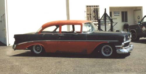

    yeah...I built it in such a fashion to get it as low as possible...with stock suspension height and a good scrub radius.
    The one that was a son of a bitch was converting a stock 58 box to a power steering box. it took almost 3 days. fun stuff too, like having to install side motor mounts, change the exhaust, 4 or 5 trips to the junkyard, and the end effect?
    it was a tiny ,itty bitty bit easier to turn.

    Thanks for posting this up, finally we got it in picture format. After the many many discussions. The one I did was so simple, and went so fast, but it was before I had a digicam.
    Squirel is absolutely right about moving the wheelbase out at least 1/2 if not a full inch to more center the wheel in the wheel opening of the '55-59 trucks. Otherwise the wheel looks to far back in the opening. Don't ask how I know.

    Question regarding the clip installation. You did not mention maintaining proper caster adjustment for the clip. Was the frame leveled and the clip leveled on the crossmember? I clipped my "57 years ago and have always questioned whether I did it right in regards allowing enough caster adjustment. Thanks

    probably depends on how the back of the truck sits, eh? if the truck is level, caster should be at stock setting if you put the clip parallel to the frame. If the back end is up, so the truck is raked, then caster will be less.

    precisely. the beautiful thing about it is, when the ass comes down so the drop matches, the caster (on the previous 3 jobs anyhow) has been stellar.- but I also try to void much "rake" at all- I like them to sit really level. I figure if you wanted to, you could make *minor* adjustments to the pitch of the clip- but I would rather see someone make the adjustments to the "stock" camaor measurments instead- they have an incredibly large range of adjustability, and even if you manage to dial in extreme rake, they have an entire host of parts to make the caster and camber angles right. but it really should not be neccecary, they have something like + or- 5 degrees from "center" which is actually about 3 degrees of caster to begin with.
    8 degrees, with i.f.s would be HARD to turn .
