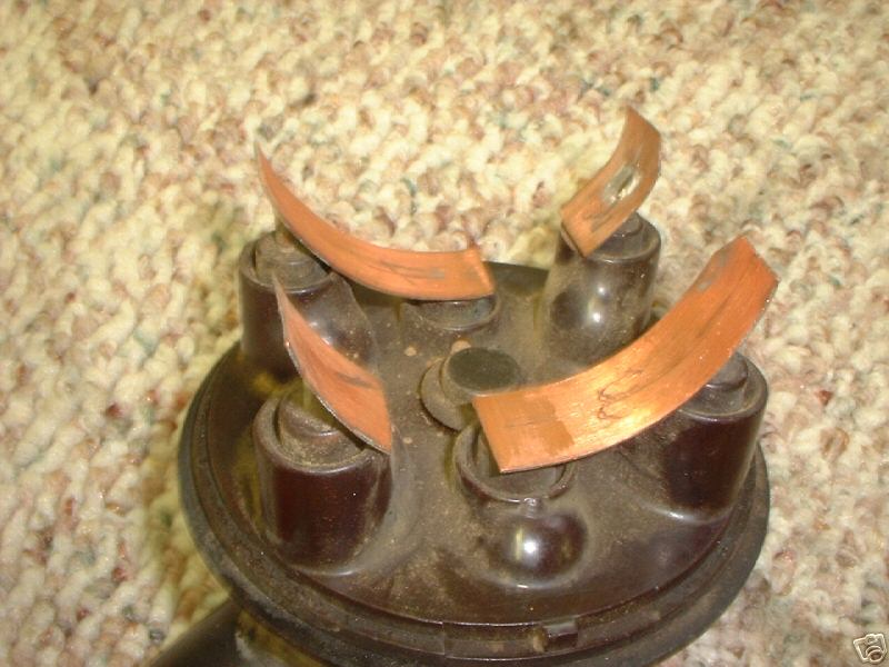

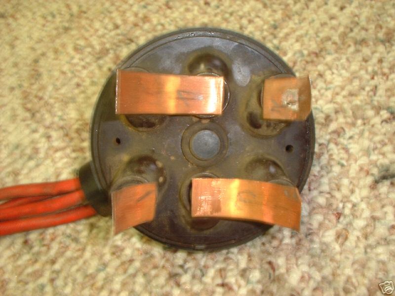

    This it what makes it work :

    "This it what makes it work :"
    Ah! Now I see! it's a WHITE box, the predecessor to BLACK box technology!
  7. Bruce Lancaster
    Joined: Oct 9, 2001
    Posts: 21,681
    Bruce Lancaster
    Sorry--now there's a pic! :)
    Anyhow, that's the tech I don't like...I have a different one done with slits cut into the rotor tips 90 degrees to axial taking curved strips of brass--just looks sturdier and more manufactured tham the Moon way.

    :( Sorry if the pix did not come up ... I did what I usally do when I post pix .......:confused:
    Klaz
  9. Bruce Lancaster
    Joined: Oct 9, 2001
    Posts: 21,681
    Bruce Lancaster
    Picture came up the SECOND time I looked...some sort of time warp. Color pics use slower electrons, I believe...and they have to get through those magnetic anamolies over Greenland to get here. Or maybe your server sent them the long way around and those Chinese internet filters were a bit clogged...
