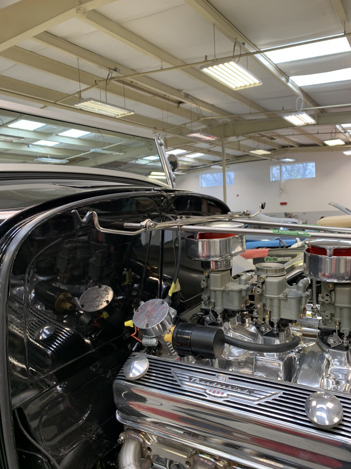

    Really happy with the work on mine, they do work on the y blocks that Prestige Thunderbird sends over to them so I felt comfortable they knew that engine, they know what they’re doing here! BDBCD661-60C9-4C5D-B3CB-92CEE4508E48.jpeg B8220304-B0E5-4550-B029-0B669837E96E.jpeg

    Wow looks nice !! Can you tell me specs and how
    Much they charged ??

    Where did ya get that Fenton intake ??

    Call and they will walk you through everything you want to know, every engine will be different depending on what you want and what you have to start with,292 or 312 or 292 with a 312 crank stroker?
    Good luck keep me posted!

    E bay is my best friend

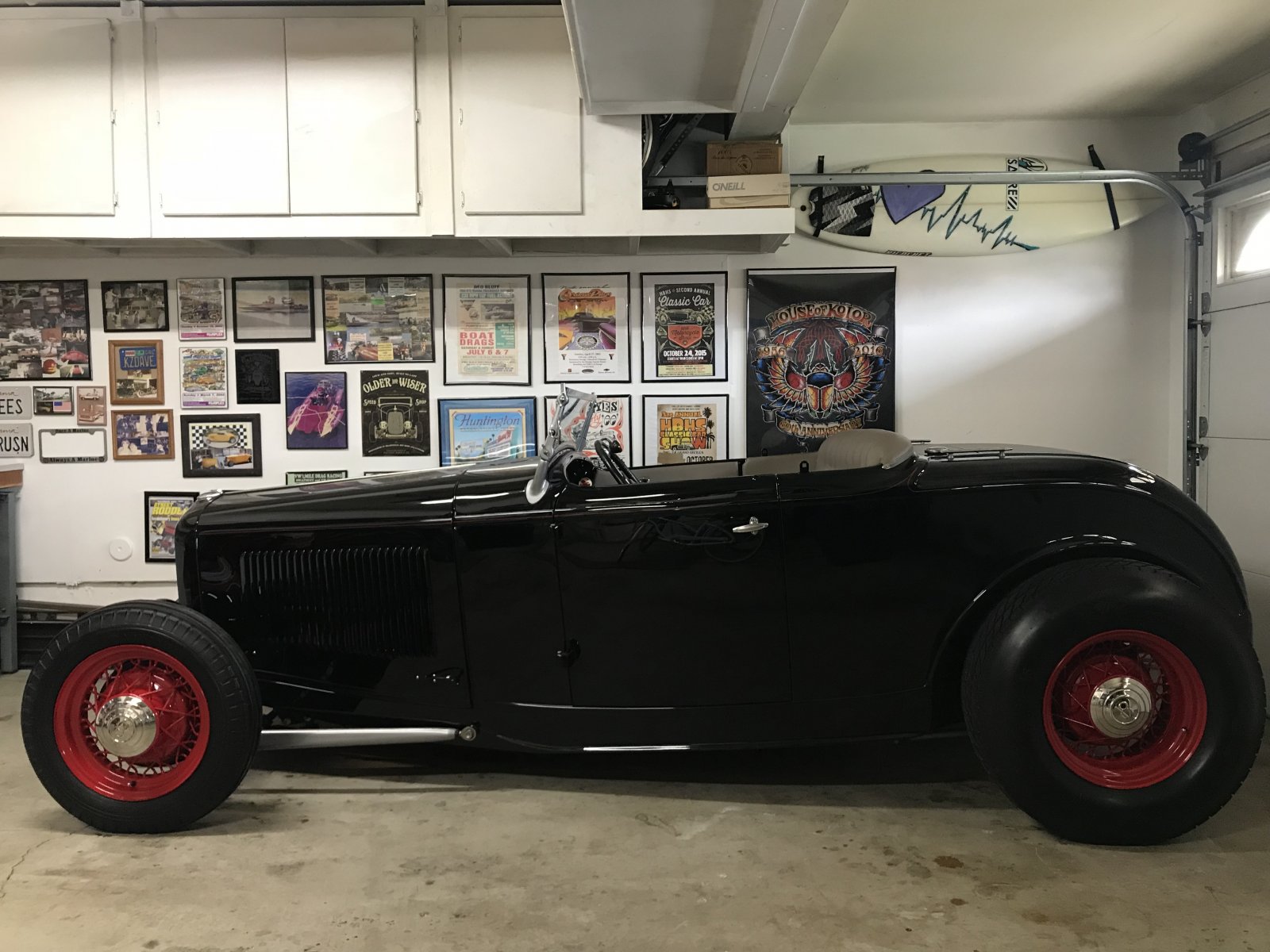

    312 56 thunderbird , if horsepower is a requirement there are better engines, but none cooler!

    No I agree , just wondering what your getting out of it ? Are those Mumford heads ??

    John Mummert Machine
    Heads, valley pan, thermostat housing and alternator bracket. I’m addicted to cast aluminum and there’s no hope!

    Maybe 300 hp but it’s going to sound like a million! F15F5236-469C-422C-B5A2-474FFAF31B16.jpeg A1600962-8F92-4586-9C03-81DE65DA0263.jpeg 0F2A9D74-7F83-4399-9808-35AE376018FE.jpeg

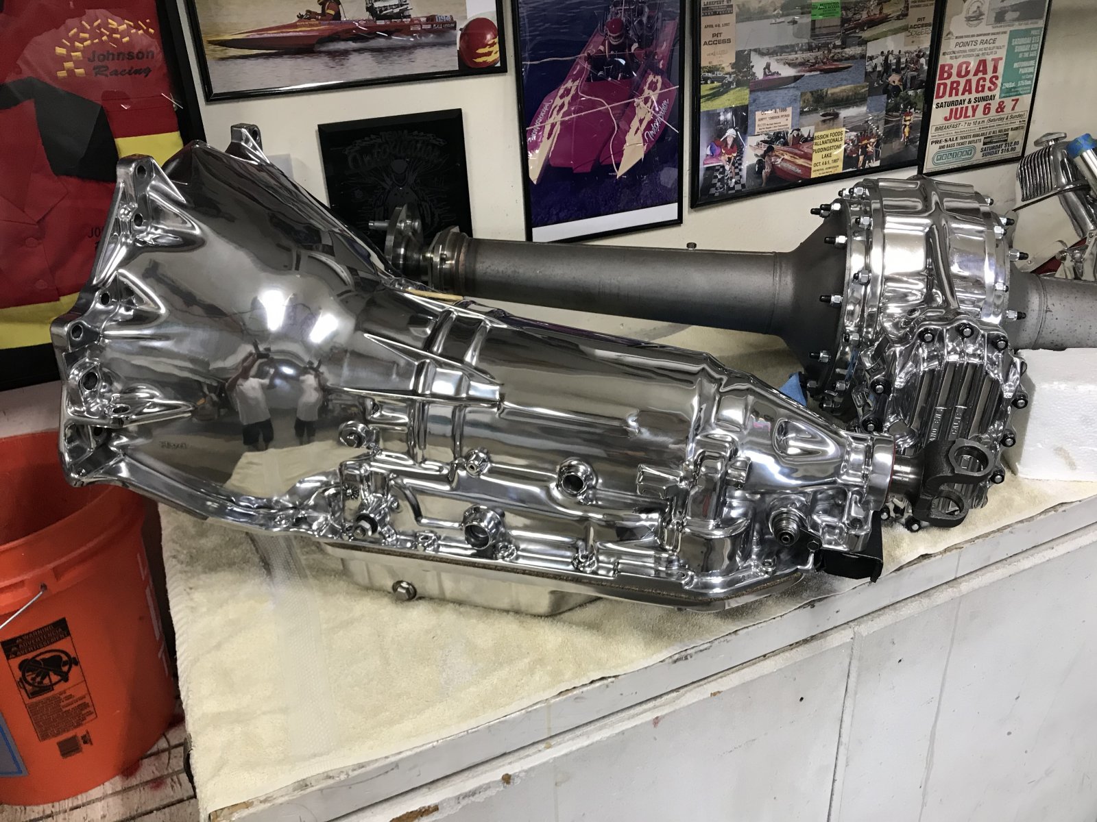

    C42E9EF2-7FF5-4692-820C-218515B18469.jpeg 172F2447-72D5-4669-8E4F-A72EFEDDC2FD.jpeg Every frame is different, mine was stretched 3” pinched and rails reworked to get the car lower, you’re starting new, I had a SBC and a 350 turbo to take out and matching the existing frame mounts to new engine and transmission 2004r sorry but it is the smallest od and direct replacement for the one coming out. The 3” stretch helped but the pinched nose made it a little harder for the sides, used every 1/4” C42E9EF2-7FF5-4692-820C-218515B18469.jpeg
