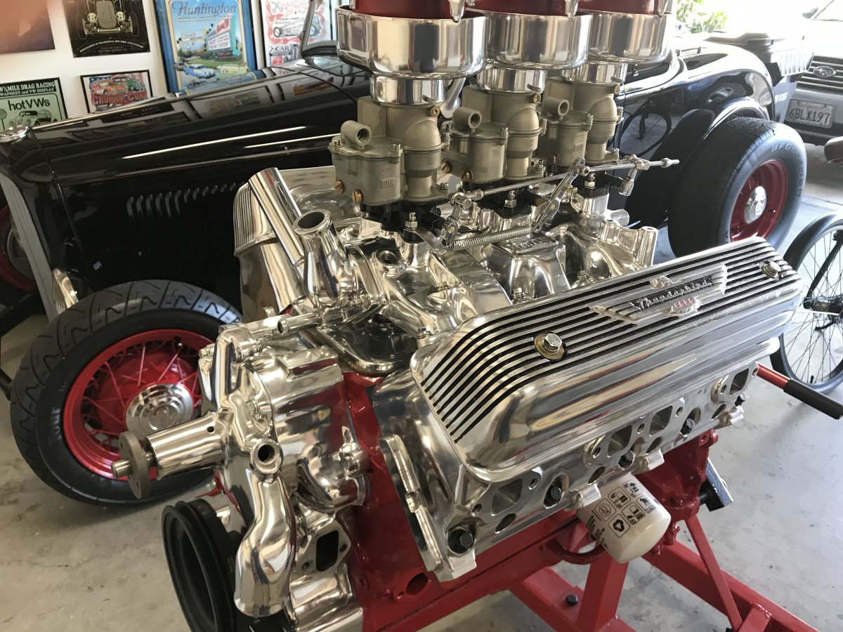

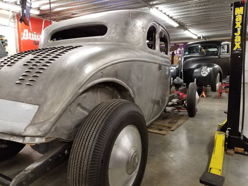

    Hello. Looking for info/advice on this winter's project. Removing the sbc and replacing it with a 312 y block out of a 57 t bird with the fordamatic. First question is about what radiator to use. Any info will be greatly appreciated.[​IMG][​IMG]

    Fabian Valdez (Vintage Hammer Garage) built this 34. The motor was mounted to a World Class T5 trani out of a 5.0 Mustang (87 to 93). The radiator was sectioned and so was the 34 grill. He did a very good job on that aspect of the car.

    Just be advised you will have to scoot your firewall back for that engine. Good luck. Nice 33.

    Have sold [4 or 5] '35-'36 ford truck firewalls as they look like and fit in '33-'34 cars but give about 4" more engine room... '37 to '39 trucks had a built in battery box... pic.

    I' m just restoring the 34 Guy posted in post #3, Fabian did do a great job adapting this 312 to a T5 trans, but the frame is a 32 so the wheelbase is even shorter . I bet Fabian was quite busy shoehorning that big lump of Iron into this small car.... Good to see a Y in another 33/34 Ford!
