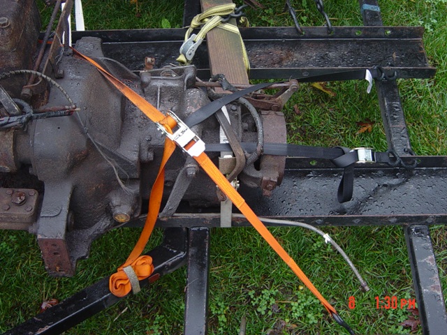

    BTW the motor I am thinking about is a MoPar flathead six, maybe 90 hp on a good day, with the motor/tranny stressed. I have a unit from a pick-up that has rear motor mounts right at the sides of the bellhousing, perfect for mounting to flat plates that in turn could be fastened to the sides of the wooden frame rails. Early Ford front and banjo axles and probably using the stock Ford buggy-spring layout without splitting the wishbones.
    Picture of the bellhousing:
