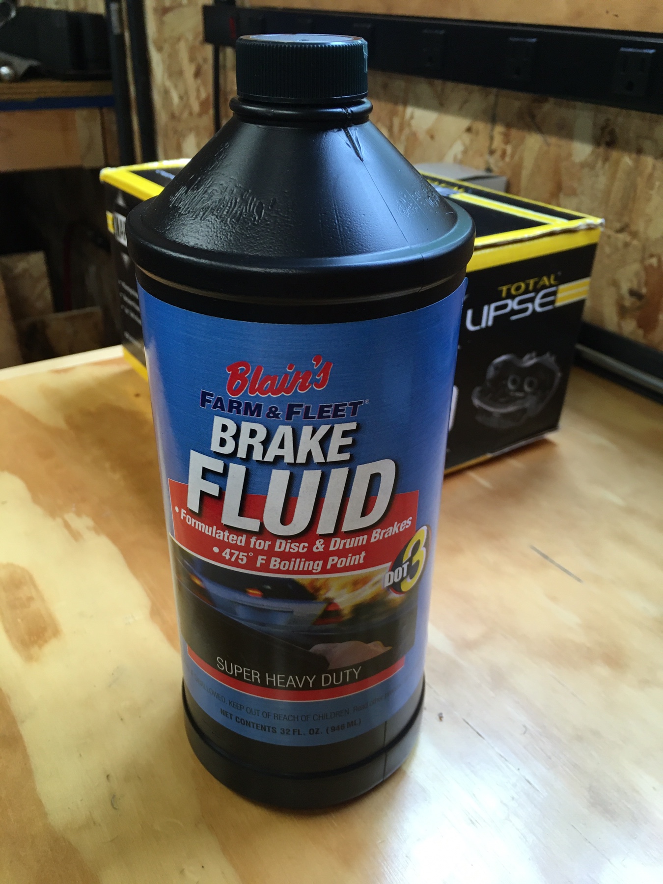

    Going to do battle with some of that super smart brake fluid today.
    Driver side caliper started sticking, so its coming off.
    While I’m at it, the master cylinder needs to come off so I can get the pushrod set correctly. Right now, a couple of washers between the master and its mounting surface are providing clearance.
    Hoping the brake fluid doesn’t outsmart me.

    I haven’t t yet been outsmarted by the brake fluid. It’s still safely stored in its bottle, where it’s going to stay for a while yet.
