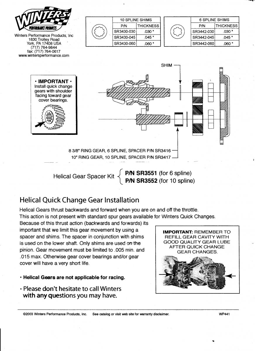

    I switched to helical gears in my winters V8 quickchange and it's as quiet as a 9", what a difference!
    If you switch be sure to get a spacer and shim kit with your new gears.
    Straight cut gears are self centering, helical gears have side loads and require shims Winters=spacer002.jpg

    All of the above is correct. I have found that later straight cut gears tend to be quieter than older ones. Also, there are better (more expensive) gears.
    But helicals are quieter than good straight cuts. Limiting the end play is critical. I made splined spacers from old drive shaft couplers before Winters came out with the spacers. If you do it this way, you can set it exactly where you want it.
