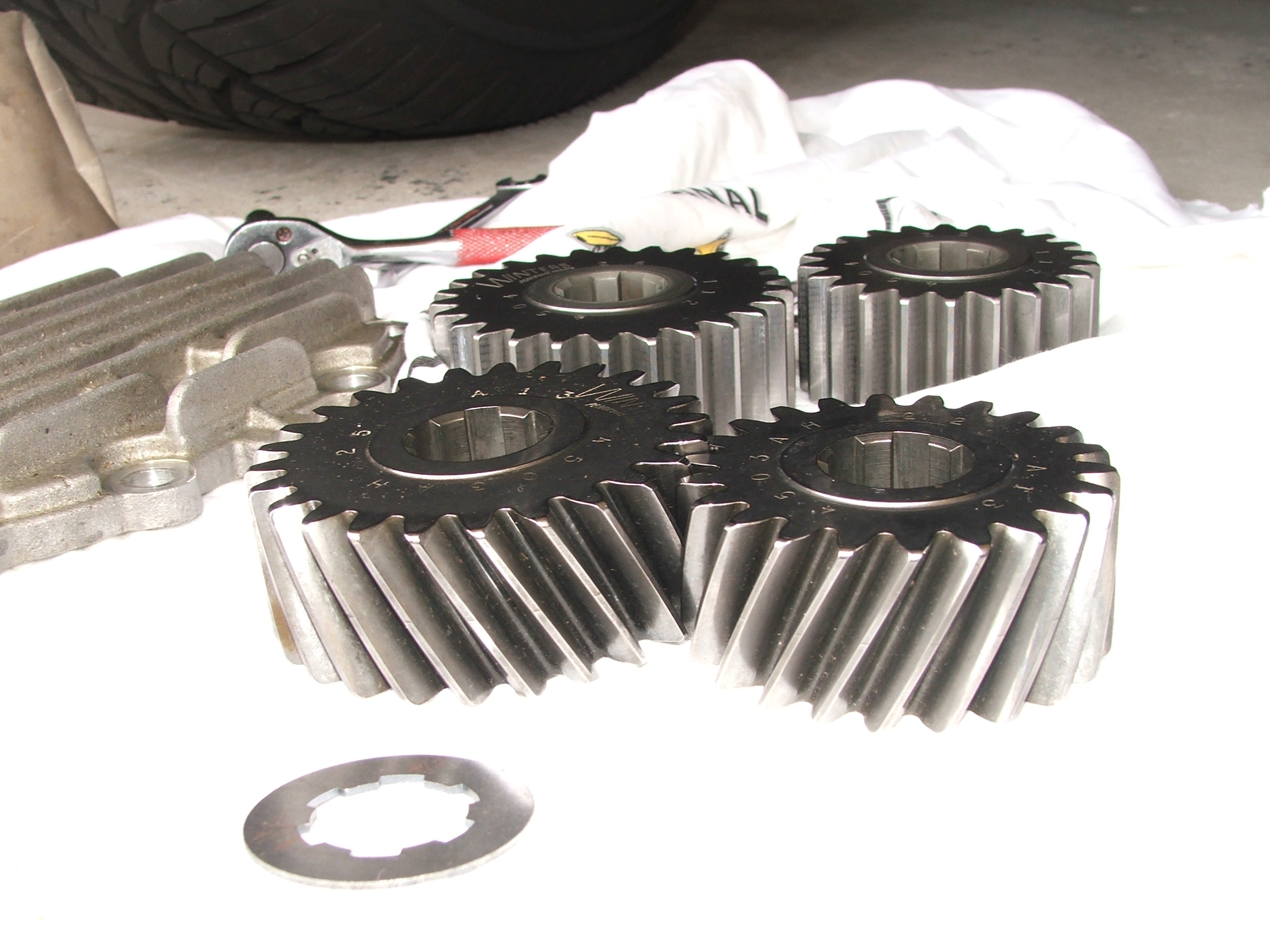

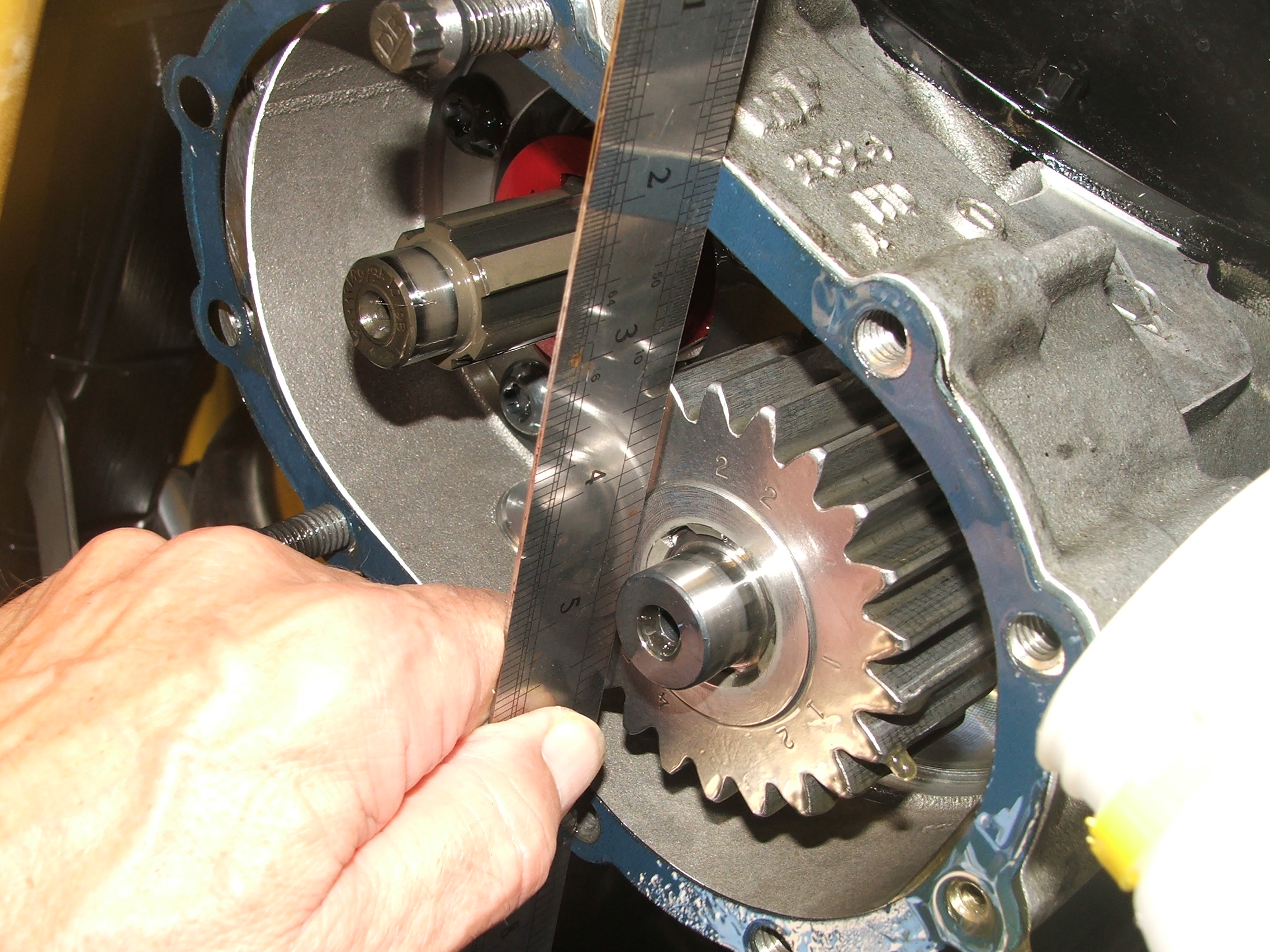

    Winters QC Gears 007.JPG This is how to install the helical cut quiet gears in a V8 QC . You must check the end play from the shoulder of the gears with a straight edge across the housing with the gasket in place . It will be from 0.020 to 0.080 , order the correct shims from your supplier with the gears . You must not have too much gap as the gear will hit the bearings each time you accelerate otherwise . If you don't want the noise this is the way to go .. Ford11 002.JPG

  8. What should the end play be after the shims are installed?
  9. Badrodder
    Joined: Aug 27, 2011
    Posts: 51
    Badrodder
    I was told 0.015 in. Max ,but you are limited by the thickness of the spacers Winters sells . They are on the winters site on the page with the helical gears . I think they come in 15,30 and 60 thou, you would have to double check though .

    Do you install the shims on the non-thrust side of each gear (the side of the gear that bears the thrust in the forward transmission gears, as it would change in reverse)?
  21. Badrodder
    Posts: 51
    Badrodder
    I installed shims on both shafts fwd of both gears to keep 0.010 gap .

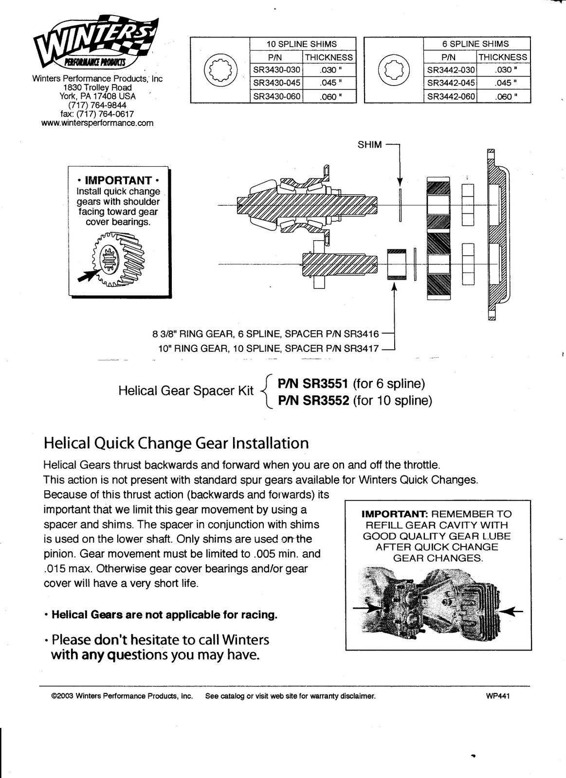

    Desoto291Hemi likes this.
  24. sdluck
    Joined: Sep 19, 2006
    Posts: 3,193
    sdluck
    Thanks I have all that info,but a my frankland is different,it is like the picture on the right.[​IMG]

    Winters has made them both ways, as shown here, but with no "extra capacity" spur gear housing:
    You will need the correct gasket, but it should otherwise work the same way.
