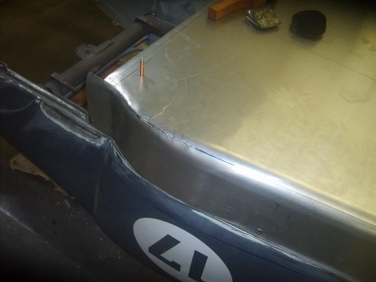

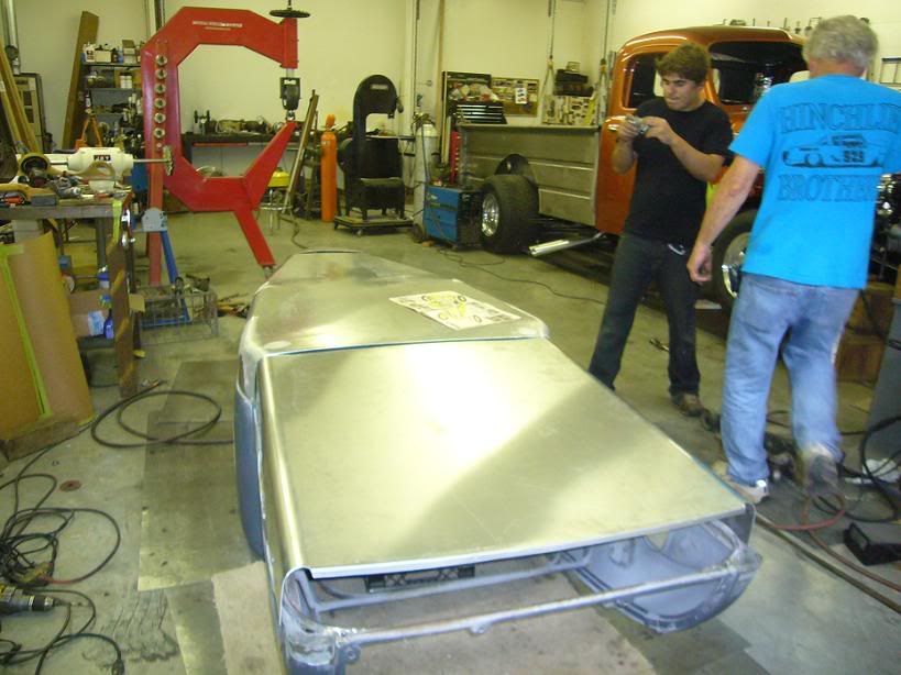

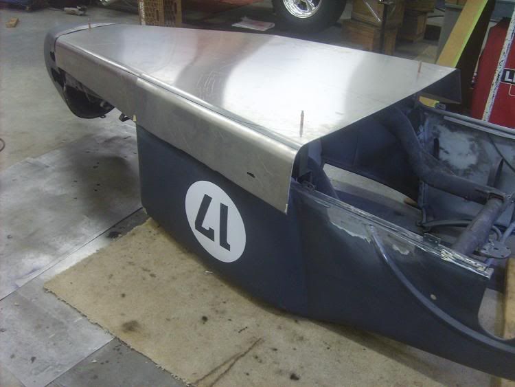

    I got a call From my good friend Ron Yeager Owner of Ron's Rods In Kingsville MD, to come work on Frank Morawski's Track T, This car needed a belly Pan Hood and Hood sides before it goes to Pebble Beach. Great opportunity to work with Ron and frank on such a cool project. It ran 180 In 1952 on the flats.

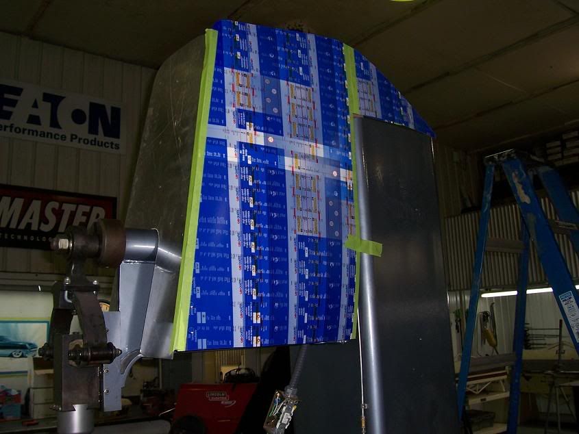

    Which is pretty interesting b/c i talked to ron covell, lazze and clay cook about this part before starting it and they all said to do it like the picture below. which is what im doing. start @ 1 and work your way out, then to 2 and so on. some say to work the panel flat and then add the shape then some say to add the shape and then the form. either way its a pain to wheel with a lot of shape in the corners so i opted to do it is 6 pieces instead of 2 or 1. it took me about 3-4 hrs to make the top and then 2 for the sides. does your top have a reverse throughout the whole thing or just the corners?
    thanks for the input i love to learn new methods- also check out fay butler's pullmax book on his edge beading dies- it similar to yours but this can be modified for a wire edge, double beads, etc
    turn the flange and then use that as the guide- these fit in the universal die holder perfect

    pretty interesting approach on not wheeling up the entire sheet- the 27 cowl im doing is more a 1 sided reverse and is flat by the firewall so i started all on the one side and worked my way back. have to try doing it your way to see if its any faster
    this is what the profile looks like
    did you add the shape around the corners before or after you started working on the reverse? this intrigues me b/c to be able to make the panel with no welds would be a huge time saver
